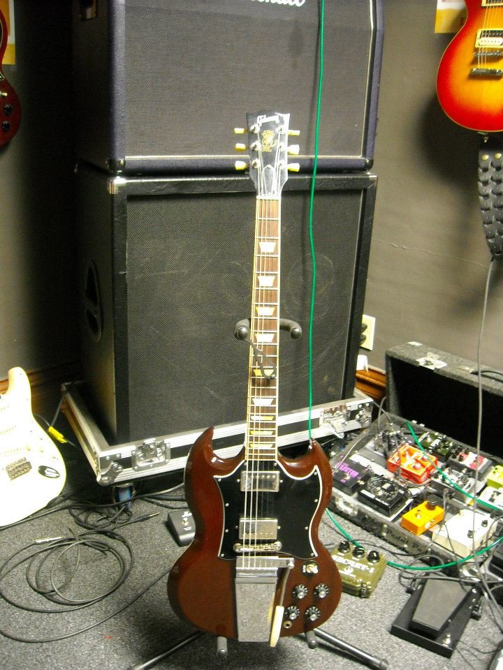

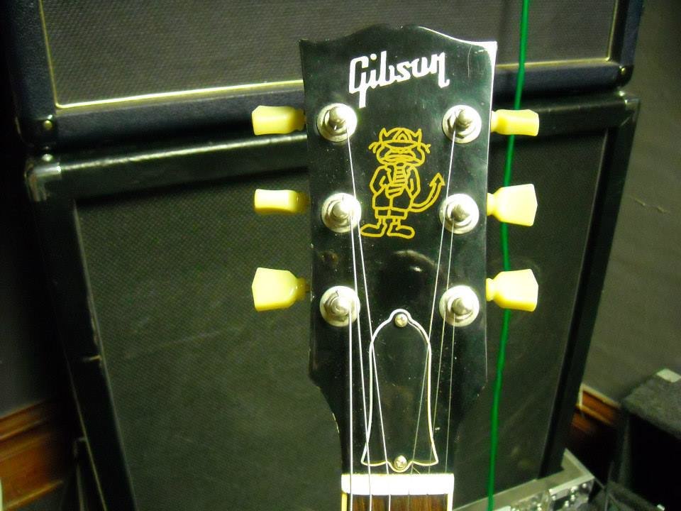

    I did a headstock repair on this Angus SG, straight as an arrow and Jimmy Page wiring/ pickups on the Yamaha Lord Player. The first guitar I ever modded was also an Epiphone SG.

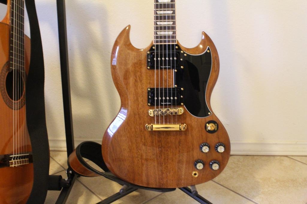

    Time for an update as things have come together (and changed substantially). After ordering all the parts, the price climbed to the point where I began to wonder if it was really worth it to install all this nice stuff on a guitar that might be worth $175 on a good day. As luck would have it, I found a 2014 120th Anniversary Edition Gibson SG Standard body and neck for sale. So, all the new stuff went on that and the Epi got put back together with the stock parts.
    The walnut color of the SG looks really nice with the gold hardware I used. All the electronics were custom built by Brown's Custom Shop (highly recommended). Everything else was either factory Gibson parts or Gotoh parts, which are made in Japan and very high quality. The pickups are Seymour Duncan P-Rails with the Triple Shot mounting rings. You can split the coils on these to get humbucker, single coil, or P-90 sounds from them with switches hidden in the mounting rings. After some minor issues with parts not fitting (metric stuff doesn't fit USA Gibsons) and some careful soldering, its in playing condition. I finished the setup yesterday and it plays great. I'm just waiting on the pickguard and tenon cover, which are being custom made by Pickguardian.
    After all that, the cost was actually way cheaper than buying a factory SG. I'm into it around $1100 total, and its much better than the stock SG that would have been at least $1500. I'll eventually have Brown's Custom Shop build an electronics kit and modify a roller bridge to fit the old Epi, too. Here it is...
