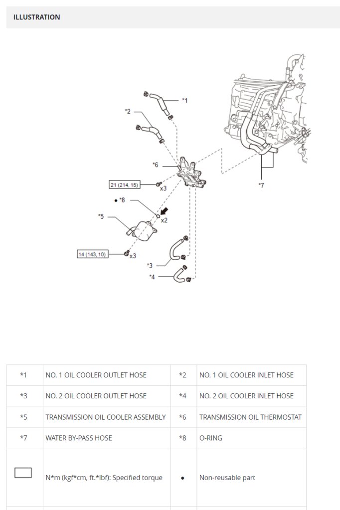

    Me and a few of the others that have actually taken this post serious. Are still needing to know what line was severed, and where the coolant was added.
    Because I’ve looked at all the diagrams, and there’s no coolant line underneath the truck where OP says.
    I think he filled the coolant reservoir up to max.
    And the transmission is low……..on ATF fluid.

    Correct, the transmission cooler line brings ATF to the secondary cooler up front. If he didnt replace that line and drain and fill ATF and do a level check..... He's toast.

    I stand corrected.
    There is a coolant line and hose down there.

    maybe i’m calling it the wrong name but as i was pouring in the radiator it was coming out of the rubber hose attached to the side of transmission.

    well i’m positive it was coolant because it was coming out as i was pouring into radiator that’s for certain what the leak was. my worry is it shut down after 7 min of driving and gave me a flashing check engine light with high trans temp warning. after i let it set for an hr or so tried to start and it turns over but sounds different than it did or should and doesn’t start after i got the sensor out i found out it wasn’t gonna be repaired. they are hard to find with it being such a new model now i’m wondering if the same sensor for same position that is for like 16-22 that looks identical will be updated to cover 23 just hasn’t happened yet. i mean parts stores literally don’t have in their system

    thanks for the actual advice. i am gonna replace sensor. my issue is with it being so new the parts houses don’t have it in their system. however the same sensor for like 16-22 is the same looking with same description. what’s the chances it just hasn’t been updated?

    It’s probably still the same and just hasn’t been updated yet.
    I don’t know of any parts that aren’t the same across the 3rd gens as long as it’s the same model. Year shouldn’t matter until you get to the 4th gen’s.
