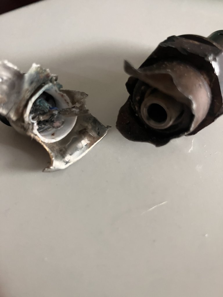

    IMG_5936.jpgthis is where the bullet hit. i have trimmed some of the metal off but it just ripped thru the top and pulled the wires out as it split it in half
    there’s no fixing this. now i’m looking for a replacement. heated bank 1 sensor 2. no one seems to have exactly what i need for 23’. however the 16-22 model sensor looks like same. i’m wondering if the fitment just has not been updated. all part stores locally don’t have anything in system for 23 which leads me to think that i may be able to pick up a 22 yr model and replace with it but i dont know which is obvious by now i suppose and is the reason im here.

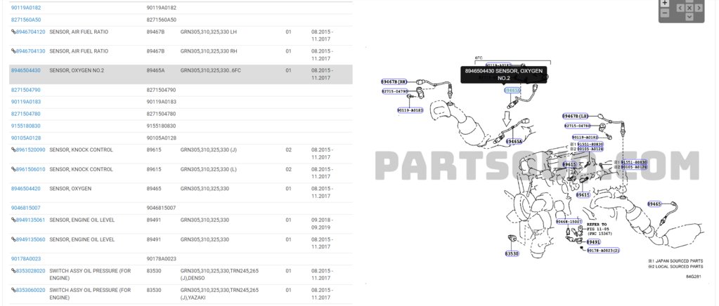

    My source gives the part numbers for the 2023.
    I added the link below.
    When you type the part number into Google, the results say it fits 2016-2023.
    https://partsouq.com/en/catalog/gen...XJtdmNkcwAAAAABTUaD$&vid=0&cid=&uid=345700&q=
