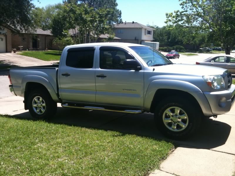

    as acquired (April 2010):
    I think the previous owner probably used it as a work truck. The interior was thrashed and it smelled like holy hell. I got a good deal, though, and it was nothing a little work couldn't correct.

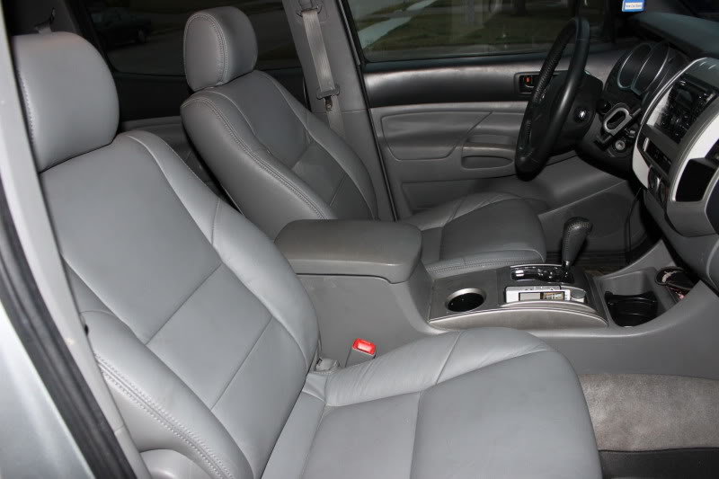

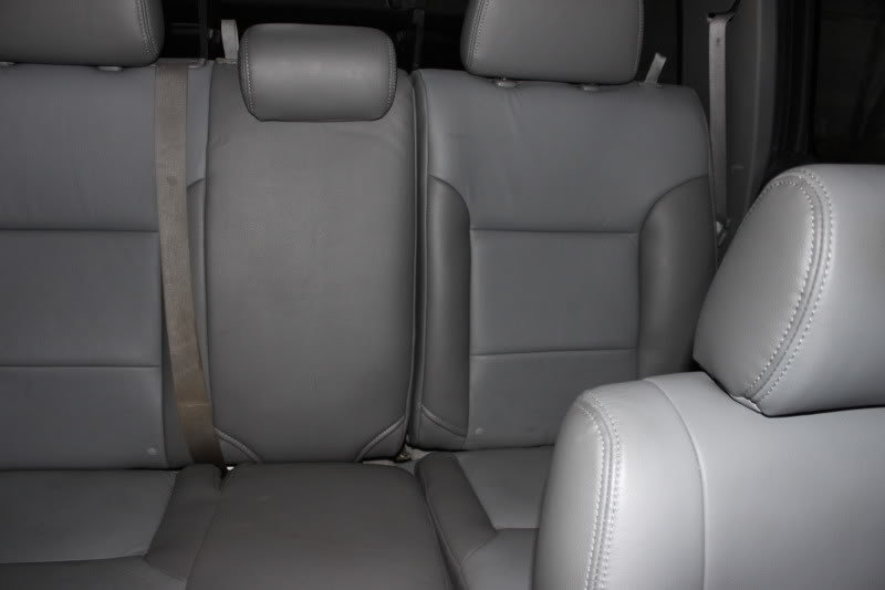

    leather interior - light grey (installed by yours truly)

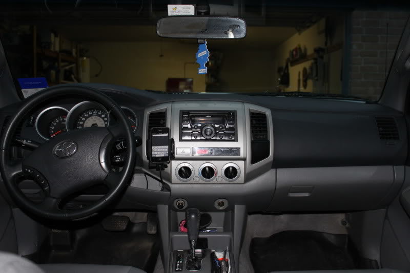

    Clarion CX609 (DDIN w/ Bluetooth, Sirius, IPod/IPhone control, and SWI-Jack… and lots of ugly)

    I wish I had a picture of the original seat skins before I tore them out. They were beyond saving. The leather made such a massive difference for the better. Pictures do not do it justice.

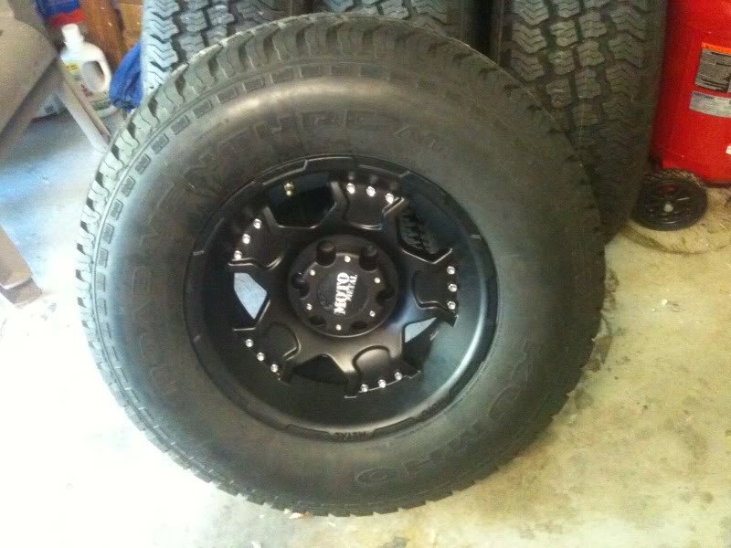

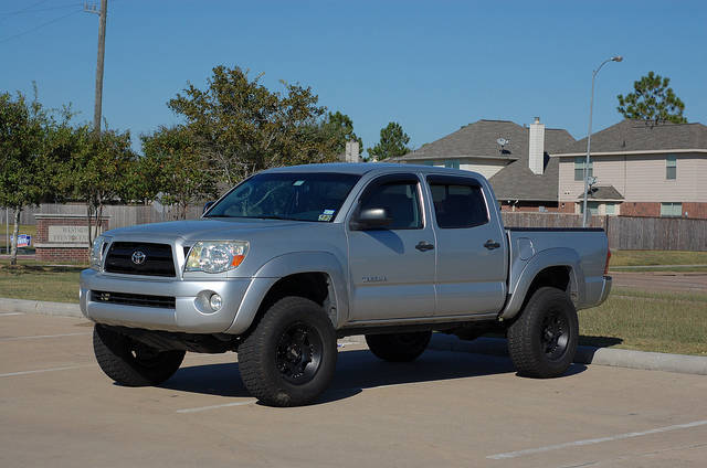

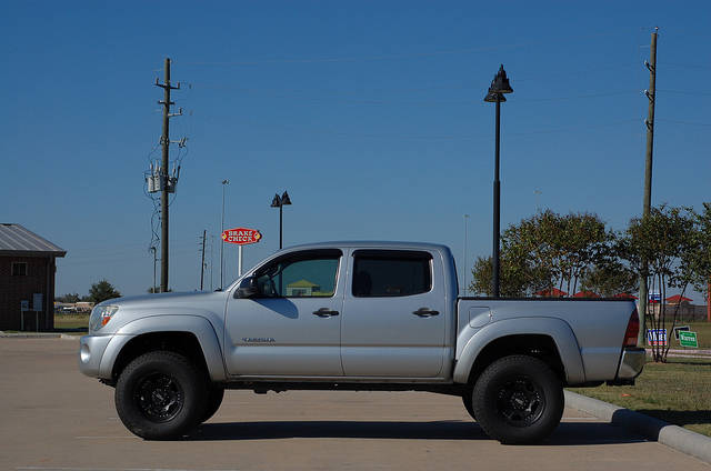

    Moto Metal 957 - 17x9" & Kumho KL78 285/70-17:
    (went with Kumho because they are relatively lighter-weight, street friendly tread pattern, and PRICE… I like them a lot so far)

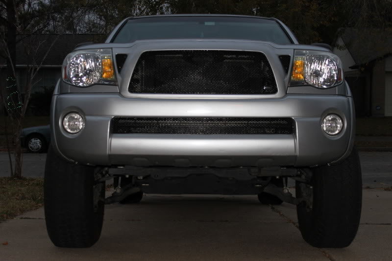

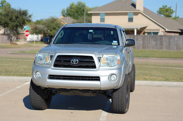

    - color matched grille (needs a respray, but does the trick for time being)

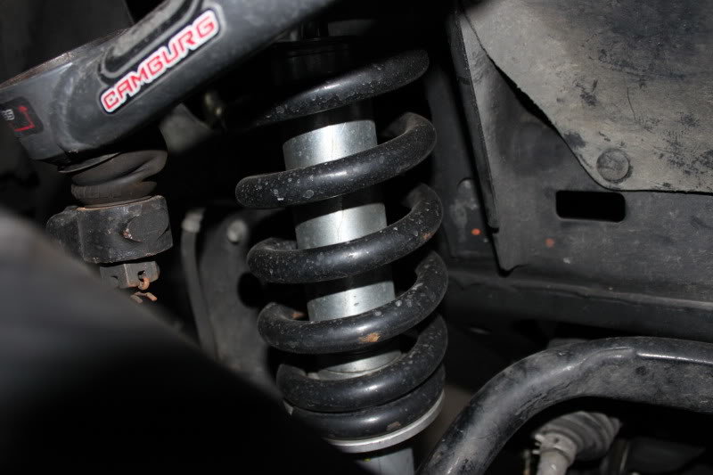

    - Bilstein 5100
    - OME 885
    - Wheelers 3-leaf add-a-leaf (1.5" lift)

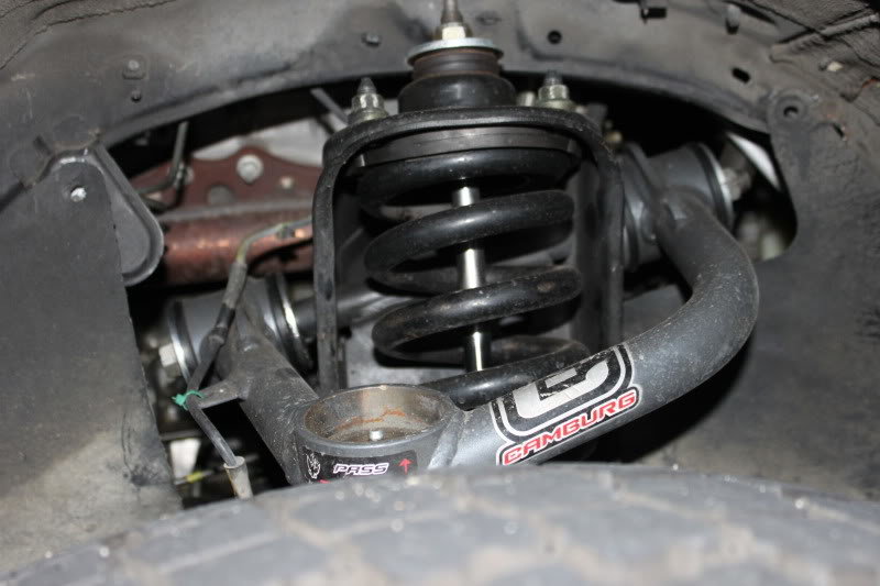

    - Camburg Ball Joint UCAs
    Came out like this:

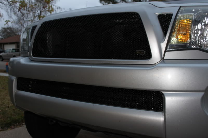

    Got Grillcraft Upper, Lower and Triangles for xmas.

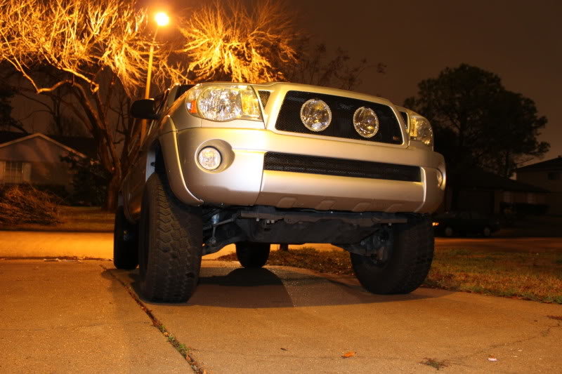

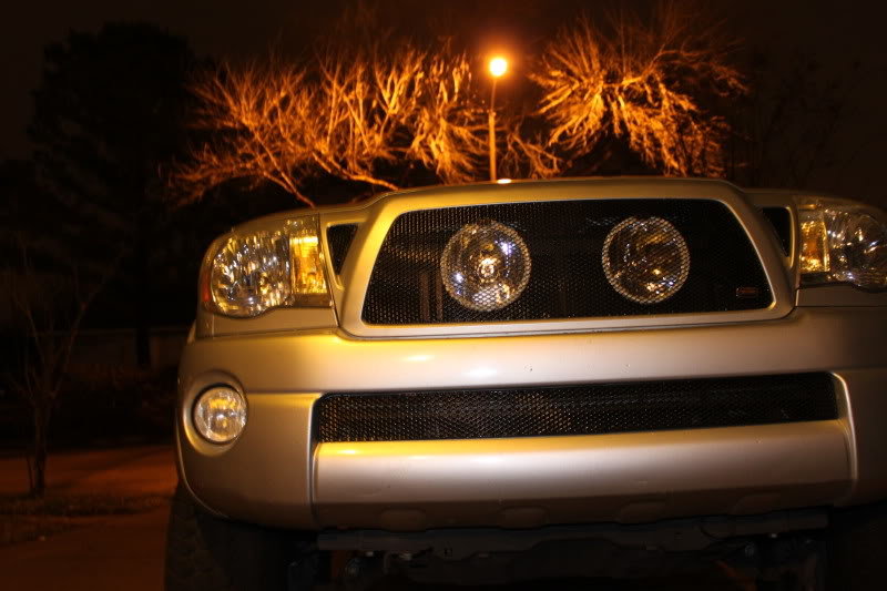

    Update 1/16/11: Hella 700ff lights behind grillcraft. Got them mounted w/in 1/2" of the grille. Smoked/BHLM headlights coming tomorrow.

    Do you have your Billys set at 0? Great looking truck bud. Thanks for any input, I'm gonna be running a similar lift set up here soon...thats why I was inquiring :) My spacer lift has to go. I already have the Billy 5100s for the front, now I just have to buy some for the rear and get a 2" AAL from Toytec and the OME 885s lol!

    Yeah... Billies at zero. No top plates. I did change out to the longer top plate studs on the driver's side, just in case I do encounter some lean at some point. That way I don't have to dissassemble the struts if I want to add the spacer. So far I haven't seen any sign of taco lean that needs to be corrected. From what I've read, the newer OME springs (i.e. 885x) have been "scragged", so they are less prone to sagging over time.
    On the rear springs, I left the overload leaf in the spring pack below the add-a-leaf (the AAL pack is designed to replace the overload leaf) My original springs appeared to be sagging quite a bit, and the overload leaf basically acts like an extra .5" spacer below the spring. Even WITH the overload spring, it still looks a little nose-high to me. Not that I'm complaining... I like the stance as is.

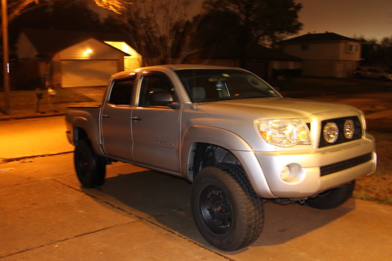

    Added a couple of Hella 700ff (8") last night. I used Klipp11's method, but had to add 2" tabs with a 1" spacer/riser off the crossbar in order to get the 700's to center up and mount flush with the grillcraft. So far so good.
