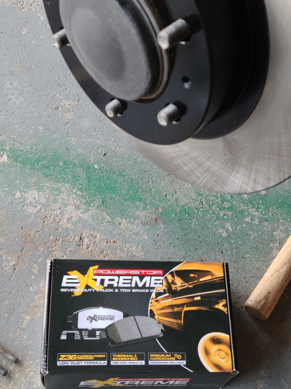

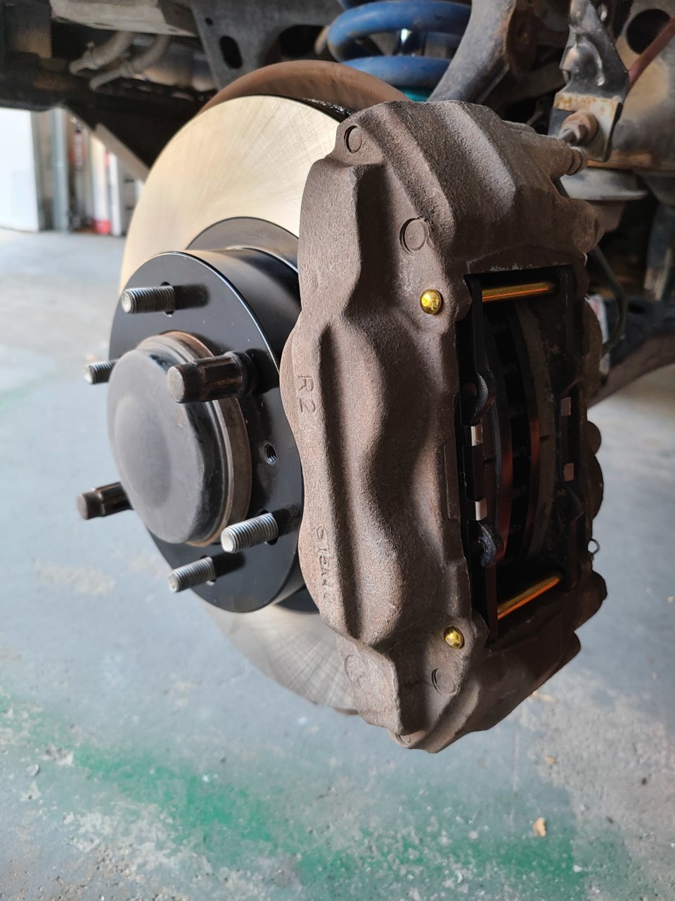

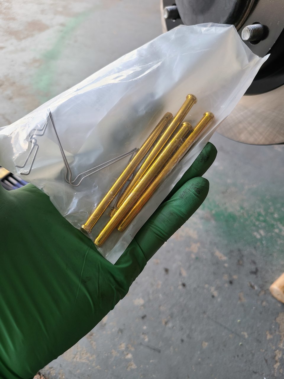

    Carbon ceramic brake pads. Basically a race truck now. Even comes with them gold Johnnie's :cool:

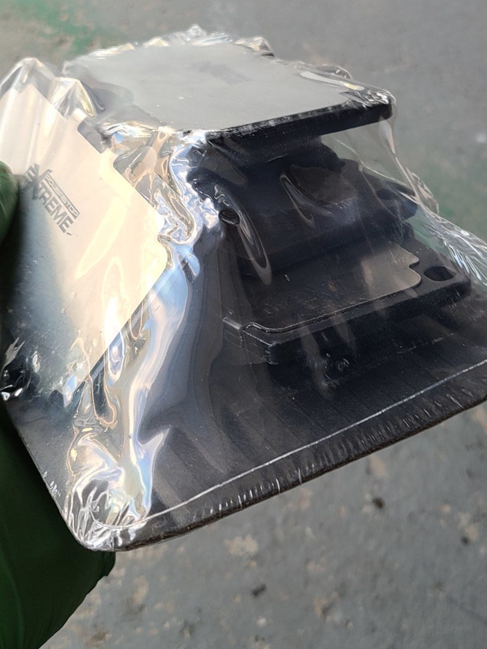

    Note for next time, the Power stop Z36 pads come in 4 packs. Rock Auto didn't list them so I assumed it was the normal one side per box. I guess I have extras now.

    Best part of living on a straight road that gets quiet after 8: You can drive like a jackass and actually follow the bed-in procedure of five 40-10 hard stops and five 35-5 medium stops.
    Most importantly, the rotor warp got fixed. It was seriously bad getting off the freeway going to work. The thing stops with so much more authority now too.
