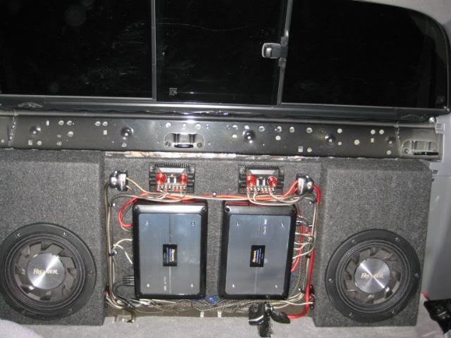

    Yep, I'd look to Marv for a box. I'm thinking that the 13" shallow mount JL sub would probably be a good option, just for shear cone area. A couple of 10's could also do the trick, but you might need to get creative on where the amp will fit.

    x3 on Mr. Marv.
    And you don't have to get too creative with 2 10s... :)

    From what I've heard, you're not gonna be able to fit a 12" in a Tacoma without major modification to the rear seats to move them forward.

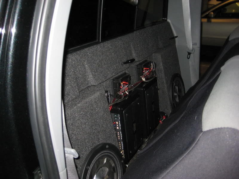

    There is a brace across the rear wall of the cabin that will not allow most 12" subs to fit behind the seat without some major modifications. I can fit certain shallow 12's as well as the 13TW5 and in any case no matter what gear you choose, proper installation is going to play a major role in how it sounds! :)

    if it were me i would find out what the max airspace is using the entire width behind the back seat. if you can get 1-1.1 cubic feet i would run a ported 10. if you can get about 1.5 cu ft i would run a thin mounted 12 or the 13 marv suggested. you IMO i can easily get the bass of 2 10's that plays louder and lower with a single ported 10 verses 2 sealed 10's in the same box. i would mount that 10 in the middle and an amp on 1 side of the box or mount the 10 on 1 side and the amp on the other.
