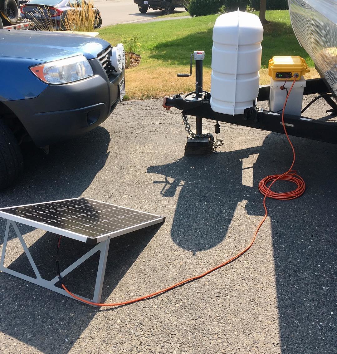

    I bought a 90w Coleman kit last summer and built it into a small Peli case;
    Added and extension, a few meters, and hardwired it into the RV - it can still be used with the alligator clips as well.

    How did you mount the panels? Those look like the "flexible" panels I've been looking at recently. How do they perform?
