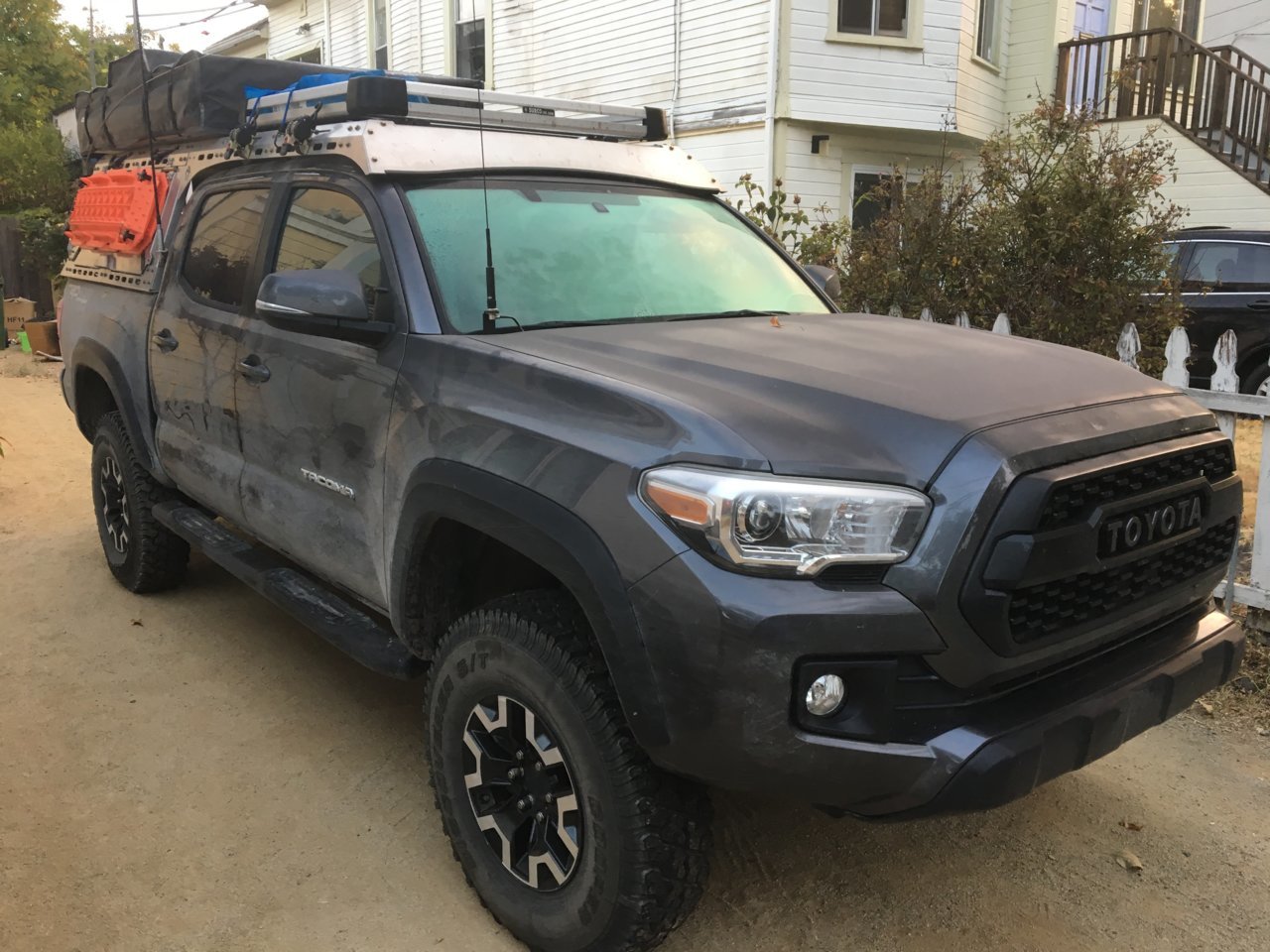

    EXTERIOR: Toytec Boss 2.0 Dakar CS047R Leaf Springs Tailpipe chopped Pelfreybilt Front full hoop front bumper w/ Pelfrey fairlead Pelfreybilt Rear standard bumper Pelfreybilt Aluminum IFS, Mid, Rear (exhaust reroute) & Gas tank skids Pelfreybilt Fuseplate w/ 12 circuit fuse block All-Pro Apex Sliders ProComp 7036 17"x9" -6 offset BFG 275/70R/17 KO2's Warn VR10000-S winch Baja Designs S8 light bar & Squadron sports amber pods in front bumper Baja Designs S2 flush pods in rear bumper Baja Designs Squadron Pro amber pods on Caliraised ditch light brackets @rrentrop reflective black tailgate inserts RSI LED's for regular & high beams Prinsu Cabrac Custom Tradesman Truck Top by Access Manufacturing w/ Powertank 8"propane tank mount & Yakima tracks on the roof INTERIOR: Warrior Products door sill protectors Husky Weather Beater floor mats front & rear Coverking arid multicam seat covers in the front Midland 75-822 CB w/ 4' Firestick antenna on C4 Fabrication tailgate mount Consolevault Hondo Garage iPhone mount
    The solar is connected to a 31M battery. I have a Snomaster fridge & freezer in my back seat so the solar keeps the battery constantly charged

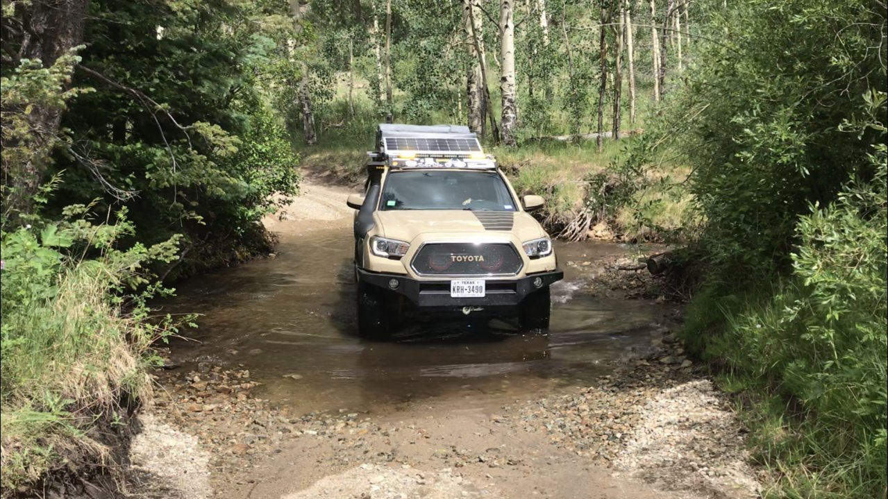

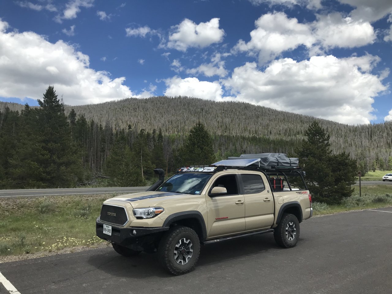

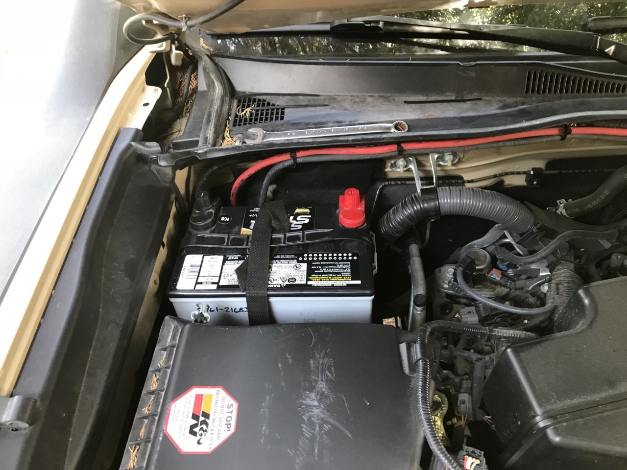

    I run a Renogy 100watt panel on my Prinsu rack full time. I am running the Renogy Wanderer charge controller connected to a 34m AGM deep cycle battery. Between the chassis battery and the auxiliary battery I run a Blue Sea ML-ACR 7622. With it I can run the batteries together or separate at my discretion. As well as have the assurance that it drops the connection between the two batteries when I shut down the engine. I am planning on replacing the ACR and the Wanderer with a RedArc DC to DC charger to keep the batteries balanced a little better.

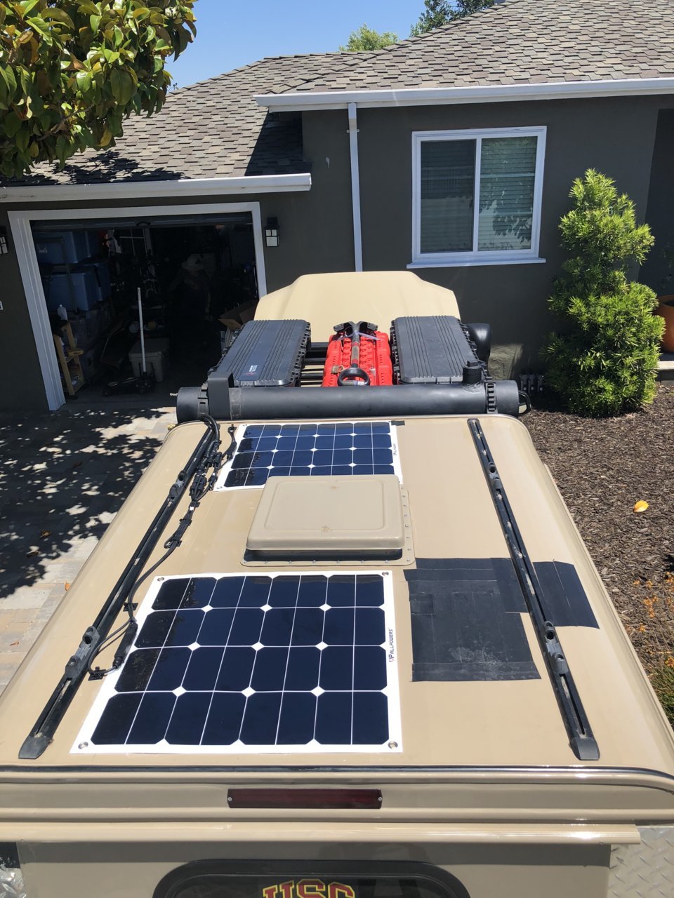

    That is my plan. I want to have the solar panel hinged so I can lock it up as a wind deflector when the RTT is mounted and lay flat when not.

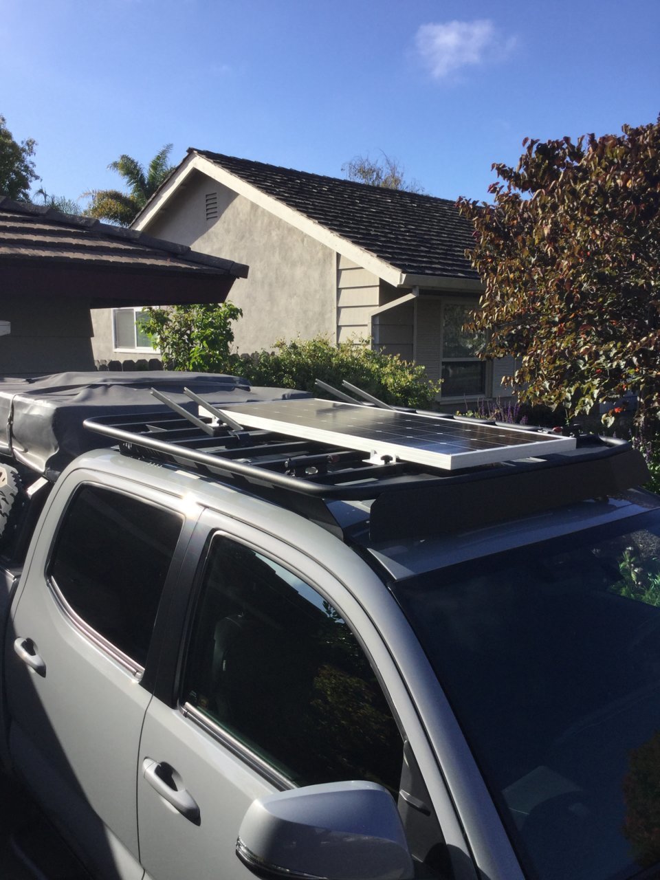

    380300A7-4804-42D8-91BB-D1A59D4482D9.jpg What are the dimensions of the panel? I need to fab up a wind deflector for my RTT and this is a great way to do that.

    This is how I have mine. You can see the hinges across the front. The rear struts have 1/4-20 carriage bolts with plastic palm nuts on them so I can with have it up or down.
    47.5” wide. The Renogy panel sits right on top of the side rails of my Prinsu. The hindges are bolted to a cross bar and riveted to the panel. The rear is mounted with the brackets supplied with the panel. You just line them up with a hole on the rack and drill and pop rivet it to the panel so that when it is flat the bolt lines up. Then make some struts that it angles it to suit your needs.
    Thanks it gets me there and keeps the wife happy.
    Edit: My panel has survived many limb and rock strikes in the last 15k miles. Even took a buzzard out with it coming across New Mexico on my way home from Colorado. No damage to date.

    Did this make any discernible mpg improvement?
  12. Sep 19, 2018 at 8:07 AM
    RedBeard1
    RedBeard1 Welder with a wheeling habit!
    Nov 9, 2015
    #169163
    2,284
    Red
    The Republic of Texas
    1985 Hilux Crawler(Pete), 2016 Quicksand TRD OR 6MT (Wombat), 2016 TRD Pro T4R
    Mostly stuff I built.
    1.5-2.5 mpg better with it up vs down. Biggest difference is when you have a head wind.

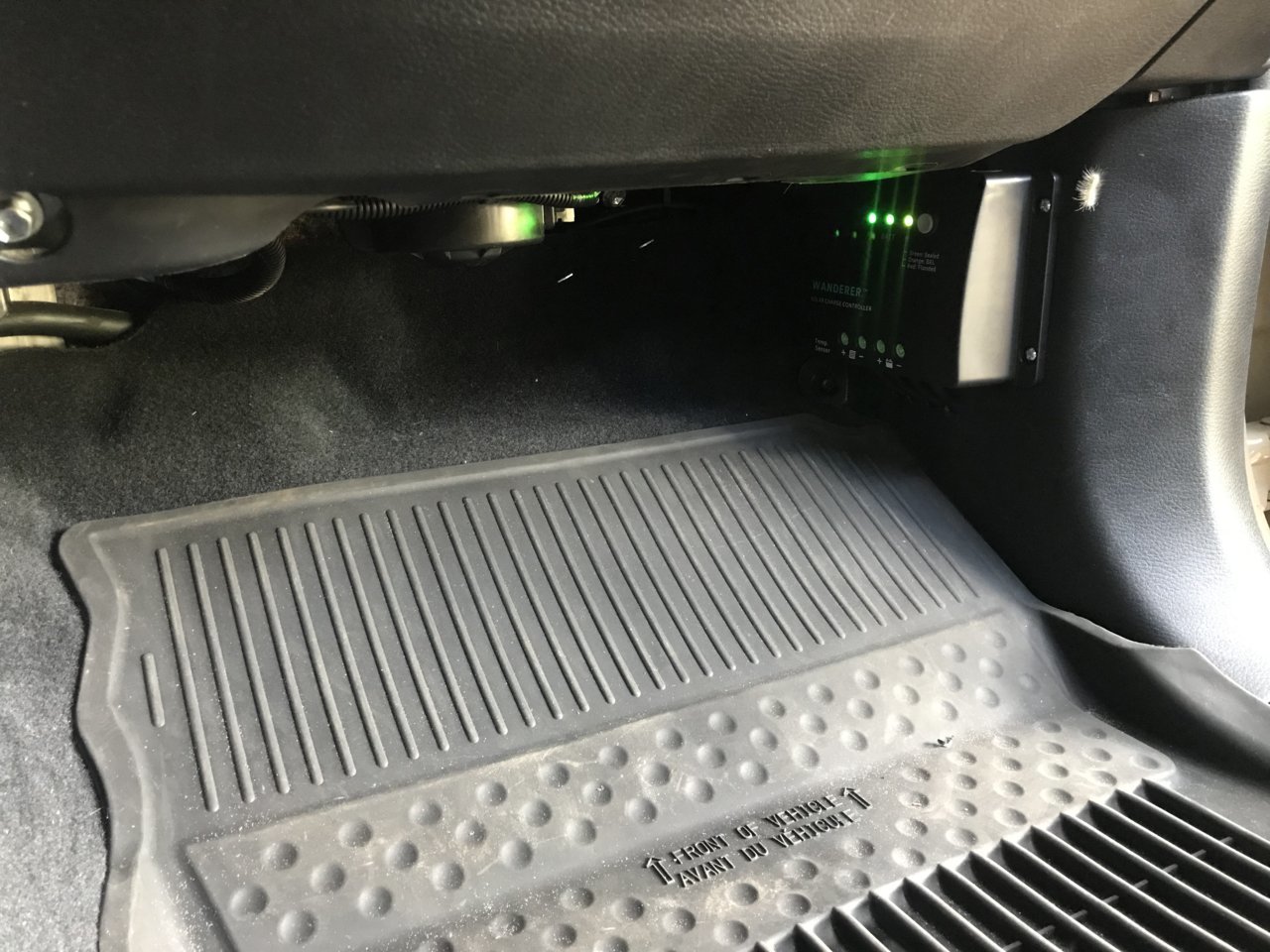

    Nice. I just ordered this:
    https://www.amazon.com/dp/B00BFCNFRM/ref=cm_sw_r_cp_api_JmNOBbEXBN32C
    Got one with damaged packaging for $161.
    Does this kit look decent overall? Is this controller any good? I saw some that displayed an actual voltage.

    just looked at this, controller is good for 6v golf cart battery, probably will need upgrade the controller at minimum
