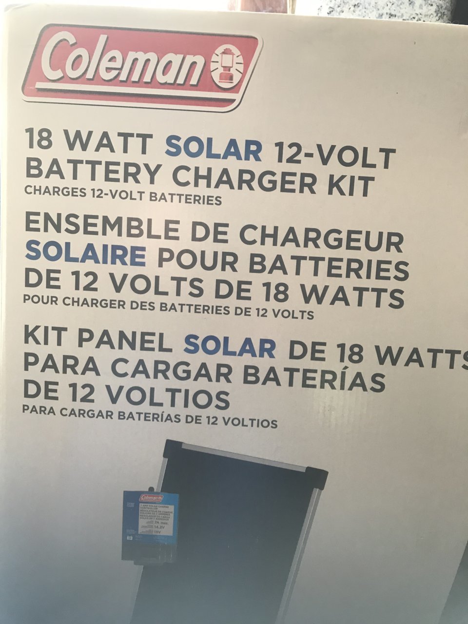

    I got this for charging the house battery in the camper. Bought it to experiment with. It kept the battery up enough to run the vent fan full time with lighting duties over a three day weekend. Monday afternoon the battery was at 1/3 charge.
    Not permanently mounted. I set it up in the sun and turned it when I thought about it throughout the day.

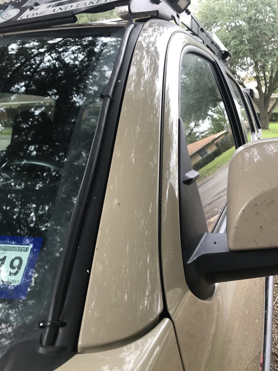

    How did you route the wires from the panel? I’m thinking I’ll route mine along the underside of my cab rack, down the back of the cab inside one of the bed rack vertical supports, inside the frame rail, then in through the floor via one of the body plugs to the controller, then back through the plug and to the battery.
    Curious though as to how you did yours...

    Sorry just saw this. Mine are run down the weather stripping on the side of the windshield. All of my charging system wiring is on the passenger side. All of the electrical control wiring for lighting is run up the driver side. Punched holes in the weather stripping and used cable ties to secure the wire to them.

    Are the wires on top of the stripping or under it?

    Easier to just show you..

    Perfect thanks!
