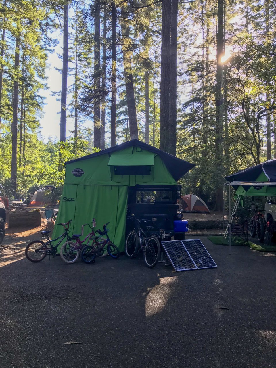

    At first I ordered a 100w Renogy to mount on my Prinsu, but ended up getting a Zamp solar suitcase instead. Reason is so that I can setup my trailer as basecamp and move the solar panels vs moving the truck/trailer towards the sun.
    Here’s a pic of the setup sans sun...

    Looks great! A little off topic but I saw that Dometic also came out with a power pack to run refrigerators as well. Not sure if it can be charged by solar though.
