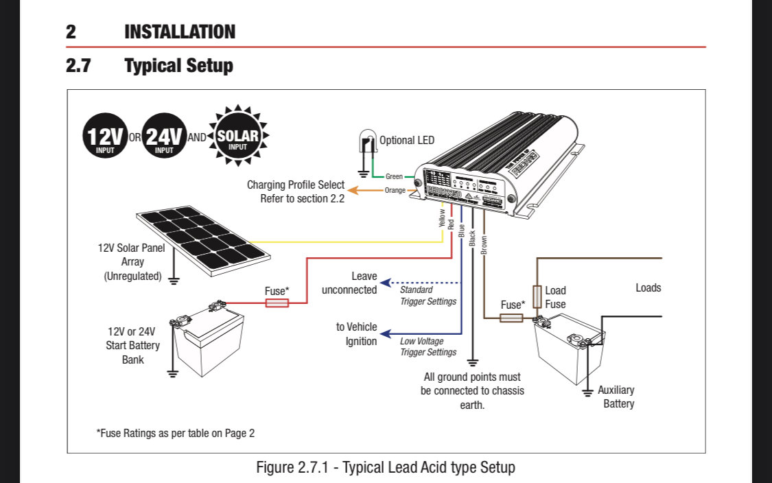

    So for those with a RedArc BCDC.
    it acts as the solar controller. And it says only tie in the + to the RedArc and just ground the solar panel.
    Can I ground it anywhere? I’m mounting on the roof so figure I’ll just ground into the roof rack bolts that go into the body.

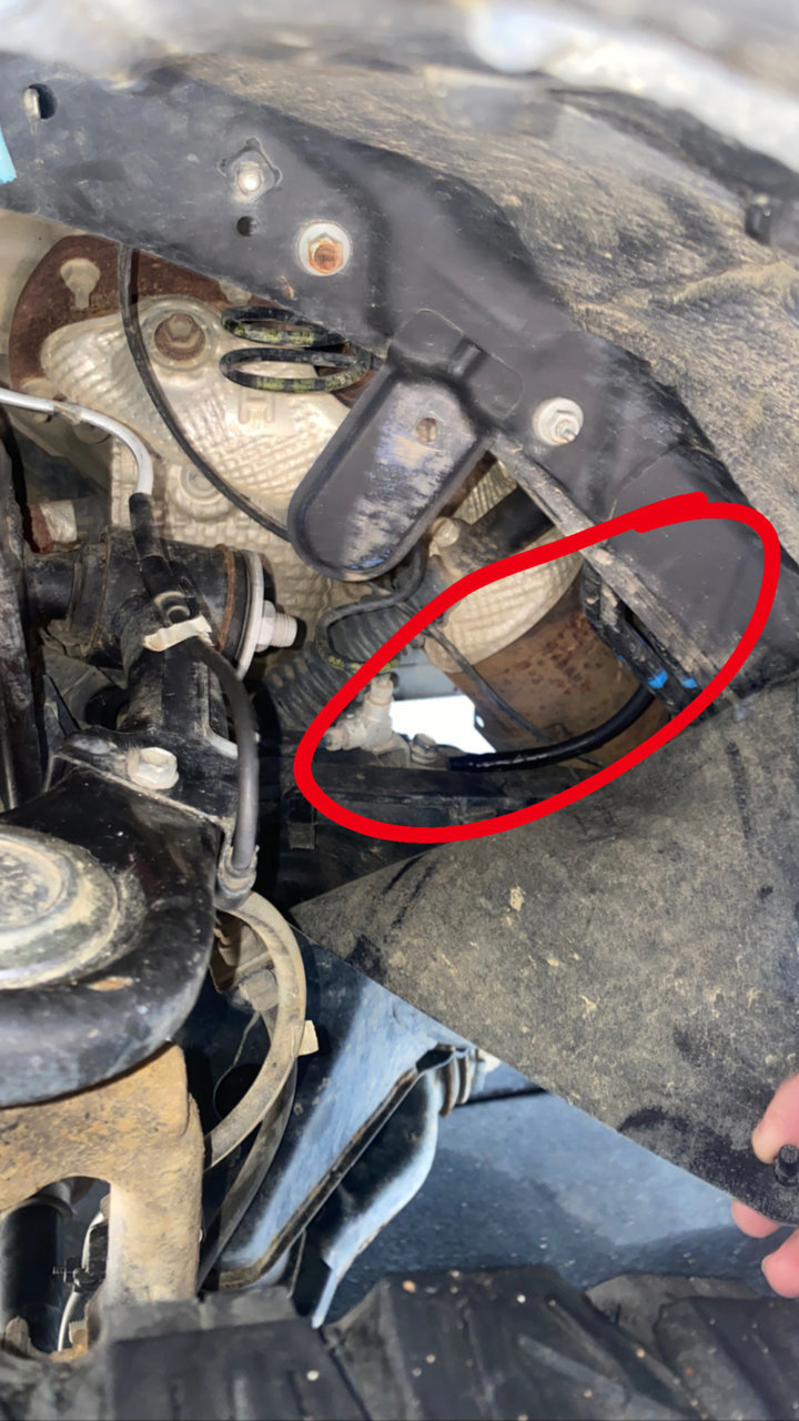

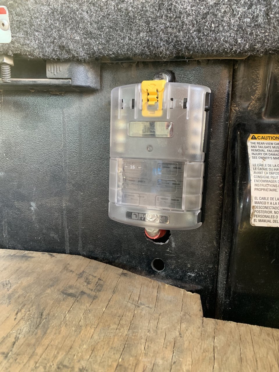

    This is how I have my set up. Hot wire from Aux Battery to Blue Sea Fuse Panel, Ground Wire to the frame.
    My fuse panel sits on the stock fuse box and my aux battery is in the passenger spot in the engine bay. I was even lazier than you; I just didn’t want to run a ground wire back across the engine bay lol. So boom right to the frame below the fuse box; I like this spot because you can access it right from the wheel well. My aux battery is grounded in the same spot on the front passenger side.

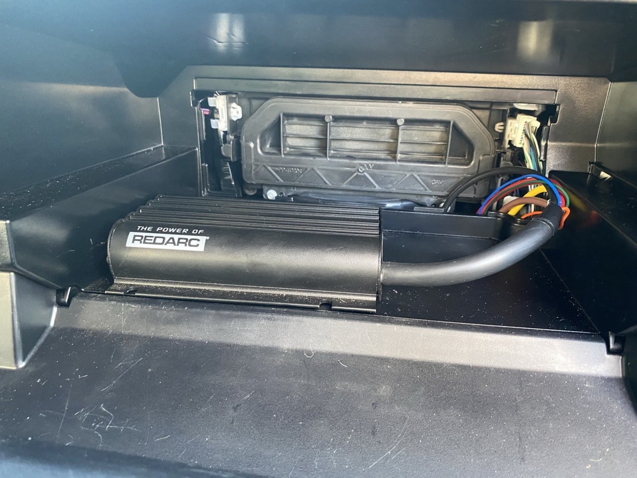

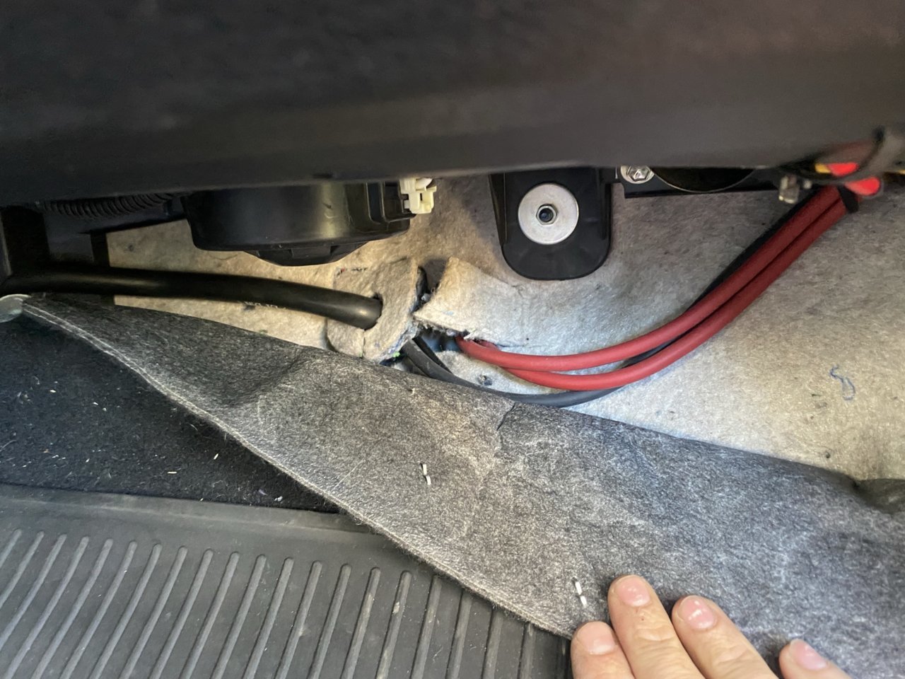

    Mine mounted in the glove box. I have a RedArc. most everything runs out through a hole I drilled in the fire wall. There is already a hole in the firewall with a rubber tube sticking out (AC maybe?). I have my comms coax going through that and it’s too tight to add thick gauge wire. So drilled a new hole (about 3/4”-1”) right next to that and added a rubber grommet.
