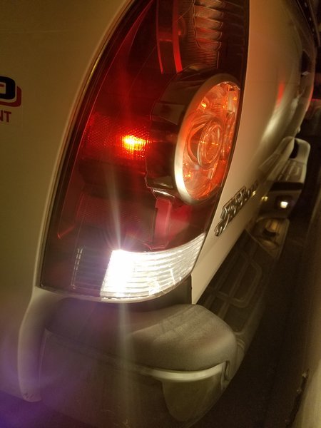

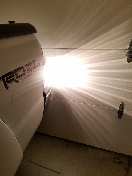

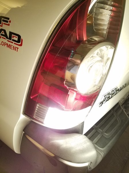

    Just wanted to post my experience with the upgrade. First off, thanks to crashnburn80 for all his help, second, what a difference!! I haven't used them in an off-road situation or anything where brighter will be a huge advantage but even in my backup cam at night it's much clearer. Not sure if the bulbs I got are slightly different than the ones crash originally listed or not but I needed to use a Dremel (after monkeying with it and getting frustrated after attempting to implement alternative 'solutions') to slightly narrow the shoulders of the bulb to get it to slide in. Used a standard metal file/flat edge cylindrical sanding drum bit with medium speed and light pressure, took about 30 seconds of sanding for each bulb while being very careful. Super easy. After that, install went as easy as possible, plug in, test, reinstall, bolt back up! E-Z P-Z.
    Stock:
    Results:
    GonzoQuick and crashnburn80[OP] like this.

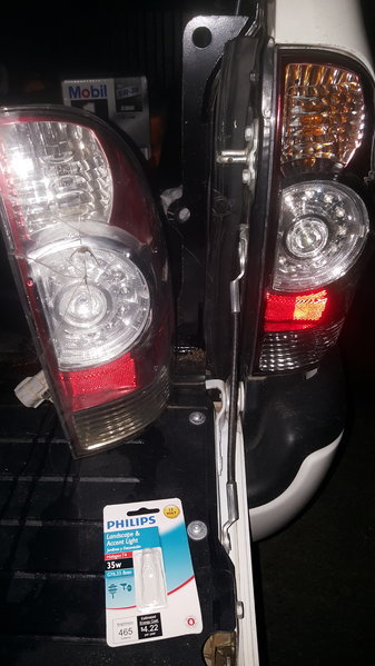

    I busted my tailight and installed a 35w halogen today. These are not the ones recommended in this thread. hopefully the 30w ones that are the subject of this thread will be in stock at the local hardware store soon.

    My first one went in easy, the 2nd was more of a hassle. I spred the prongs so they barely fit at a 45 degree angle where the prongs are going to opposite corners. Once the prongs were in I rotated the bulbs square and inserted them in.
    Not sure when they will be available domestically, though I suspect soon. But they are available for only a few bucks more internationally in the link I posted.

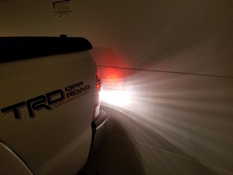

    Hi all. Just wanted to let you know I've completed this mod. Got the bulbs on Amazon pack of 5 for 15 bucks. I didn't want to mess with sanding etc..and the base of the bulb it a bit wider than the socket so I just bent the wires out a bit so they made solid contact with the sides of the socket and "cemented" them in with high temp gasket and it works like a charm. Great thing is if they burn out you just remove them and re-gasket! Sorry I don't have pics but these are like having your low beam on in the back of the truck. Brighter than my LED ditch lights for sure! Many thanks to @crashnburn80 for the mod. Next I'm waiting for my HL282 SMS upgrade!!

    I bet those are bright as heck 'cause you used 50w halogens rather than the OP recommendation of 30w. This may exceed the amp rating of the circuit, something to consider.

    Yes. I was concerned with this as well I left them on for 10 minutes outside the enclosure and they get HOT but the wires stayed cool. Didn't see any issues with blown fuses etc.. I would recommend not keeping them burning for more than a few minutes inside the enclosure but I don't do that much backing up so the light output is worth the risk for me.
