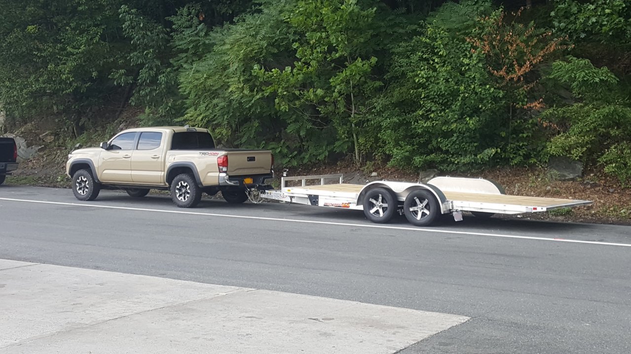

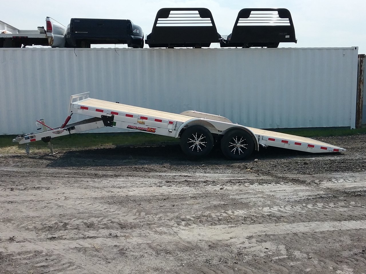

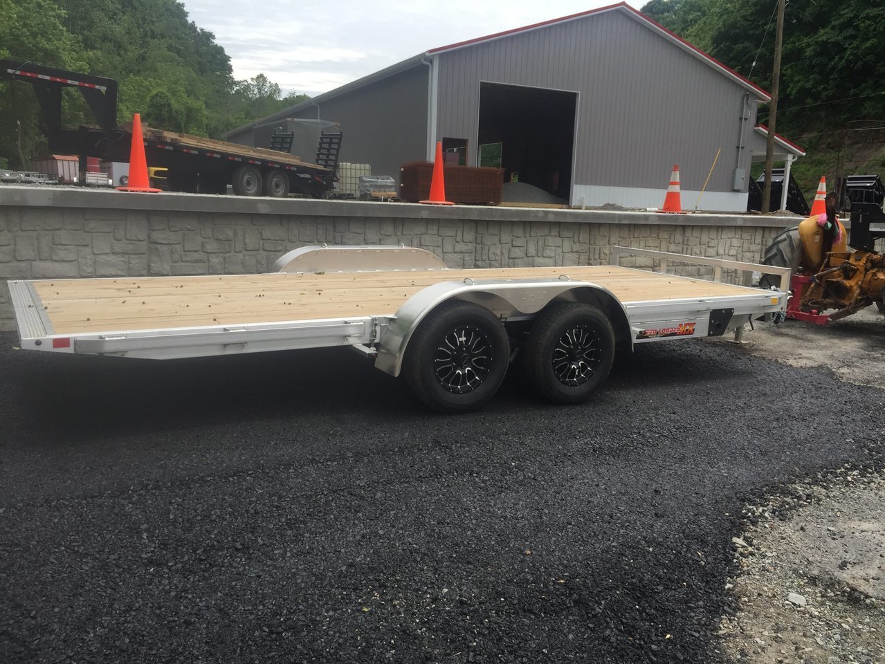

    s986120130554865898_p68_i8_w2560.jpg 20170717_143411.jpg download.jpg What are your guys throughts on an aluminum tilt bed behind a 3rd gen. They make this one in a manual tilt and also in a power electric tilt. 18'. 7k pounds gross weight.

    I'd call that a hard no. Never a good idea to tow something that weighs way more than the tow vehicle. If you need to stop suddenly it will take charge.

    And 7000 is 600 more than 6400.
    Will the truck pull it? More than likely.
    Can it do it safely? No.

    Looks like there between 1630 and 1670 empty. Want to tow cars

    The 7k gross is the max that the trailer can weigh with a load. If you're going to trailer vehicles, aluminum is the way to go with a Tacoma. Just keep the total weight below (for me well below) the 6400lb weight and have a good brake controller. However, if you plan on towing a lot then, I agree, a heavier tow vehicle would give a higher margin of safety in preventing the trailer pushing the tow vehicle.

    Finally put a deposit on one today.

    Picked it up.
