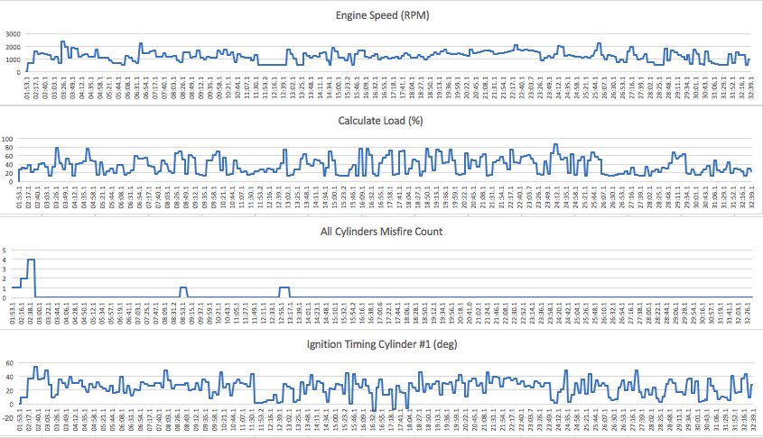

    I'm wondering if the EMC might not be calculating correct load maps with premium. Could still getting bad sensor data somewhere or in the tune...
    Does turning on/off other load items(a/c) have any effect on steering?

    Nope, try with / without A/C, etc., no difference. Seems to feel the best with mid-grade, regular vibrates too much, mid grade is less vibes and smoother steering. I have no doubt there are other suspect sensors - but I'll get it back on mid-grade and get some fresh readings. I used to get better mileage on premium vs. lower grades before replacing my CKP and that is no longer the case (as it should be).
    It still holds around 20 commuting and 18-19 highway 75mph driving.

    Here's some data from this AM in case you can make better sense of it...Messages Image(1040412884).jpg
    Clearly ignition timing is way low - and it wasn't like this last week. Hard to determine whether due to the fuel or "new" CKP at the moment though...

    I felt like you for 3-4k miles after replacing with my "89" in terms of shifting appropriately and pretty good throttle response, but within the last 2 weeks the shift points were slowly getting shorter and shorter resulting in the delayed downshifts and consequential bogging. I really felt like it was good to go and I'd be in great shape, finally after months of aggravation. Either relearned bad behavior after driving several thousand miles driving great or the replacement CKP was slowly succumbing to the same issues (when I removed to replace w/ the "98" there was some residue on it (dried like a light white flaky stuff - not a lot but it's there). Never got as bad as it did with my stock/factory CKP, but it was definitely degrading from the "WOW!" I felt driving it after replacing with the new "89" part.
    I wonder what would be safe to "clean" these CKPs with? Perhaps just needs to become part of regular maintenance if indeed it's from residue vs. the gap... but per your comments it's really hard to tell what the true problem is based on the documentation Toyota has produced.
