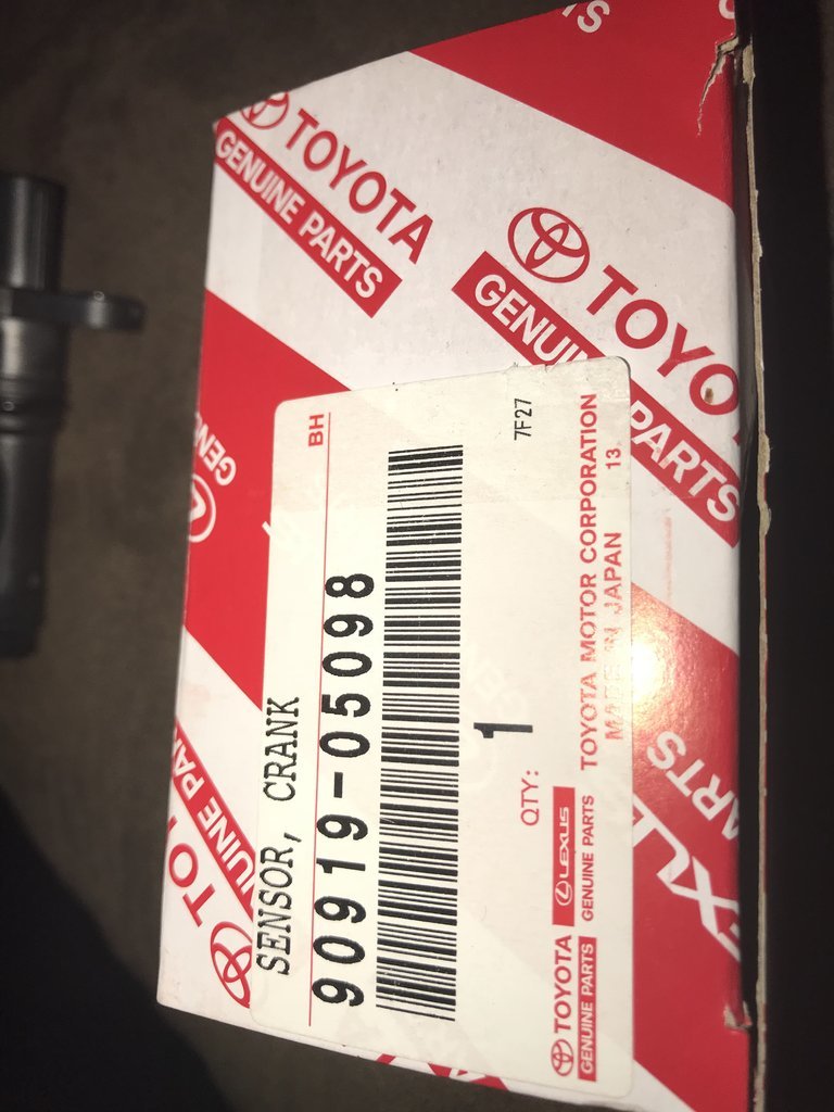

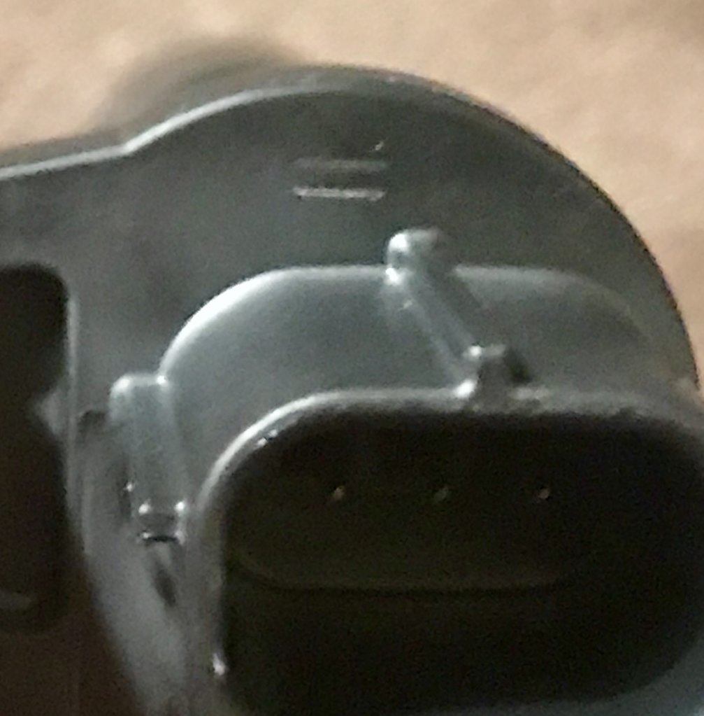

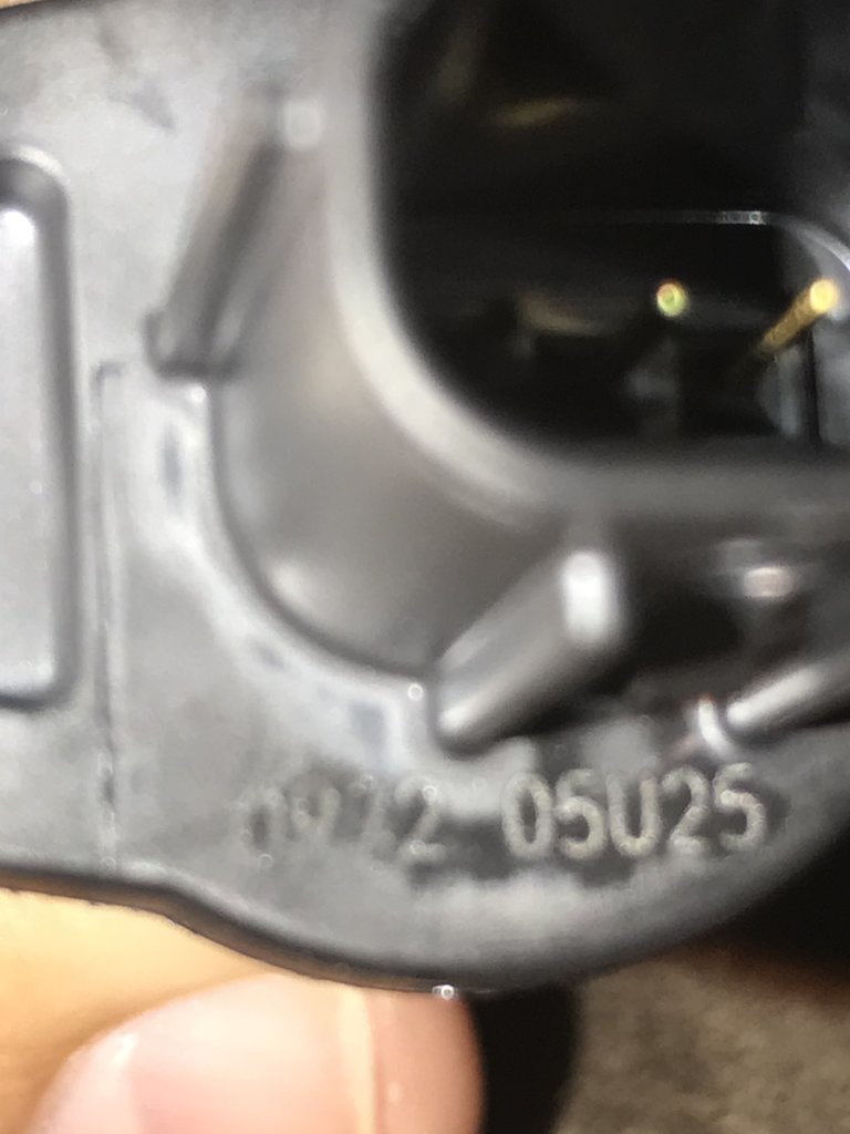

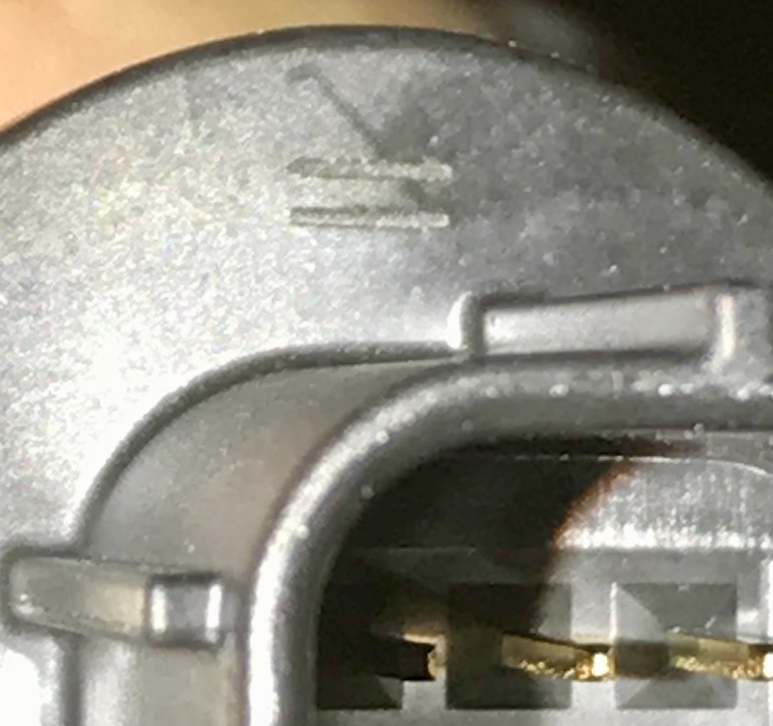

    Got my updated crank sensor today so I can replace myself. Not officially under recall but replacing as a precaution.
    Noticed that my new updated sensor does not have the circle with the hash marks. Instead, mine has two lines as in an equals sign. The box it came in say the correct updated part number 90919-05098. Curious if I should return and get one that has the circle with hash marks?

    Here are the differences I noted between the CPK in my truck and the new one I ordered, part # 90919-05098:
    Old CPK: Has the hash mark that some people guessed meant it was good.
    New CPK: Has the = sign on it where the hash mark was on the stock one.
    Old CPK: It had these numbers printed on it "0971 02U28"
    New CPK: "0972 06U20"
    All measurements were the same. The only other difference I noted was the stock CPK was a slightly lighter shade of black than the new one. That's it. There were no marks on the sensor end of my stock CPK like some of the people are reporting. I'm going to hold on to the old one for now. I will report back here in a few weeks how my MPGs look. I'm not really expecting a significant change, but I am hoping for one.
