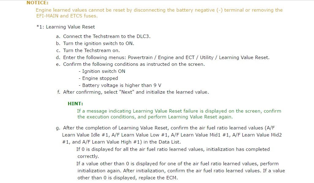

    Just disconnect the battery for 10 minutes or so. I always turn and hold the key for 10 seconds after I disconnect it to draw down any power.

    That only clears the short term learning. To completely clear the learning you need techstream. For those with techstream im just wondering what all you change/clear in techstream

    The simplest way would be to disconnect your battery for a while, but there is a button that says something like "reset learned data" or something like that in Techstream.

    I reset via battery and that was good enough to reset the learned values resulting in the stumbles.

    Thanks you for locating that. I was just about to post some screenshots since I just did this on mine. I haven't replaced the sensor, but I am curious to see if it is a learned condition. I'm not completely convinced that the CKP is the problem so I am going to test everything I can before I replace it or get it replaced. I have a service appointment Monday so I will also be flashing back to stock.

    I've been doing some experimenting on my truck the past two days. Yesterday I wiped all the learned data on my OV tune to see if it had any effect. In the ~150 miles I drove yesterday and today, the stumbling/fluttering was still there from the beginning.
    Tonight I flashed back to the stock tune in preparation for bringing my truck in to the dealer on Monday. I also made sure to wipe all learned data again. I took a short trip to the store and back while taking some logs. I tried my best to make the problem show up and could not.
    I am not convinced the issue lies solely with the crank sensor, at least on my truck. I have to do some driving around over the weekend so I will keep testing it.
