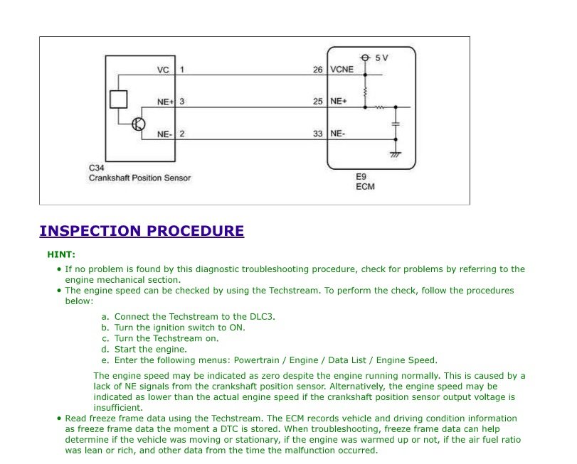

    SO just a little light Saturday night conversation... The DIR document states the following WRT the CKP:
    "Some of the V6 engine crankshaft rotors may have been produced with an anti-corrosion coating
    containing a greater concentration of silica, which increases the coating thickness. This may
    cause potential interference with the crank position sensor during normal vehicle operation.
    The interference could generate a static charge, which could result in a crank position sensor
    malfunction."
    This is only a theory, as Toyota was not able to reproduce an abnormal CKP waveform during any of their lab/bench tests.
    Anyway, we are also told in the DIR that a CKP of "improved design" is the remedy - presumably the "98". If static charge on the tip of the sensor is the culprit, what does "improved design" mean to you?
    - Some kind of shielding in the tip, or changes to the internal circuitry of the sensor.. or both.
    What got me thinking about this was that when a truck stalls (and the CKP is the problem), the vehicle won't run properly until the sensor is replaced (in most cases I've seen). The thing about a static charge is it's not permanent - so if you were to pull the sensor (or just let the truck sit), presumably at some point the charge would dissipate or ground out. Assuming this, you could put the same sensor back in and be good to go until the same conditions arose again and the static charge accumulated on the tip - UNLESS - the static charge was actually causing damage/degradation of the internal components/circuitry. Hence the need for a new sensor.
    Ok, so where am I going with all this? It's simply the long form of a thought that a few others have already brought forward - "89" model CKPs may only be a temporary fix to this issue. I could very well be wrong, and I hope I am - because a number of members have had the CKP replaced under warranty or did it themselves as a preventive measure. We know that the "98" was only introduced recently.
    That's it, discuss if you like. Here's a basic schematic of the sensor/related ECM interface:
    Edit: I've been reading a little more on Hall Effect IC sensors (which is what this is), and the air gap between the sensor and the reluctor wheel on the crank has to be quite small - typically in 30 to 60 thou range. That may be why we couldn't eyeball any physical changes between the "89" and "98" sensors, particularly in length.
