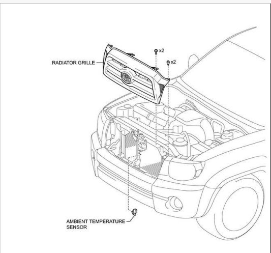

    Can anyone post up a wiring diagram?
    Does Toyota use two different temp sensors? I'm thinking there is more than one.
    1) Intake Air Temp ==> This sensor is almost universally located near the front grill where intake air enters the air filter housing. This sensor controls the PCM / ECM for fuel mgmt and more. This, I believe, is an independent sensor.
    2) Outside Air Temp (or Exterior Temp) ==> Like what shows on your dash. I'm wondering or thinking this sensor may be located on the front windshield, near the rear view mirror, and now fouled by this new coating. Or the sensor was mucked up during the coating install?
    The outside air temp may not be the same as the intake air temp. Think about driving on a cold, slushy, roads but on a bright sunny day.
    IAT near the grille might be 10-20 degrees or more colder than the OAT windshield temp sensor.
    Plug in a scan tool. If you don't have one, proceed to your nearest local brick-n-mortar auto parts store and ask them to scan it for you.
    If your IAT is reading normally, say 78F but your dash display is still reading -34F then you have your answer
  9. Apr 3, 2024 at 5:17 PM
    Vlady
    Vlady Well-Known Member
    Dec 20, 2017
    #238986
    4,454
    Issy, WA
    2017 White SR5 DCSB V6 4x4
    It is a part of MAF sensor

    ^^ OK, this makes sense^^ No better place than to measure IAT Intake Air Temp.
    Where is the OAT Outside Air Temp sensor located?????????
    Apologies for the questioning. I am WAY more familiar with Ford Mustangs and have access to wiring diagrams since 2005.
    If I had the same for these trucks, I could (would) be more definitive

  12. Apr 3, 2024 at 6:33 PM
    BigCarbonFootprint
    BigCarbonFootprint Well-Known Member
    Nov 25, 2019
    #311686
    233
    Andy
    2019 TRD Off Road
    King Racing 3” lift
    Wow. I would not have guessed it there. Thanks for sharing.
