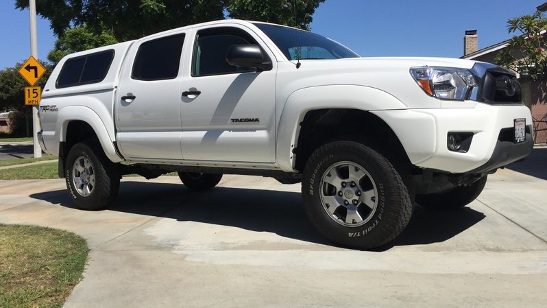

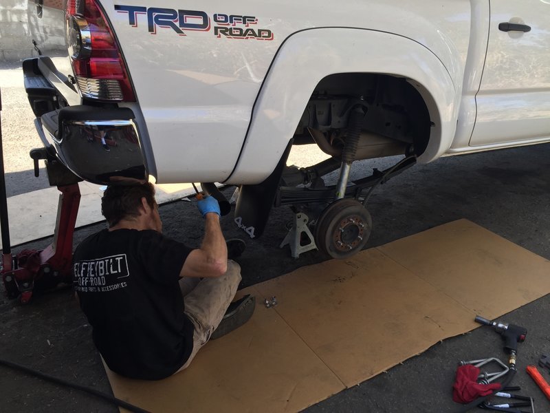

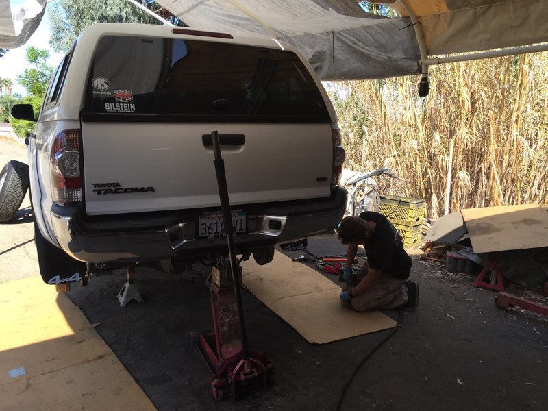

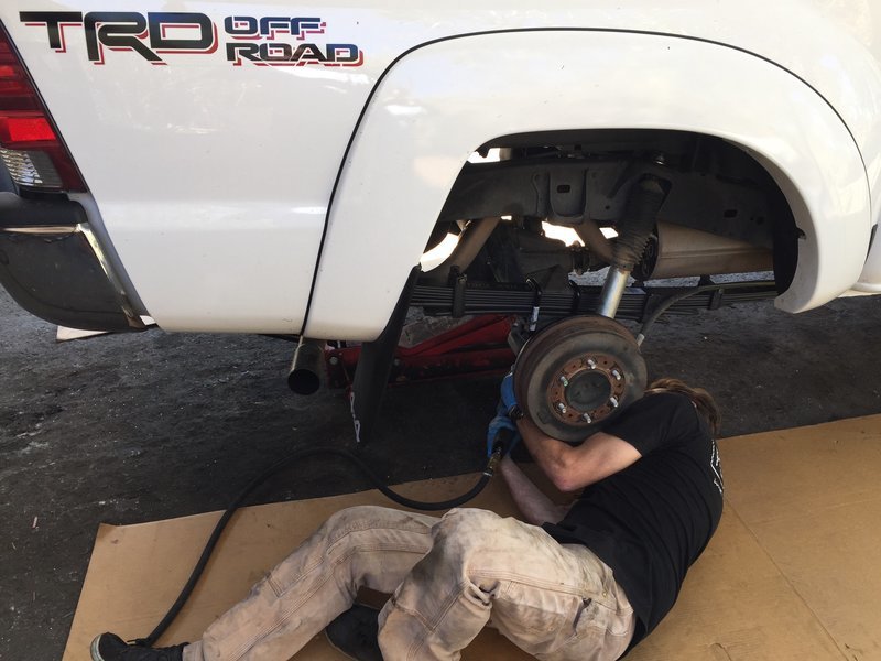

    Had my OME Daker CS047R installed today and CB drop kit.i needed more stability in the back with the shell and gear. The AAL's were not cutting it. Thank's Jason (Speedfreak) here on the So Cal forum.
    He does great work and fair prices. Also thank Marie @HeadStrong Off-Road.

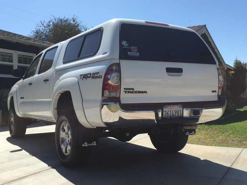

    885's w/ 5100's all around and Dakars CS047R's. Now to get dirty.......

    Look's great! How's it ride? And did you keep the 5100's at the stock setting? How much actual lift do you think you got? Getting ready to click buy now on the same components so any specifics you can tell me would be greatly appreciated! Thanks for your time.

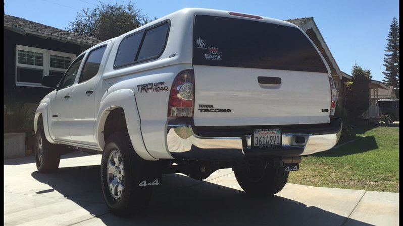

    Hey brown taco, It rides awesome, Id say it lifted the back 3 inches. Yes I originally bought the kit as OME 885's with 5100's and an AAL. So the front 5100's are at 0. front lift 2 1/2 inches. It has a 1/2 rake and I like it that way. I will be full of gear and pulling a tent trailer.
    The truck rides fantastic, better than stock.It is firm ,no body roll and stops without dipping in the front.
    With my shell and gear the back just sags to much for my liking and I tore off my trailer harness the next day wheeling......
    The truck rides awesome
    I also used a Dremil and cut 2 inches off my 4x4 mud flaps in the back...
    I am so happy with the leaf pack's it is like night and day! I highly recommend it! especially if you have a shell ..
    Headstrong off road rocks!

    No issues.. Front- 5100's at 0 with 885's (2 1/2 "). Rear 5100's Dakar CS047R leaf packs 3". For a daily driver , weekend warrior and trailer hauler this suspension setup I would recommend.
    The ride is great on and off road. No sagging with shell and trailer.
    No issues after a few months.
