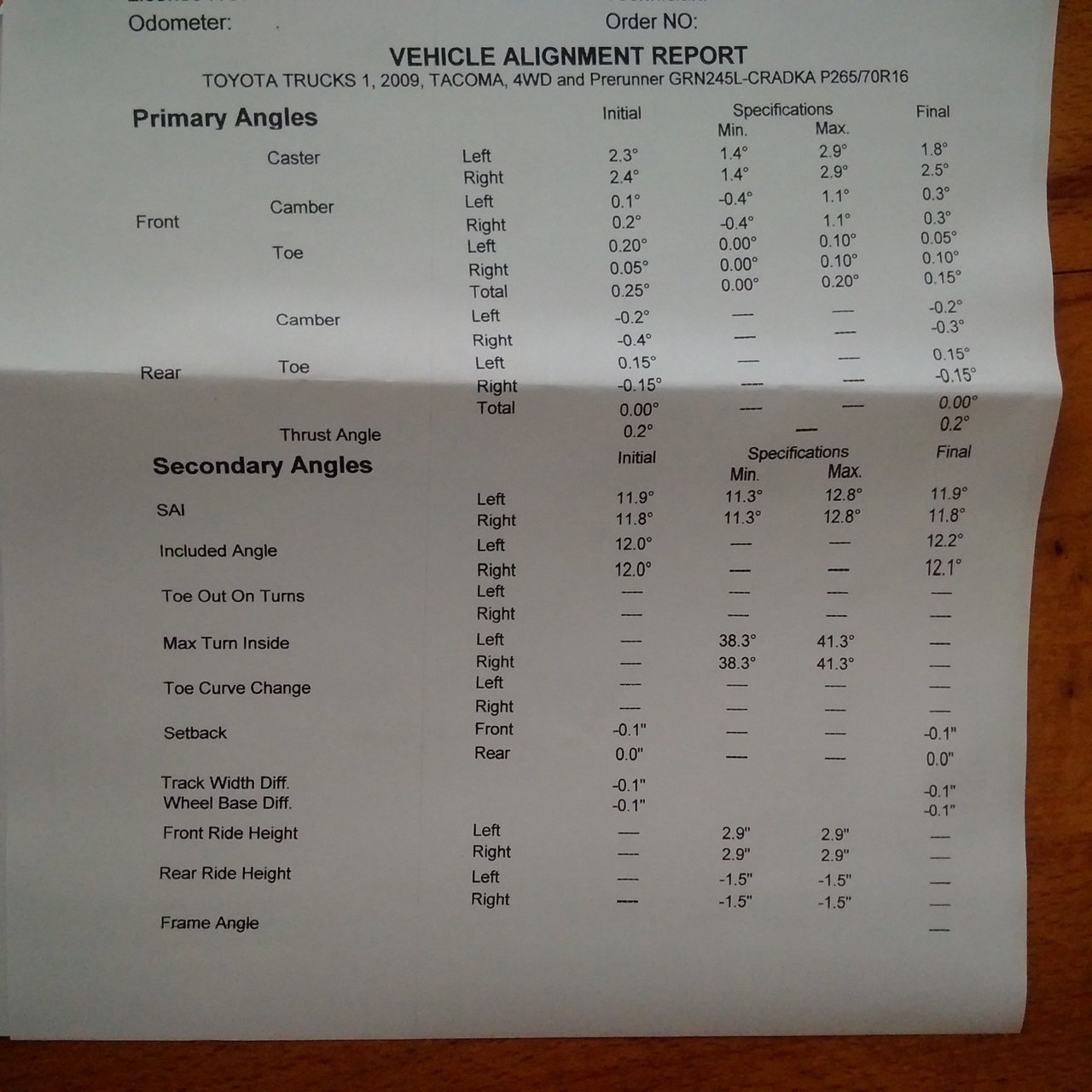

    After a somewhat long road trip on the highway, I noticed my front passenger tire was wearing significantly faster than the rest of the tire. So, I went in for an alignment after doing an inspection to make sure I didn't have any broken suspension parts to the best of my abilities.
    For reference, I'm sitting on the stock sport suspension with cooper discovery at3 265/70/17 IMG_20180330_135054.jpg

    that alignment is all over the place get a new one, you can see especially on the right toe adjustment is was set at the max.
