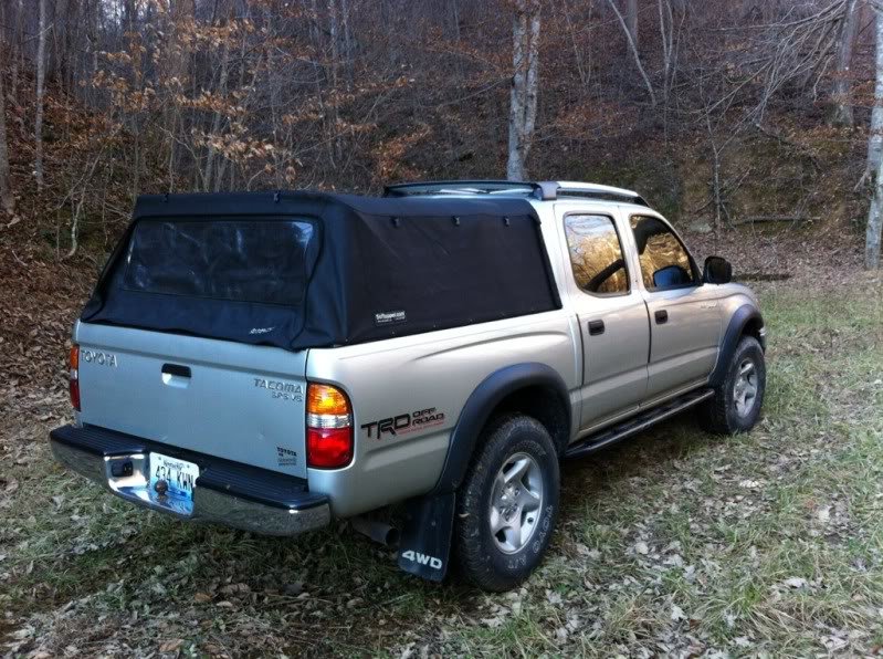

    I'd like to start this thread with what my plans are for this truck and what I expect of it. I mainly want this truck to be good all around. I want to be able to tackle the rocks one weekend and travel wherever I want to go thr next weekend. I'm more of an expedition type of guy than a rock crawler. I want to be able to point my truck in any direction and be able to go that way.
    Lets start with how i ended up with this truck. I traded my 07 Camry SE for this 03 Tacoma Double Cab 4wd. After selling my 4runner in 2010 I was happy to be back in the 4wd Toyota family. Here is the build to my old 3rd gen 4runner. ac7ee261_1fcf210a4c9d2a3331f99e7ca474dbb50cbd44e0.jpg

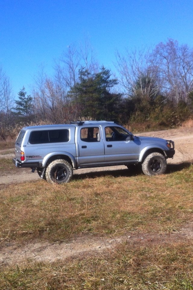

    Tacoma as of 12/31/12
    93F25AA4-89F8-4425-845D-F6AA6754CD79-163_c1a8cd8929b22ffdffaf93aa8e5029e5177074b2.jpg
    Sliders, custom rear bumper, Arb front bumper,Softopper, SAW coilovers,Dakar leafs, OME Nitrocharger sports, 255/85 KM2

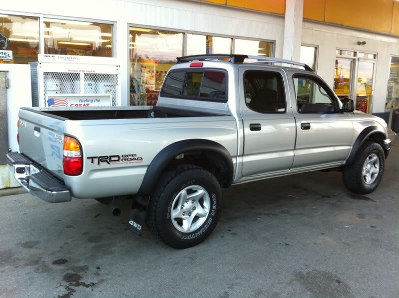

    When I traded it had a hard cover on, that was taken off the same day. Here is the first pic I have of the truck.
    8fc19e57_afe14b149ced9b9e6e8594b4df7fdcf39ffca001.jpg Bone stock. I actually planned on keeping it that way for a while but that lasted a week.
    Couple more pics while stock.

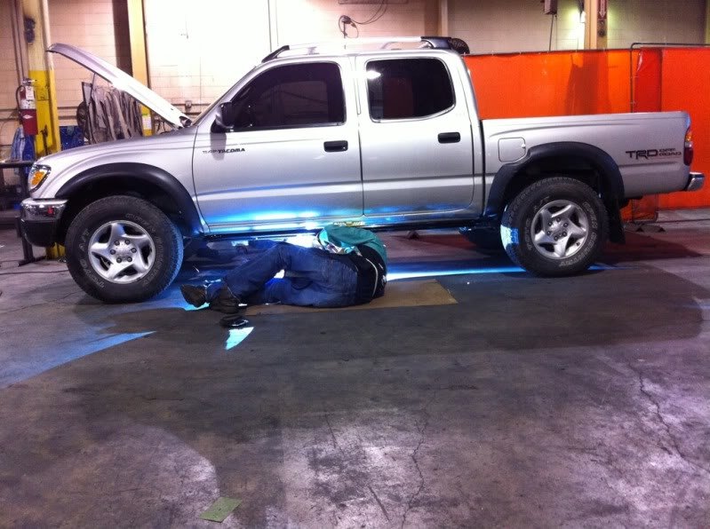

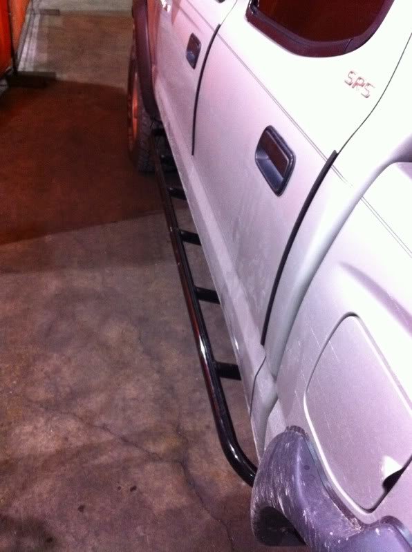

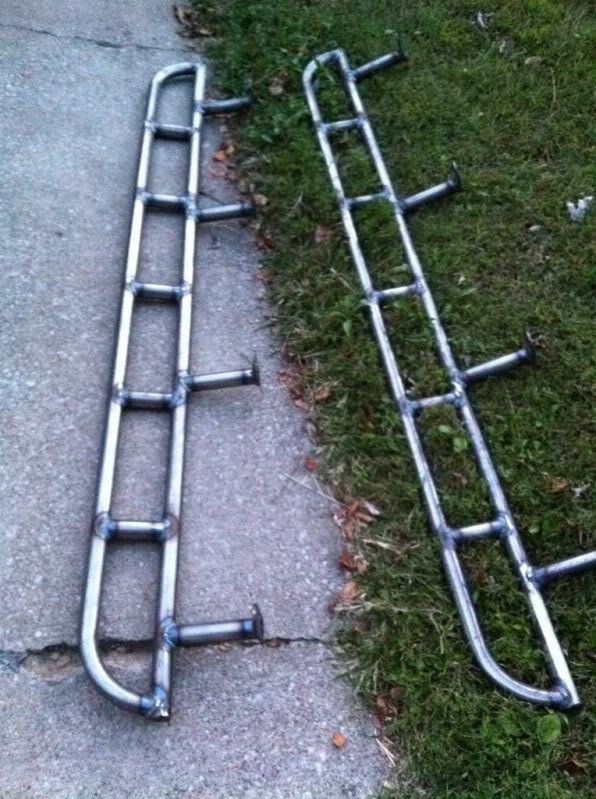

    I tinted the front windows and added some sliders I had made locally.

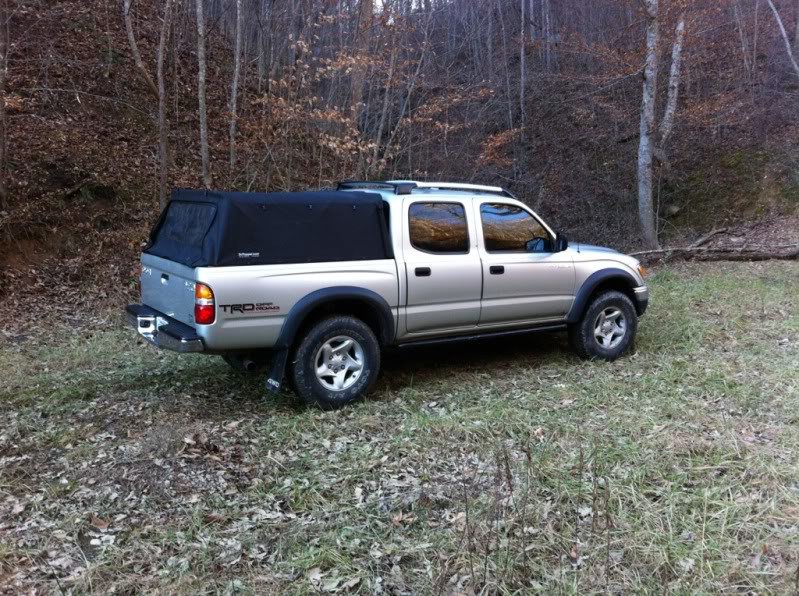

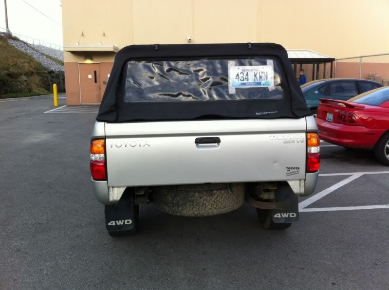

    I hated not really being able to leave anything in the bed. I went back and forth between a leer topper or a softopper and decided on the softopper because I wanted to be able to take it on and off easily. Plus I think the softopper looks bad ass.
    I have alcan leafs sitting in the garage and plan on going with 255/85 KM2 and bilstein all around.

    nice lookin truck. you may want add kick outs to those sliders mine have saved me from body damage on more then one occasion.

    Can you drive with the topper on the freeway?

    Yeah kickouts may be something I add down the line but I really dont like the look of the kickout all that much. I know it serves a purpose but these sliders will do just fine for the time being.
    Oh yeah. So far Ive had it up to 80 just to check and see if it was going to stay lol. Never moved one time and now I dont worry about it back there. The first week I was constantly checking to make sure it was still back there lol

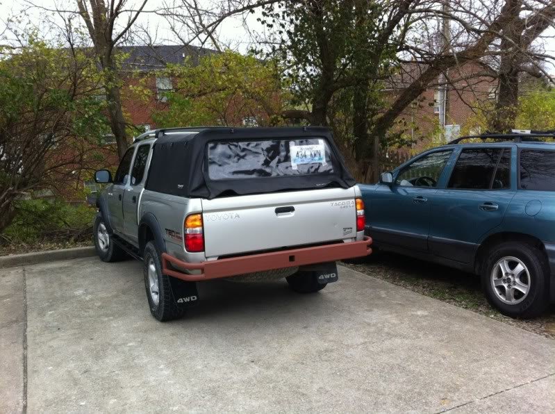

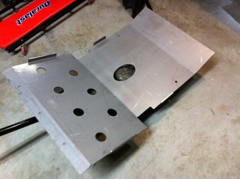

    Couple updates..Made an IFS skid and had a buddy make a rear bumper for me. Ill get better pics of the rear when I get it painted. Will be ordering the rest of my suspension this week as well.

    Looks good, I'm liking the license plate mod :D

    Haha thanks it's the only thing I could think of. Had to drive around like this
    For about a week.
    After I paint it I'm going to mount it over the hitch.

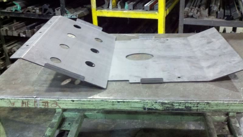

    I've had a few PM's about the Front IFS skid. The skid is CNC plasma cut 3/16th USA steel. It's heavy duty. These pics are close to the final one.
    The final design will have the oil drain hole a little smaller and moved up about an inch and the bolt holes will be oblong for better adjust ability while mounting.
    I will be selling them for $200 plus shipping. Will be shipped bare steel but may be able to get powder-coated for an additional cost.
