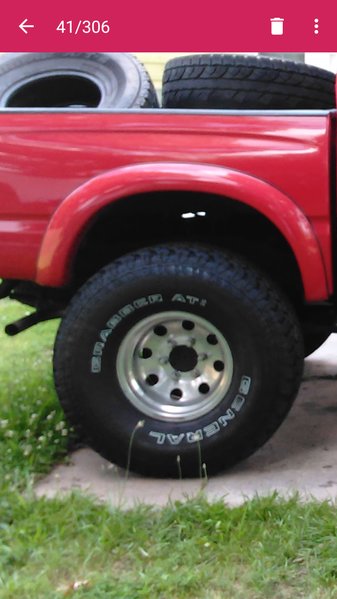

    Rough Country 6", 2" blocks, 3 Inch Body, 15x8 with 35x12.50 General AT2
    Did a google search and search on TW, does anyone know who sells the lift blocks to center the rear axle in the wheel well? I already have an add a leaf so only looking for 1 inch or less block thickness.

    Thank you! I see they offer 3/4 or 1 inch offset, anyone know what is the perfect amount to center?

    Why is your rear axle off-center?

    All Tacoma axles are slightly to the rear of wheel wells from the factory.

    My OME springs moved the axle forward and I rub on the front of the rear fender with 33's.
