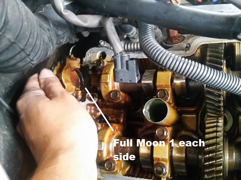

    You did the full moons too I hope?
    There is a great sticky above for it. Step by step.
    I think the moons are more prone to leak than the gaskets.
    Run your hand behind the head, if oily, moons are leaking.

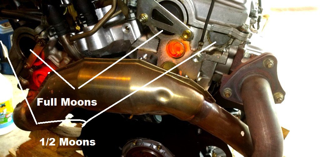

    Yup. Got 'em. That 4th one that I referred to was the 4th 1/2 moon. So now I got'a ask, what purpose do they serve?

    full moons are complete circles. requires removing a cam journal cover.
    LOOK AT THE STICKY OR READ MANUAL.

    The full circles are so the head can be used on either side of the engine and for drilling the intake cam journals.
    The 1/2 circles are from drilling the exhaust cam journals in the casting.
    BTW back of engine.
