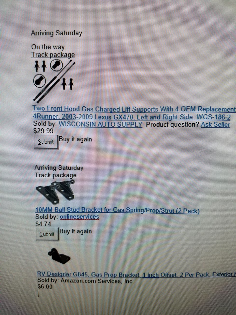

    Redline spec.
    20 1/2" extended
    11" compressed
    jamesfishn09 shared with me from his redline install.
    Bought all my components, will install soon.:thumbsup:
    I may use some rivnuts.

    Parts on the way.
    $40 so far.
    Fit Form and Function.
