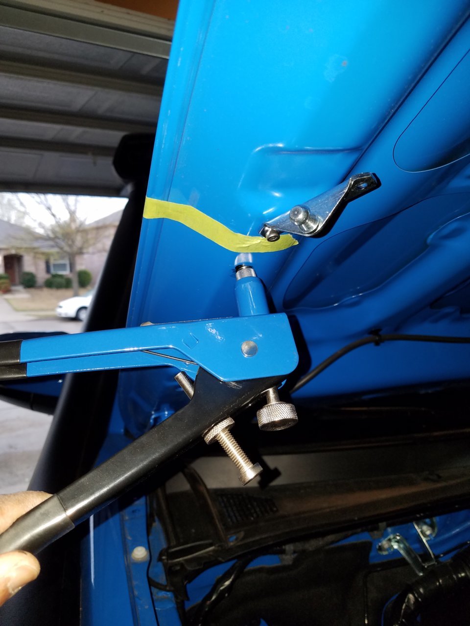

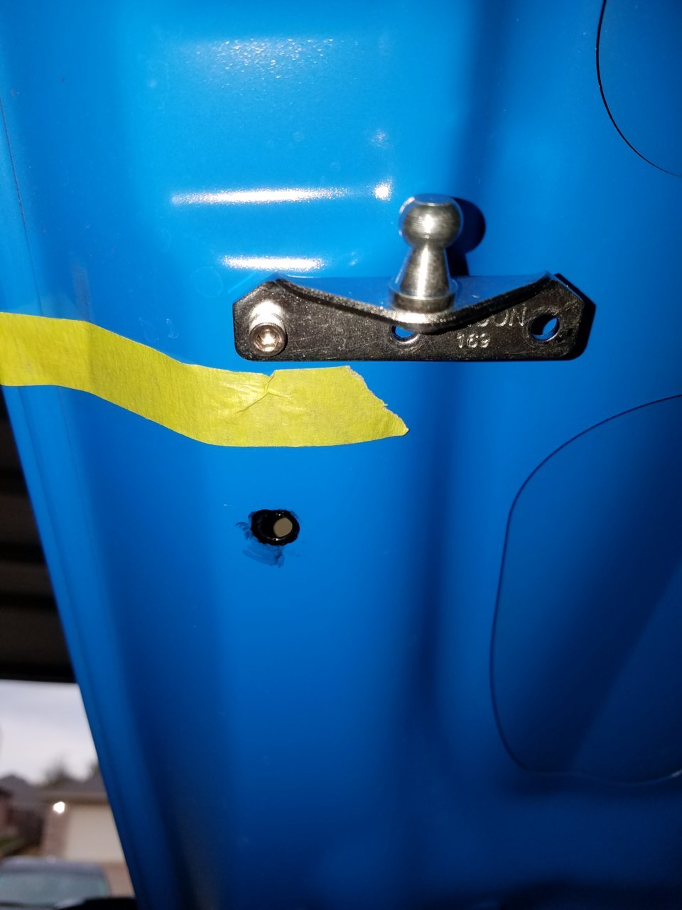

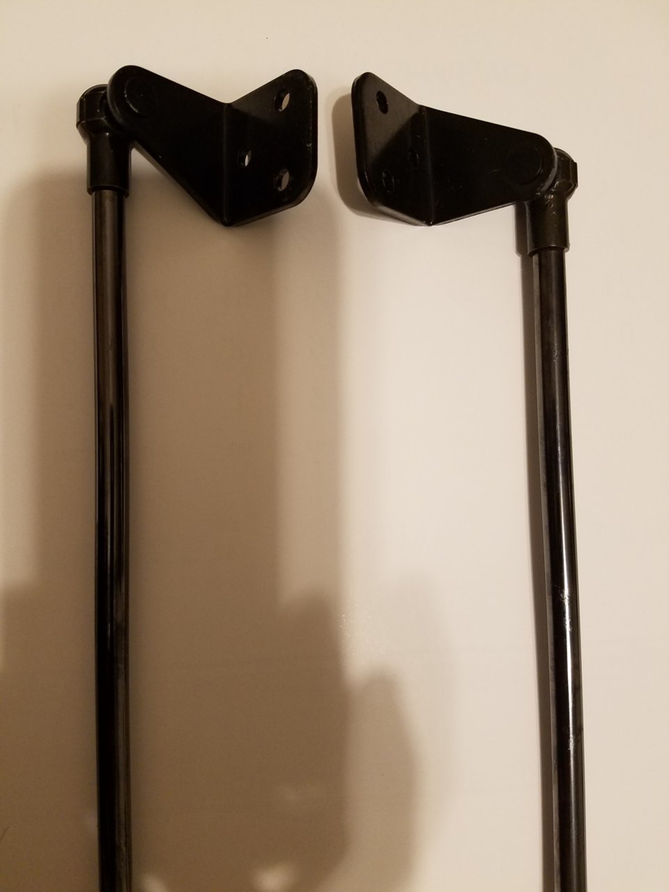

    Moving along nicely so far.
    Using rivnuts.
    Project update.
    The struts are perfect, correct force, sturdy all metal construction.
    My issue is with one sets of brackets.
    Since these are 3/4" offset, it makes the left and right sides off by 3/4".
    It can work, but my OCD doesn't allow it.
    See pic below. So i need a common set of brackets.
    Also, rivnuts are overkill, regular rivets are just fine.
    I guess if you want to avoid all of this, just buy Redline.
    Waiting for you OP. :thumbsup:

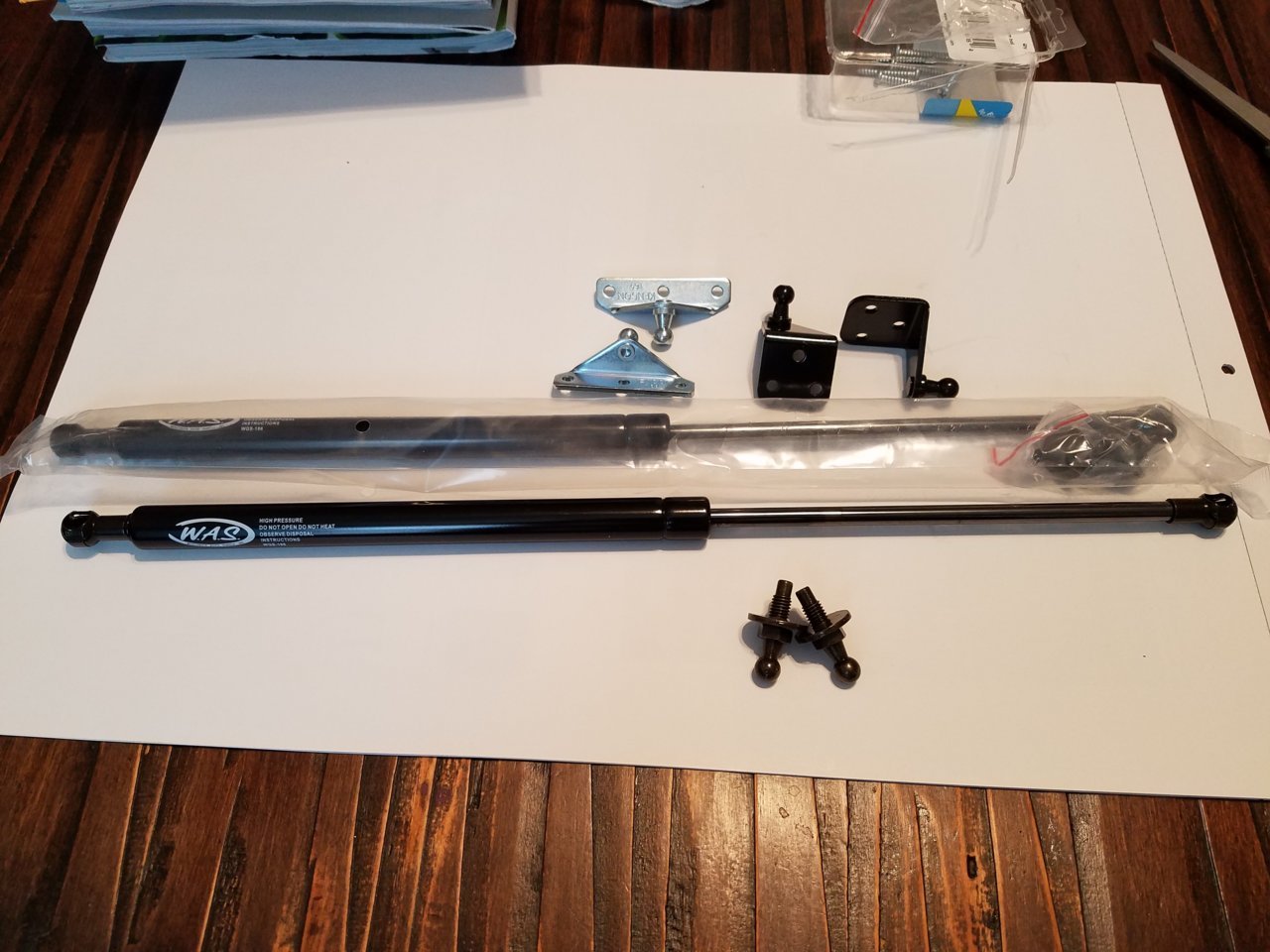

    Got my stuff today, mounts all look great. Only issue I see is that I may of gotten too strong of struts. They are 50lbs of force each, and are really heavy duty. Im going to install it all and see how it works this weekend.
