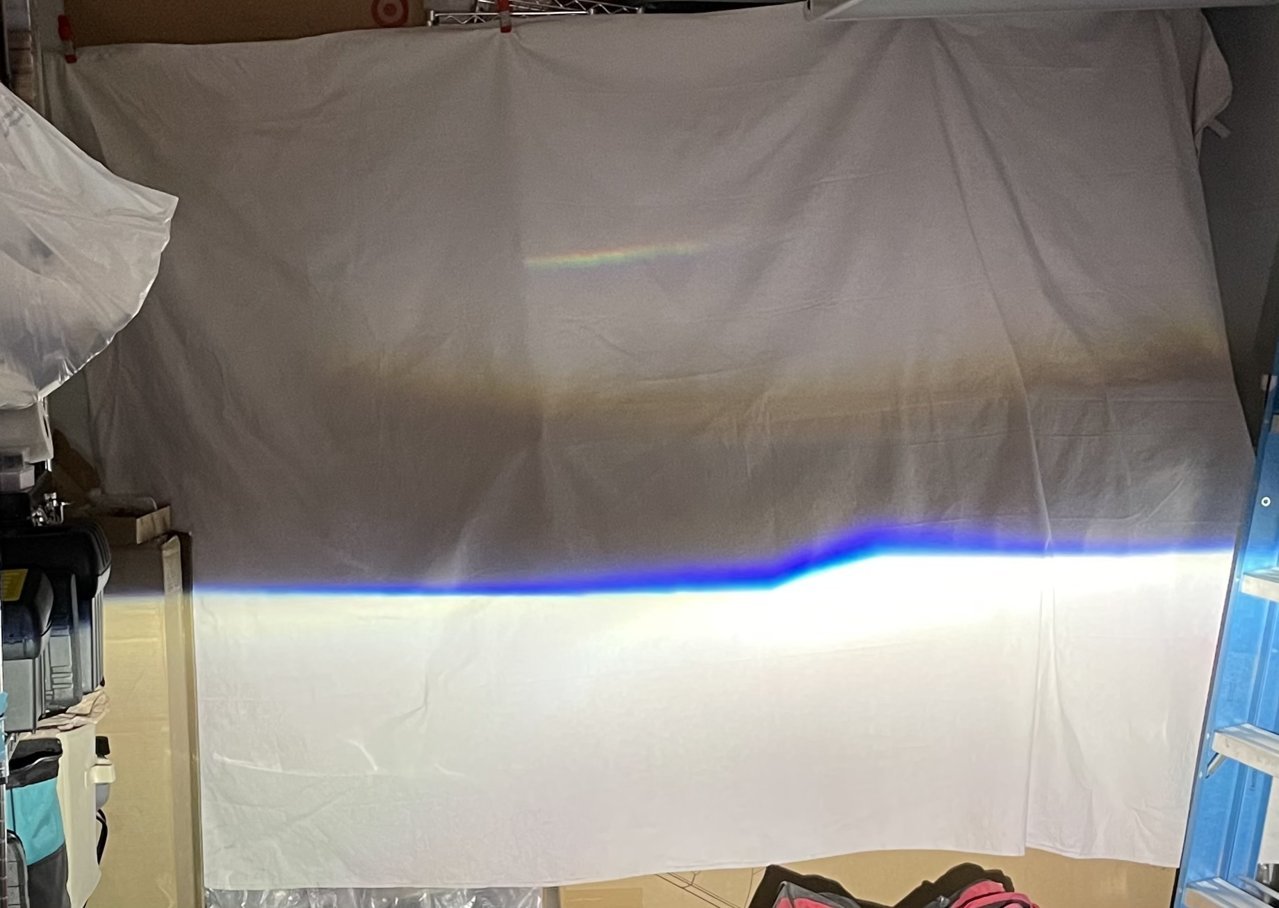

    A proper HID or LED retrofit is preferable to just changing out your bulbs. If you read the 3rd Gen headlight mega thread you’ll see a lot of good info.

    Whatever you do, don’t just throw a pair of HID or LED bulbs in your halogen projectors or @crashnburn80 will make a fool of you :rolleyes:

    If you haven’t figured it out yet, doing a headlight retrofit is not a simple task. You just opened up a rabbit hole that will pry open your wallet and keep you up at night. I think all of us who have responded to this thread can admit.... or deny spending an embarrassing amount of time and money on our headlights.
    Here’s a picture of one of the RX-350 projectors I was working on. You’ll see how much better it is over stock. This is just the low beam.

    I gotta say you are right. These lights have been on my mind all night. Looks like my main expense will be the RX350s and that V6 switchback DRL. Unless you are going to blow my mind about a new thing I need to add lol!
