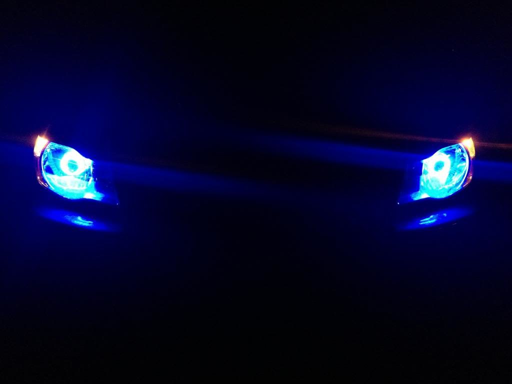

    Pretty sure you'll have to take apart your headlights to replace them, these are my retrofitted blue halos

    Where did you get your blue halos from? Only ones I've found are white and amber. Do they have an assortment of colors?

    theretrofitsource.com (the link above my previous post), you can order three colors. White, Blue & Red as far as I know

    I clicked on the link to retrofitsource and only saw white and amber listed. Either way they don't have green so I'm no too interested lol.
