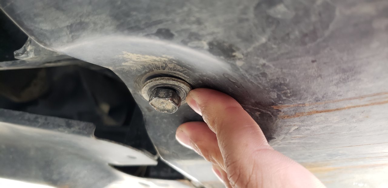

    I had the same thing happen. This is how mine was left. The funny thing is that I saw the tech do it and on the way home the skid started to rattle really bad. I called the service manager and they replaced the 4 bolts and re threaded the one that was crossed. As soon as I got home I removed it and made sure it threaded back on easily.

    What a bunch of monkeys. If it were me, I would re-tap if possible. If it's a rivnut, R and R or consider welding a new, real nut in place of the rivnut if you can do that. If it's a real nut and won't re-tap, helicoil it.
    I'm sure these monkeys just drove the bolt in without starting it first... nice.

    probably be a good idea to anti seize or lube them screws/bolts so they wont rust up again and cause the same issue

    those screws for the skid plates develop rust on the threads and become seized in the bolt that's welded on the rail underneath and become a real pain in the ass, all 4 of mine broke off. usually the mechanics don't retap and fix the screws they busted or want an added charge to do it

    Another option, if you want to use the same hardware and dont mind the expense, is to install a Helicoil or Timesert. I have used the latter to repair stripped threads in aluminum and they are awesome.
