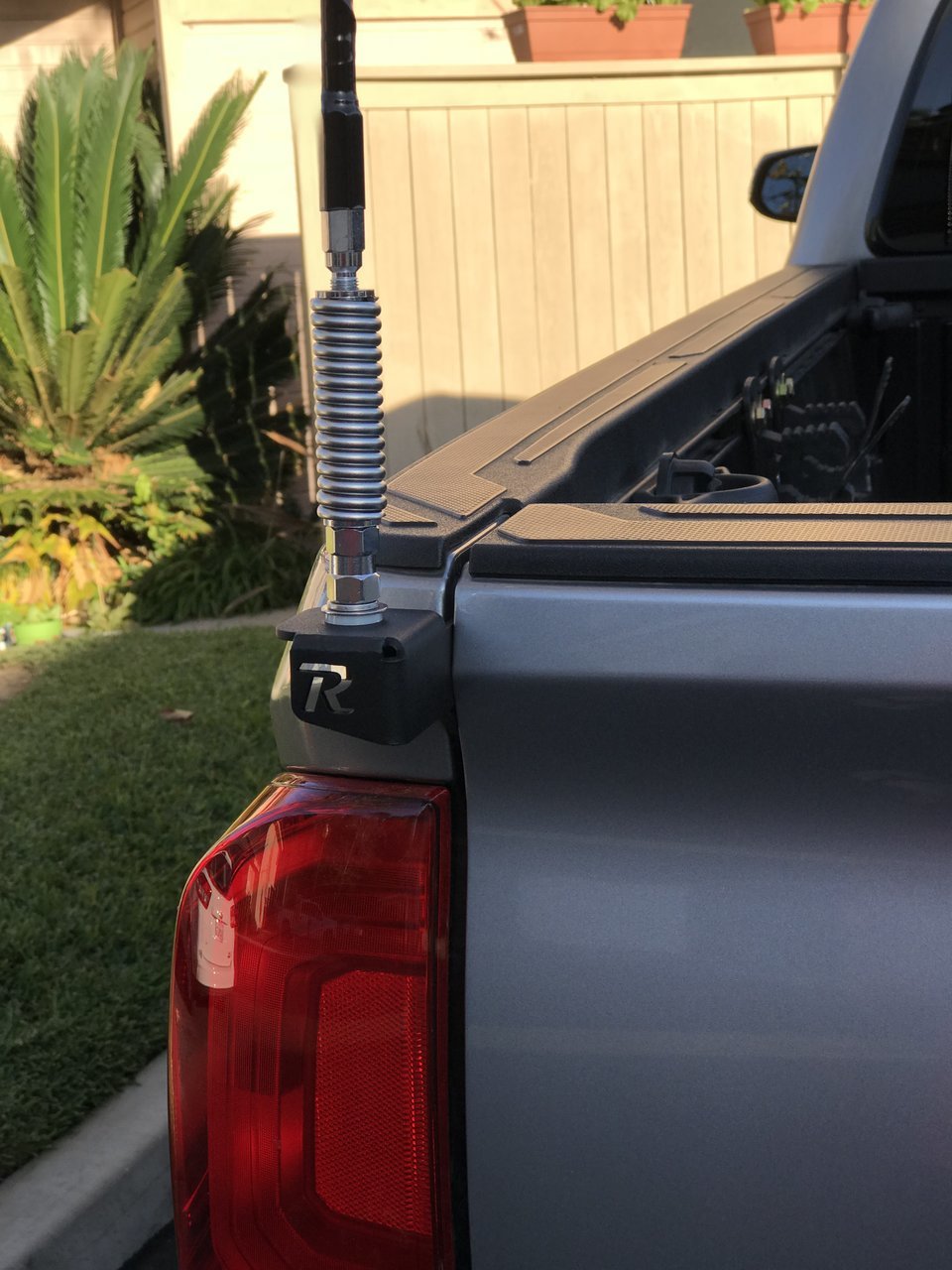

    I ran the cable by removing the tail light. There’s a space right below the mount that you can use. I didn’t have to drill.

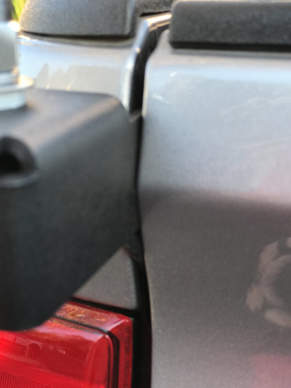

    That looks great! I routed my diff breather hose behind the tail light, so I'm familiar with that space. But I meant how big is the hole in the bracket itself? What stud/adapter did you use?
    Thanks! This is very promising.

  13. Feb 25, 2018 at 5:21 PM
    YotalikesTacos
    YotalikesTacos Big Sexy Trail Limo
    Sep 7, 2017
    #229346
    195
    Travis
    2017 Big Sexy Trail Limo TRD Offroad 4X4
  14. Feb 25, 2018 at 5:28 PM

    Thanks guys, this is all very helpful. I think I may try the Rago mount and see how it goes, worst case I'm out $50 and will go with a magmount.
    I'm not sure the Rago is properly grounded, though. I'm guessing scraping some of the paint off and running a ground wire would improve things?

    Remember you need a ground plane, not an electrical ground. Just scrapping paint off the mount probably won't help much; but if it needs a little help, running a wide ground strap from the mount down to the frame might do the trick.
    I've ran a 2m/70cm from a ditch light bracket for quite a while now; never had problems communicating. and could talk to a buddy around 10 miles away (with houses, building, and trees in between) without problem. Now I have it on a bed rail just behind my cab, with the same experience. I'm pretty much just using mine for trail comms though, and the occasional morning chat on local repeaters.
