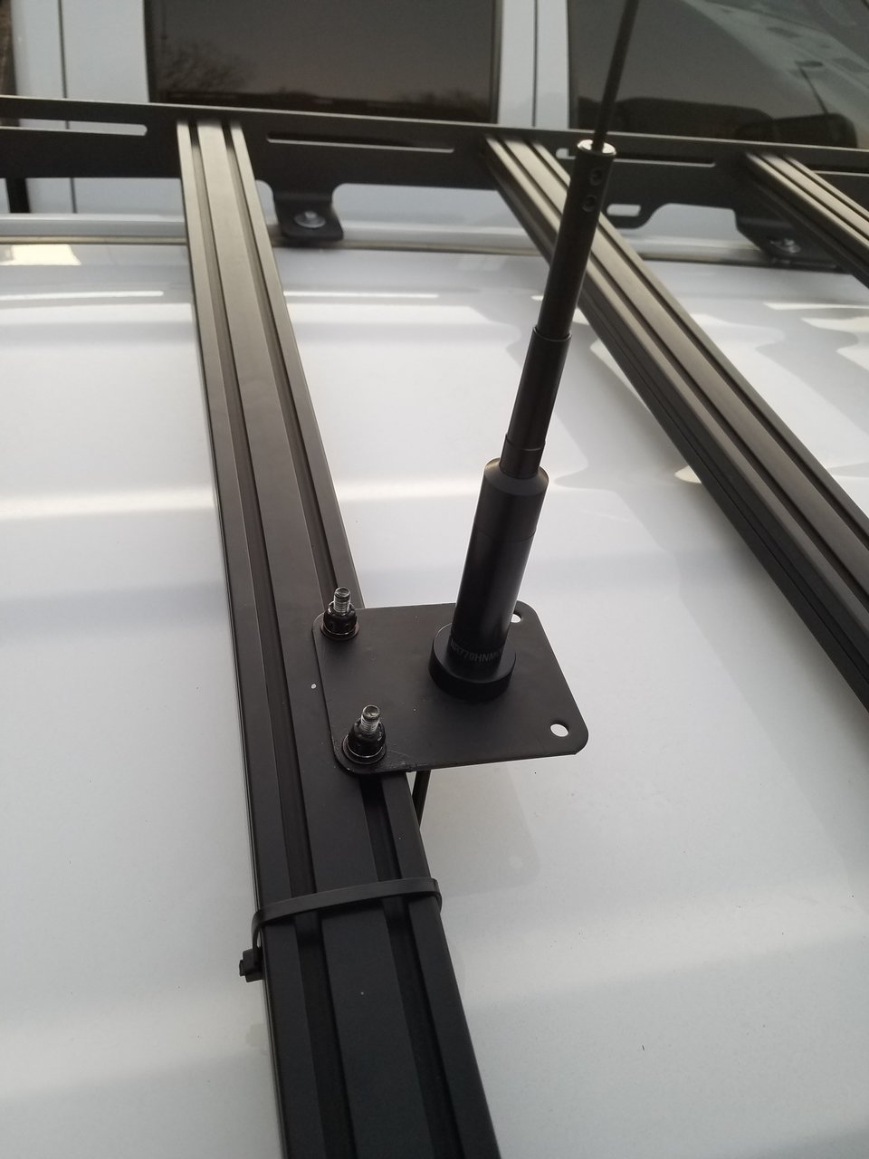

    Mag mount on the roof. Or jerry rig a NMO plate to your prinsu like me. I've got another project in the making that will use a similar plan as well.

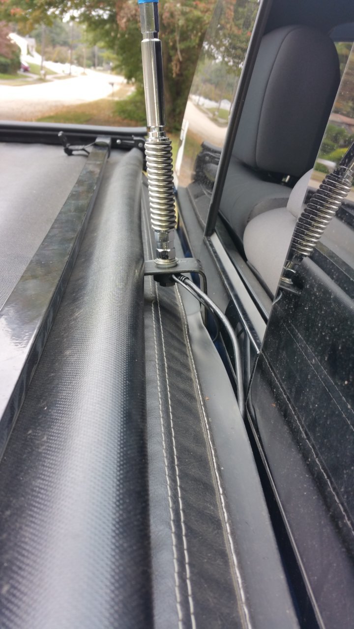

    I'm with @Doc's Rig Fab your own. I don't know much about the HAM antenna, but this is my bracket for my CB antenna. Works with my tonneau too. Go easy on my hammer and vise skills lol.

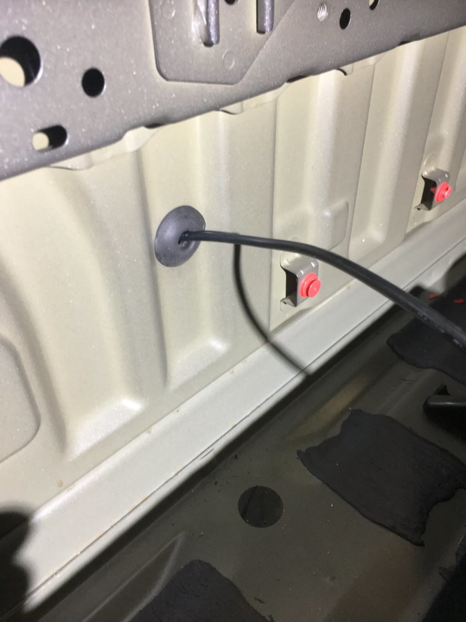

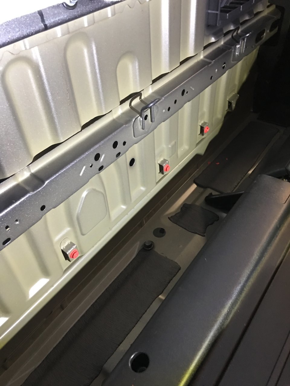

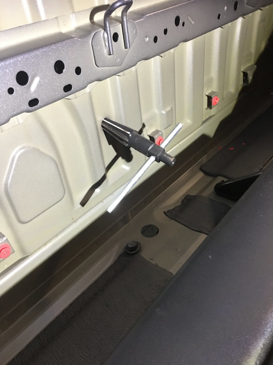

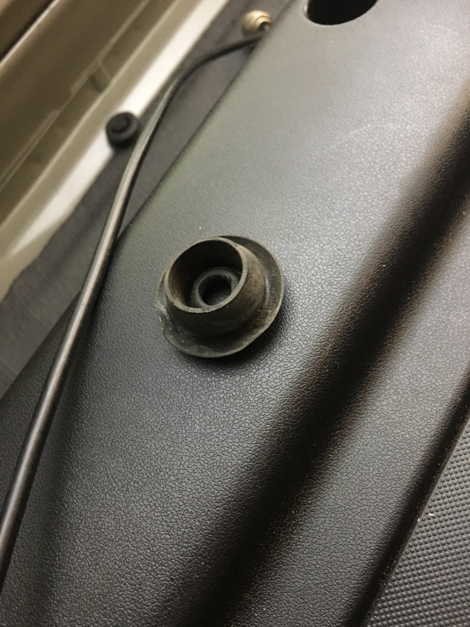

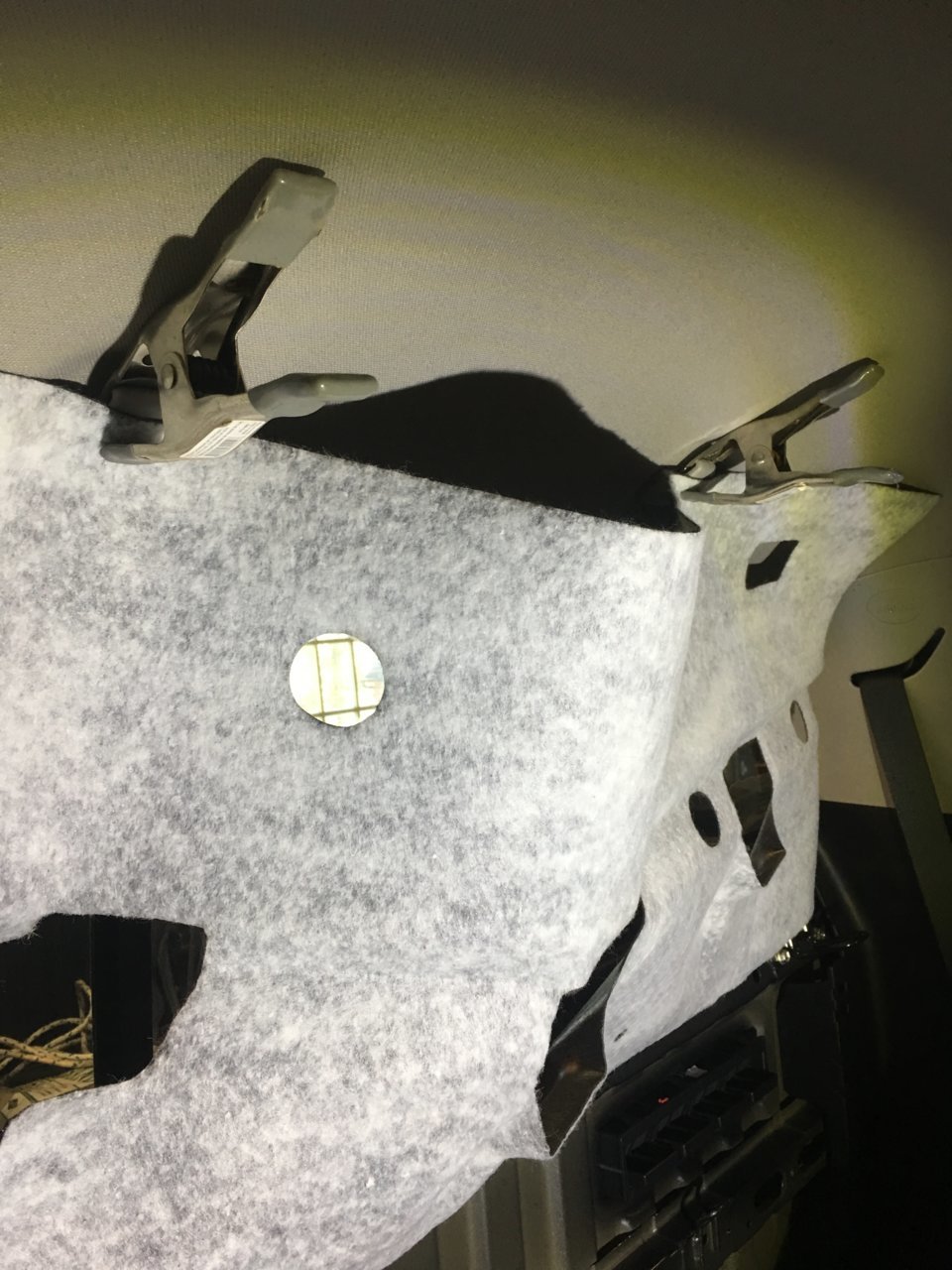

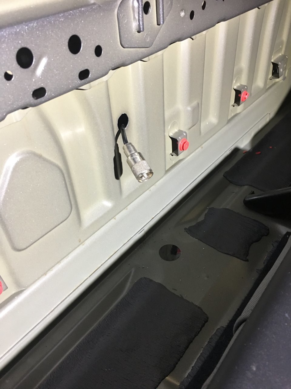

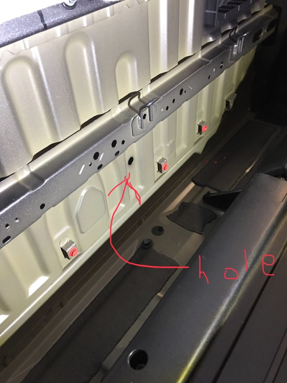

    Finally got around to routing my antenna coax in my 2018 DCSB today. I’m posting pics w explanations here so others can see what I did. Not that it was done correctly but it works well for me and seems like a good place for routing it if you want your antenna in the bed.
    First fold the seats down and remove the two-piece plastic covers behind the seats (there are three 10mm hex head screws on each side). Then it snaps out. Just remember that one side overlaps the other.
    Then I folded up the sound deadening fabric that was lining the back wall of the cab just to get it out of the way. Held it up by clamping it to the coat hangar thingies.
    The found the access hole (has a black plug). It’s in the middle.

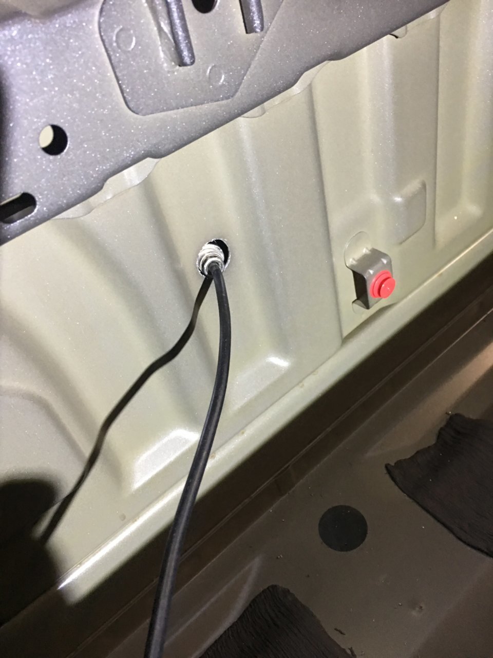

    The hole is a little too small for a PL-259 to fit through so I reamed it out just a bit.
    Once reamed out, the PL-259 fits right through.
    Added a grommet I had in the garage (I never throw anything away).
    Pull the PL-259 through the hole (easy access from underneath the truck)
    Add grommit

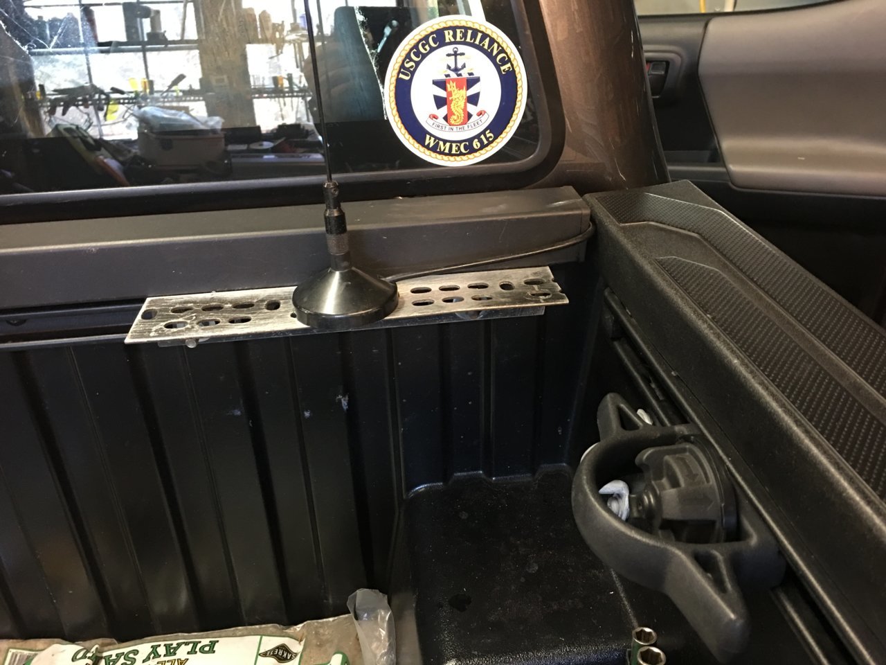

    For now, using a piece of scrap metal I had laying around as a base for a mag mount. It’s not too pretty but I’m hoping that it will work.
    Planning to change our the mag mount base for one of those corner braces.
    Have not yet had time to test it but will post results when I do. Open to suggestions if you have any. Thanks.

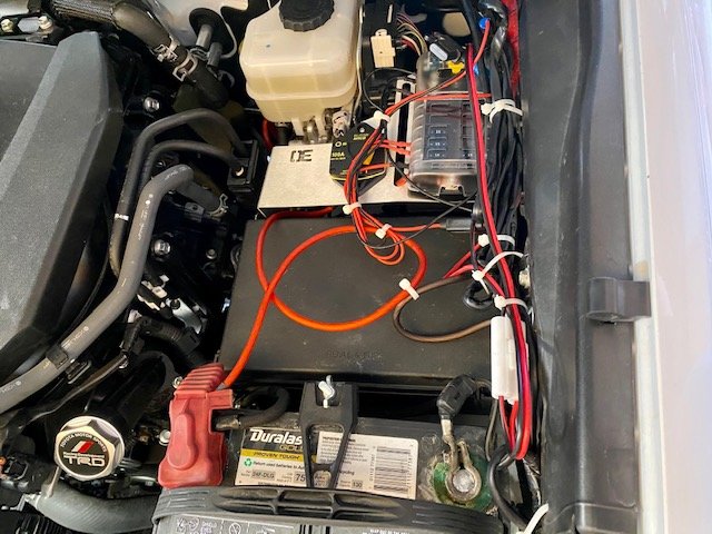

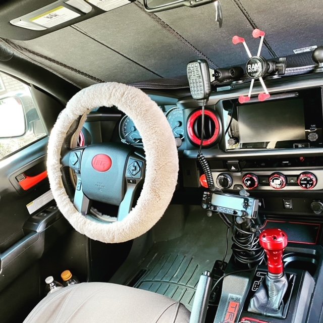

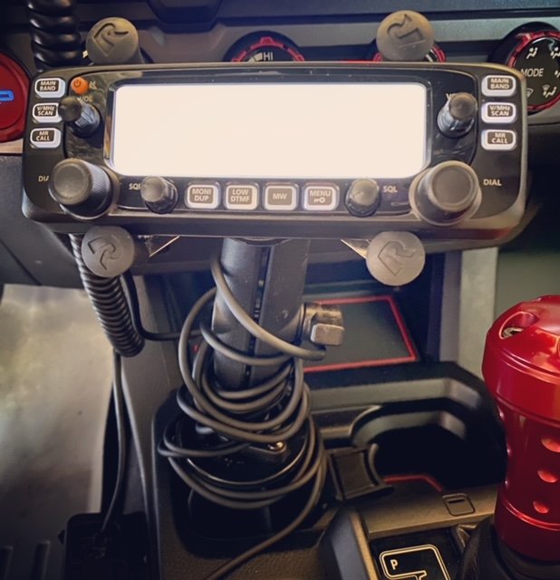

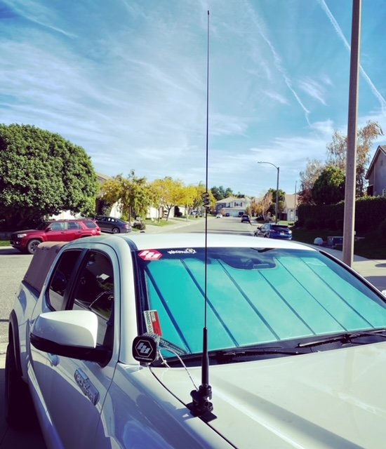

    It is perfect! I just added some dielectric grease to where I scraped the paint off for the NMO mount to the hood. I am hoping that keeps from rusting. I also added a Tram rubber grommet between the antenna base and the mount to make it watertight. It is all very solid where the radio is installed in the cab and the antenna to the mount/hood.
    I also had to figure out the power situation because I have a few sets of Baja Designs squad lights and now the 50W radio. I went with Overlandequipt and their mounting bracket, BlueSea breaker and fuse block. This was a complete set they sell with all the wires included. Now I only have one connection to the battery and everything else runs through the fuse block. It all works great no breaker trippin or fuse blowing so far! It is not
    sexy but it works well.
    The radio itself I mounted next to my right leg in the cab. I ran the power and coax around under the seat, along the door jam, and through the firewall. Of course this part was a pain in the ass as always! The firewall is evil for sure. I also mounted an external ICOM speaker on the passenger side.
    NOW the part you probably wanted to know the most and well done if you have read through all my blabbing. The ICOM IC-2730A works very well with the Comet SSB5 antenna. Keep in mind this antenna is somewhat a no ground plan antenna according to Comet's website. I have had about a dozen QSO's so far and each and every time the people I am talking to say the signal is very clear and sounds great! The radio does get a bit warm but not bad so I need to check SWR but I am not too worried about that. It is not like I am running HF. I even talked to a guy from Canada. He of course was using DMR but it was cool to be able to do that. All mounting is with various types of RAM mounts and on my dash is the ExpeditionEssentials rail system which I can connect my phone, handheld mic, and ipad for the Gaia maps.
    Again not pretty but it works very well! The only issue I have run into is with transmitting at night and having the aftermarket LED lights on. I was on a net a few nights ago and when I flipped on the headlights which have Beamtech LED lamps in them the RX would totally disappear. So I reinstalled the OEM halogen lamps and it works fine. So for what it is worth do not use cheapo LED bulbs in your lights because the HAM radio setup does not like it!
    I am taking a trip today up to Santa Barbara in SoCal and I will be using this radio to hit repeaters up the California coast and I plan to link into the Papa repeater system and possibly talk to someone in LA or San Diego. I will talk as must as I can but my gf will probably give me dirty looks. Today is out hangout day lol. So it looks to me like if you follow what I did or close to it you will have a system that works well! If you have any specific questions please feel free to hit me up. 73's for now.

    I'm Curious What the Coil of Wire is around the head unit mount in the cup holder?? is it the head unit (Extra Cable?) I'm almost sure you can get a Shorter cable from the Maker of the Radio??.. I've decided that I'm going to Still try the Rago Antenna Mount, I Cleaned the Paint off where the Bolts hold it attached to the bed, and Hooked a NMO antenna mount there.. and Found that I have a good ground, (Now I am going to Ground the Diamondback to the Bed, (A flat ground Cable to a Bed rail Screw and To the Clamps (Both sides)that Hold the Diamondback cover on Should do it... (I figured the worst that Can happen is my SWR's are through the Roof... in which Case i Will drill a 3/8 hole in the Center Piece of the cover And Attach the Antenna mount there (that should leave me a Great Ground plain.. (Always i Was shooting the breeze with a Guy up in Seattle the Other day (I'm in NY) Via a Repeater of course Via my Anytone 778uv (which I'm using as a base and Will be putting this one in the truck) as soon as my Yaseu ft 400 comes.. I'll let you know how the Antenna Mount Works.. (KD2VAH in case i catch you on the Band)

    That looks great on the DB cover! LOL I think you'll get a good enough ground plan with that.
    Yes the cable wrapped around the RAM mount base is the extra head unit cable. I will get around to purchasing a shorter one at some point. I know it kinda looks like hell right now. I was able to QSO a guy in San Diego from Above Santa Barbara today about 230 miles on the Papa analog repeater system. I've only used Fusion a few times but unfortunately not too many repeaters with that function out where I live. I need to get a hotspot so I can start chatting all over the country and the world.
