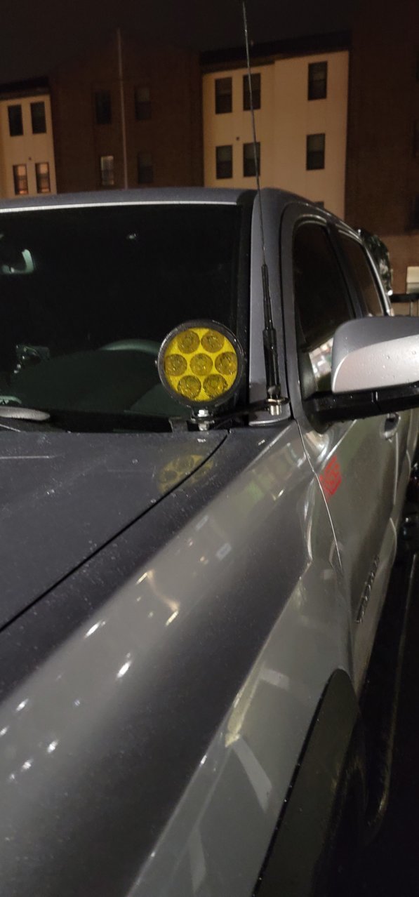

    Could always try one of these: upload_2020-12-20_22-48-53.jpg

    Ditch light bracket. Or just get some aluminum or steel bar stock. Drill a hole for whichever size mount you went to use and presto!

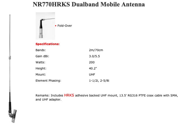

    great antenna!!

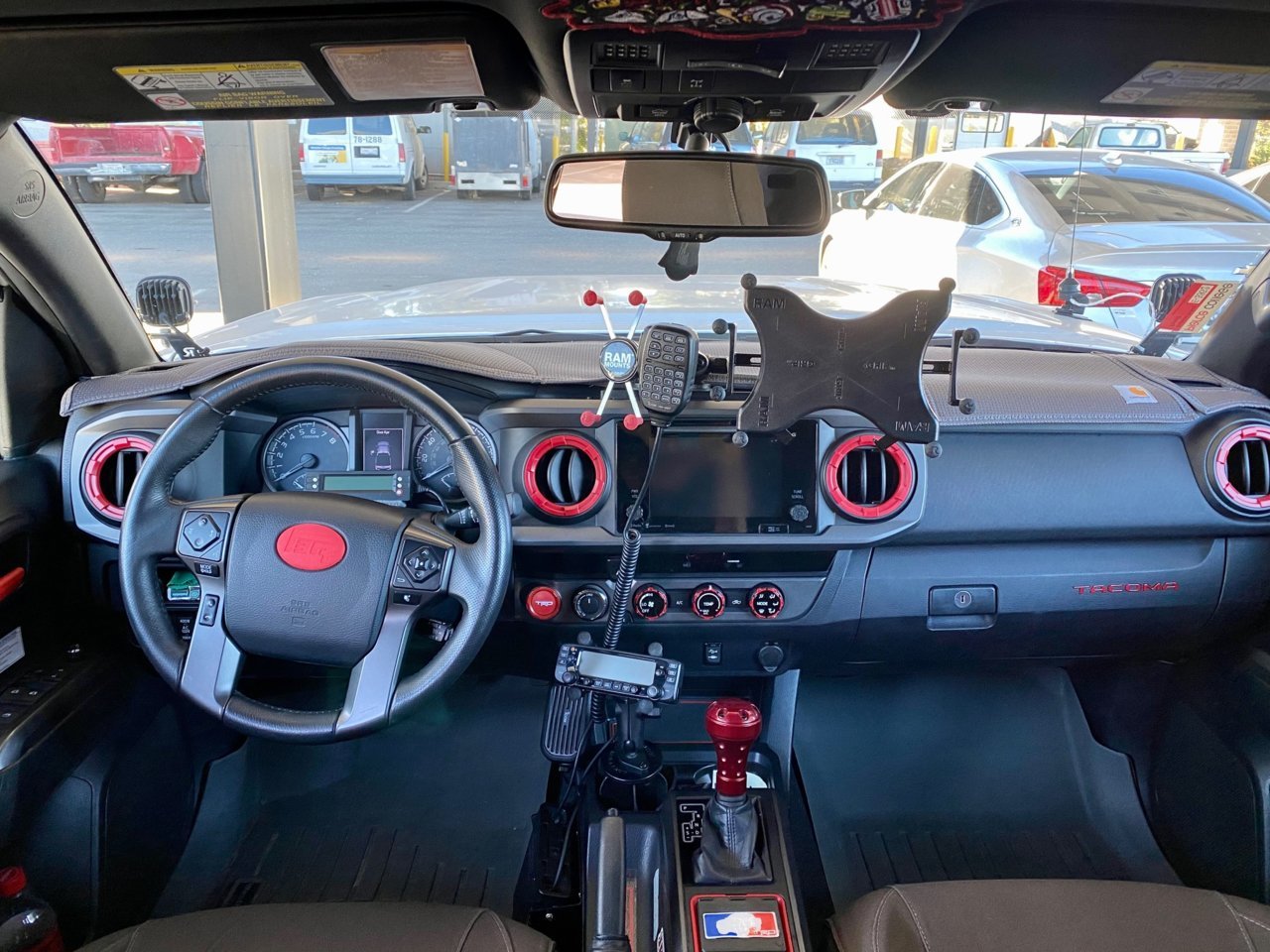

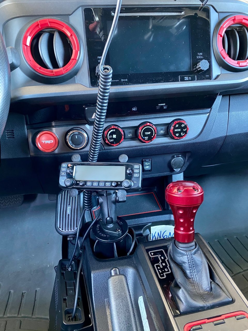

    Better

    Its a fine line between really cool and super nerd. Hahaha, you keep keeping on man, I love it!

    BAHAHA I must admit others have expressed the same sentiment.

    Hmm, who doesn't like red, RobMotive ain't got nothing on you.. :cheers:

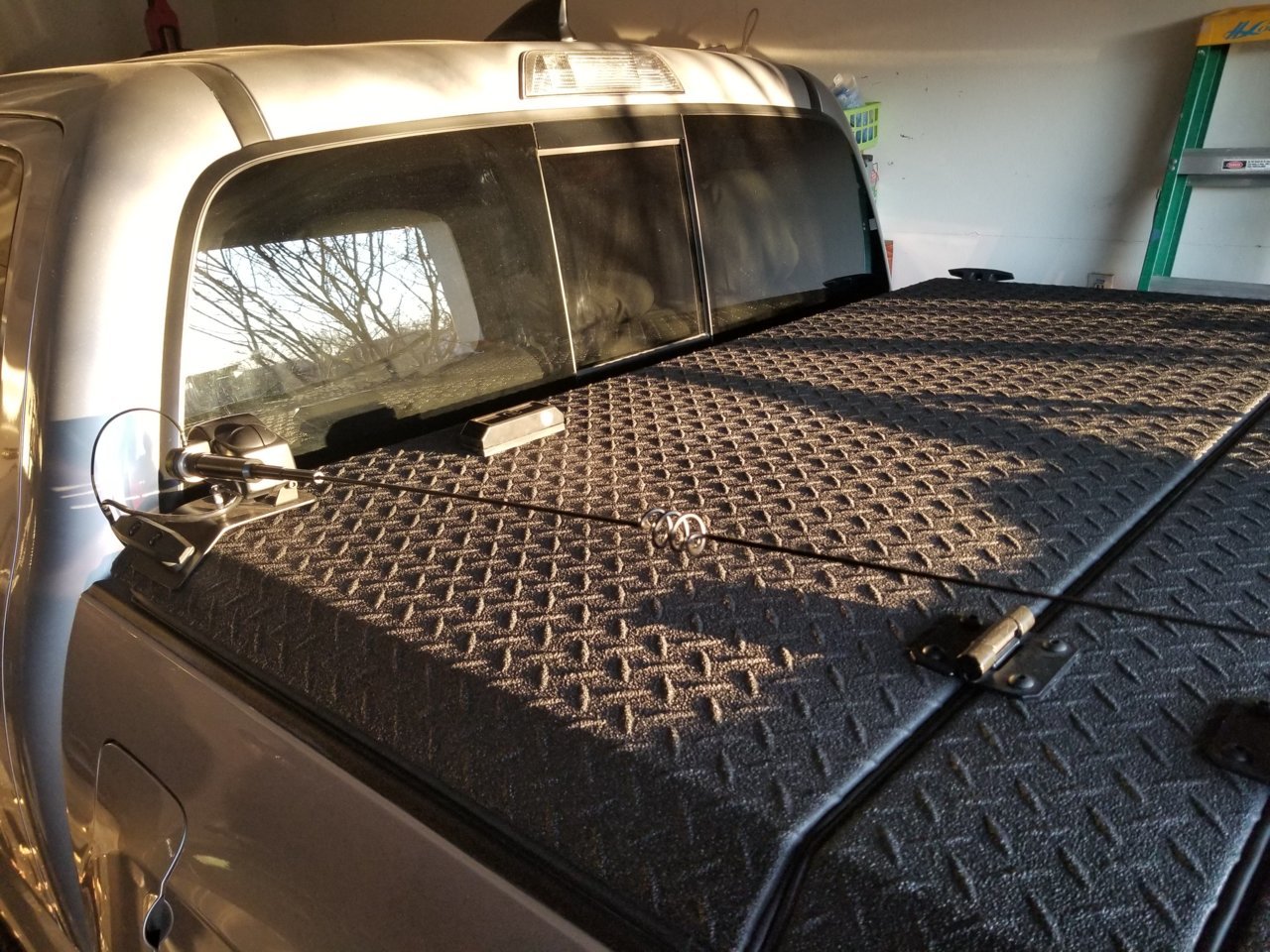

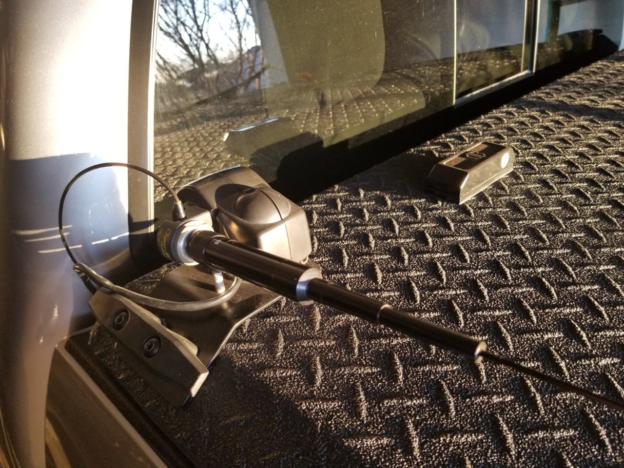

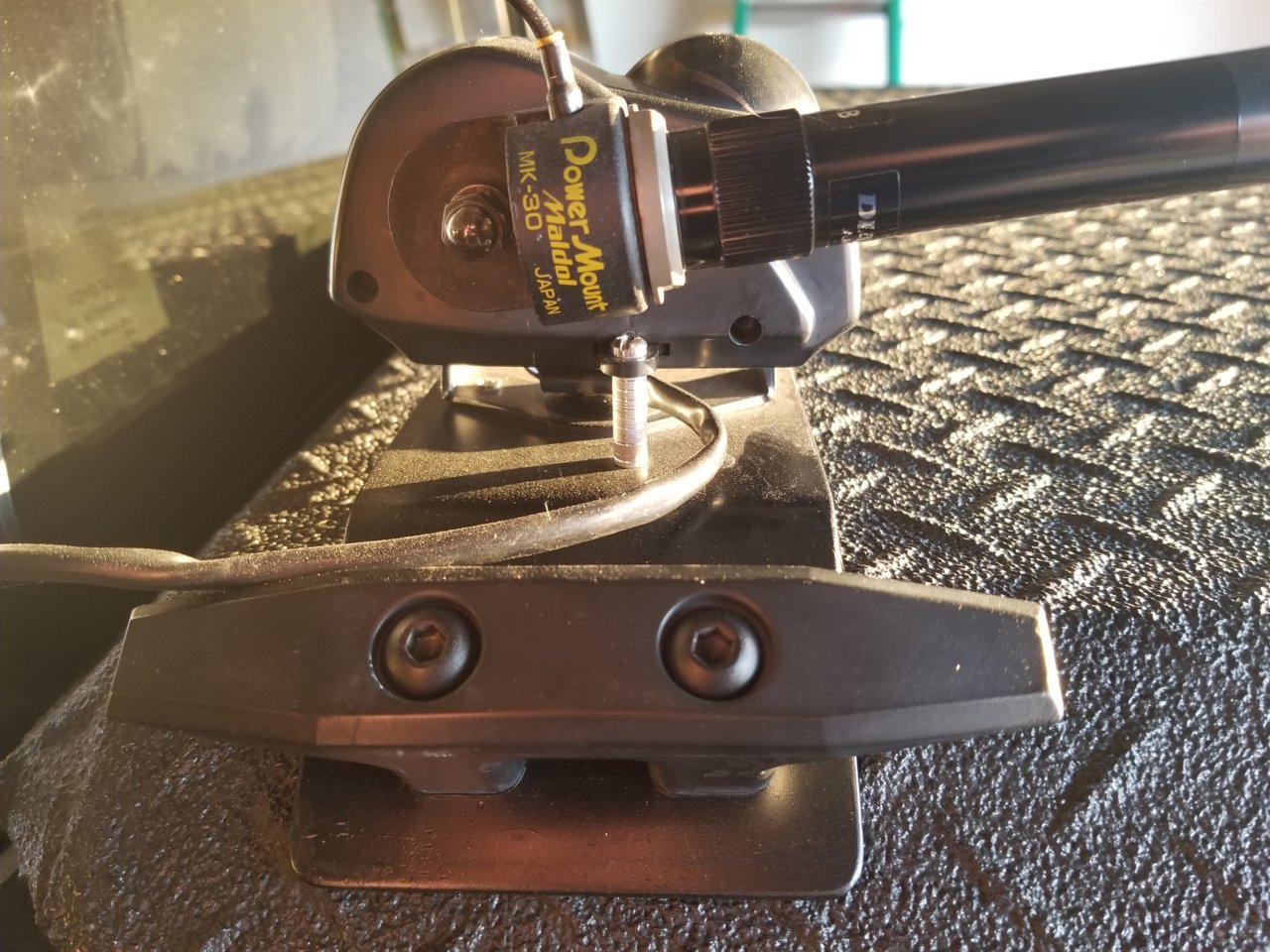

    This is my Diamond 2m/70cm antenna with an old, old motorized mount by Maldol, which I believe diamond eventually bought them out. I have it setup (still in preliminary stage) so I can raise the fwd cover and un-bolt the plate and chunk everything into the bed of the truck and lock the cover. I did that because I don't trust people they have tendency to just grab something spontaneously for no reason at all and then some just are plain jack wagons. Used the same bolts on the cleat with wing nuts underneath. Allows me into my garage painlessly, even if I forget to put it down no harm done.

    looks great and the ground plane will be a non issue!! well done!

    Thank you. Yes sir 1/2 wave on 2m, and 5/8 on 70cm.

    I like the 1/2 personally!

    Did you make that bracket yourself for the mount? Also how is this setup working for you?
