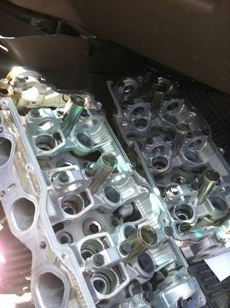

    just got my heads back from local machine shop, for what i paid i think it was a great job, super nice guys.

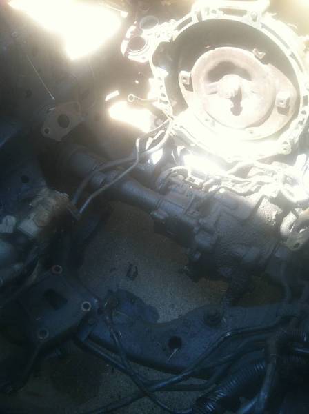

    started ripping into my transmission last night,
    this is how far i got in an hour, needed some large snapring plyers to get a snapring out so i had to stop. just thought i would post this. ive done alot of research on this trans and rebuilding it. and i said to myself why not? anyone done one?

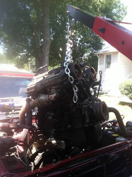

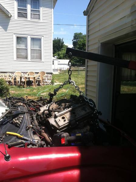

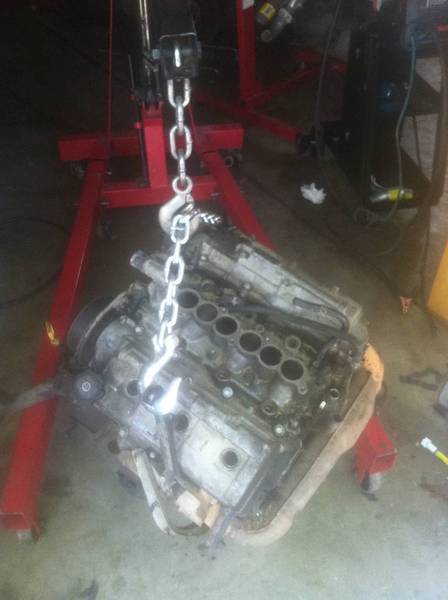

    this is where i have made it to as of last night and last weekend.
    Friday pulled my hood, grille, fan, air box, belts, (didnt have alot of daylight left after work)
    Saturday. pictures may not be in correct order
    thing was out and on the ground by 12:30 me and my buddy pulled it in about two and a half hours. not cutting stuff out.
    so after it was out, my Wife and I went to the zoo.

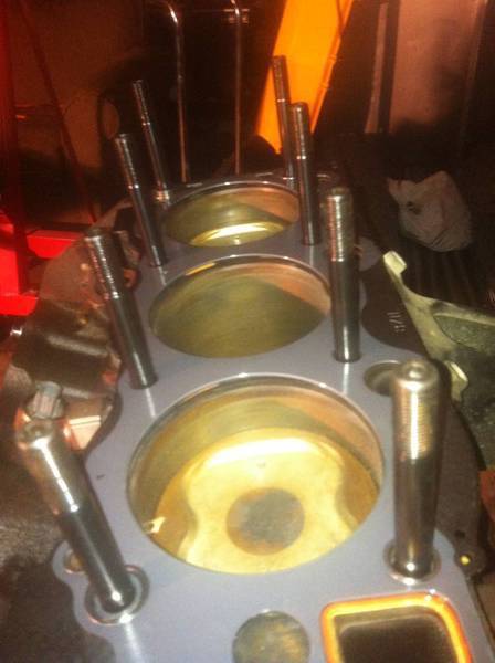

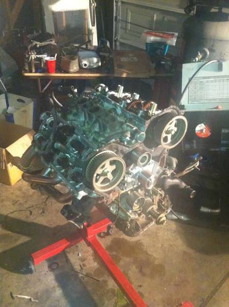

    then i put in some ARP head studs (from lcengineering) reguardless of what they say they do not fit under cam gears all studds were same length and had to get 4 OEM studs for under the cam gears.
    HOLY F SDFKJKASD its a long block now!
    Trd headers built and decked heads.
    port and polish.
    moarrr boost and moarr fuel
