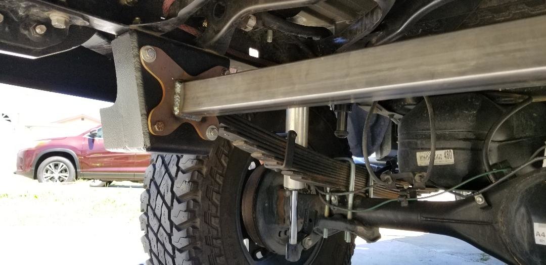

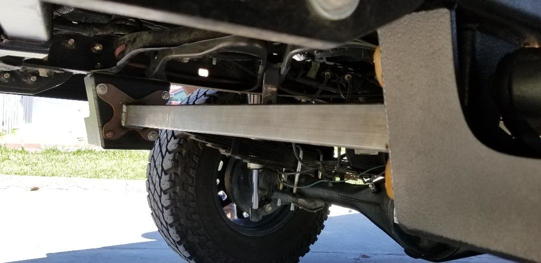

    I added the Beefy BAMF hangers and Shackles and i added a custom cross bar. I went a little different on the cross bar its square tube! I cant speak for the Hammer Hangers but the BAMF hangers are really nice i cant believe the ride improvement so stable thru corners. Havent gotten out in the dirt yet i have a front blown shock that needs a rebuild.
