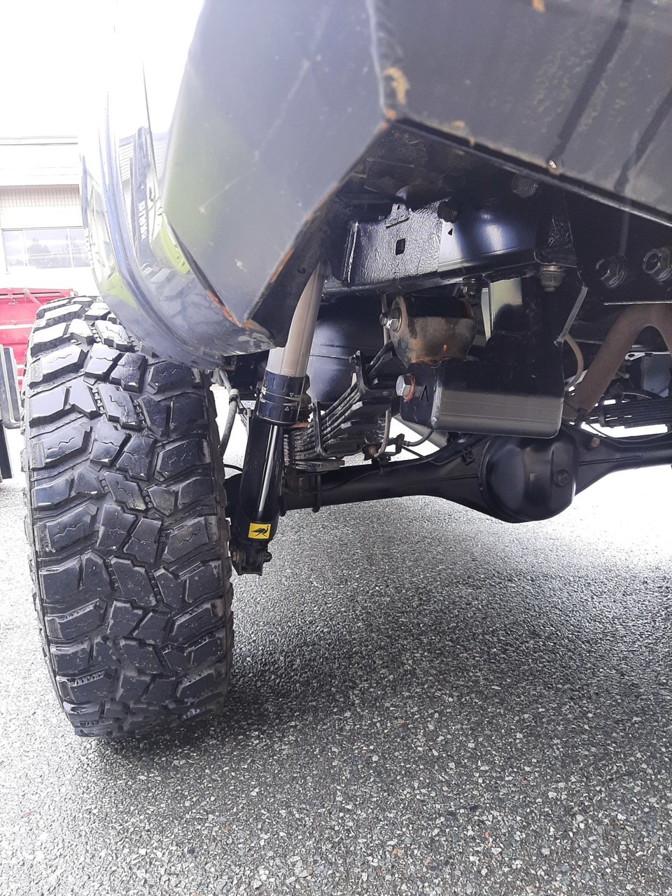

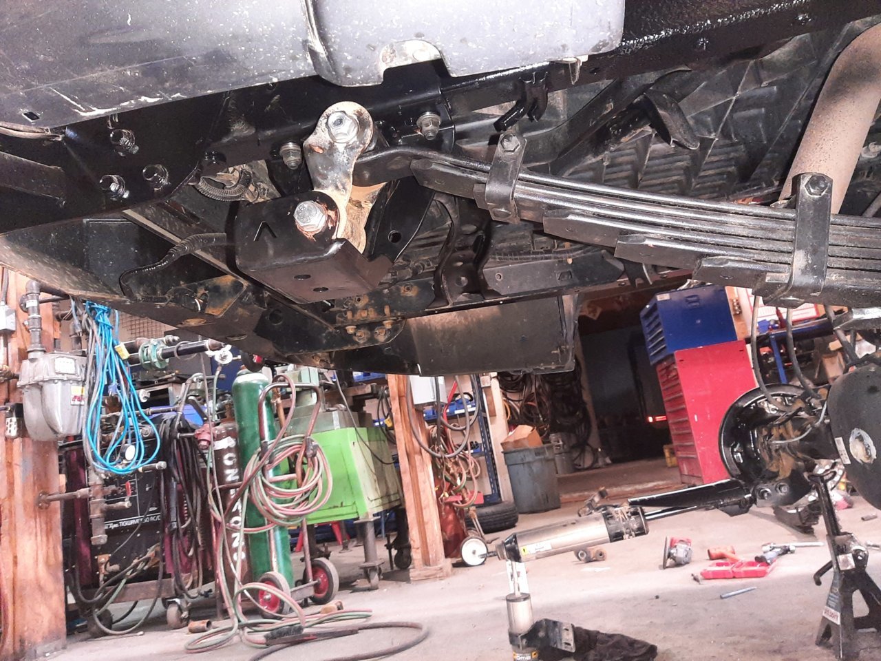

    Dobinson mrrs Deaver leafs archive garage hammer hangers.
    I have archive hangers and stock shackles, I do have there 3.6 shackles to go on just need to time do so
