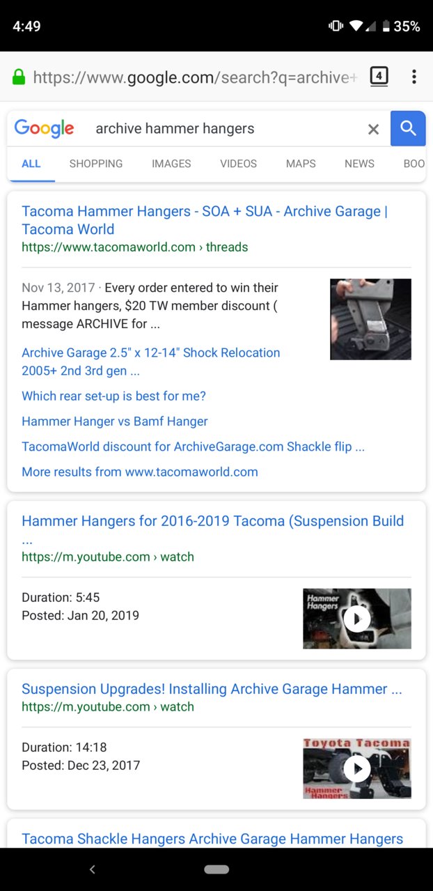

    first hit.. and TW is public...
    and for curiosity sake, I'd bet the visitor traffic for his site referral is dominantly TW.com, and yes, everyone head over and leave some reviews!

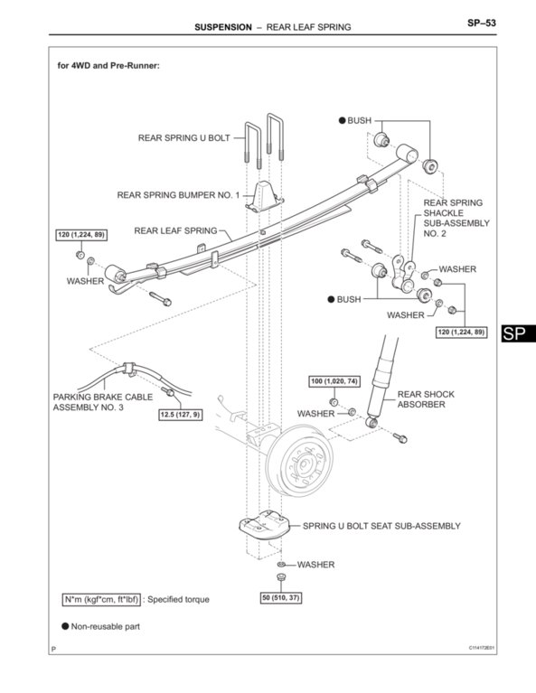

    Anyone got the torque spec for the shackles off the top of their head? I can't remember what I torqued them to last. Gonna be adding a leaf to my little dakar leafs tomorrow and will probably just remove the whole pack just to make it easier.
    I wanna say it was in the range of 50-60 ft-lbs right? I know they tend to bind if over-torqued.

    Shackle bolts? I tightened those things VERY tight. 3 Ugga dugga’s IIRC. Better to be nice and snug then a little loose.

    It’s either 85 or 89. Either way you’ll be fine

    89ft/lbs
    Rear leaf spring x Rear spring shackle sub-assembly No. 2 89
    Rear leaf spring x Frame 89
    Rear spring shackle sub-assembly No. 2 x Frame 89
    Rear shock absorber x Rear axle housing 74
    Rear shock absorber x Frame 15
    //rant: WHY YOU WRENCH WITH OUT SERVICE MANUAL!!?!?! :)

    Ahh there's the pretty diagram I was looking for. Damn, I was way off, glad I asked. And yes, I really do need to get a service manual, just so I have the info in one place. Thanks a bunch gents :hattip:
