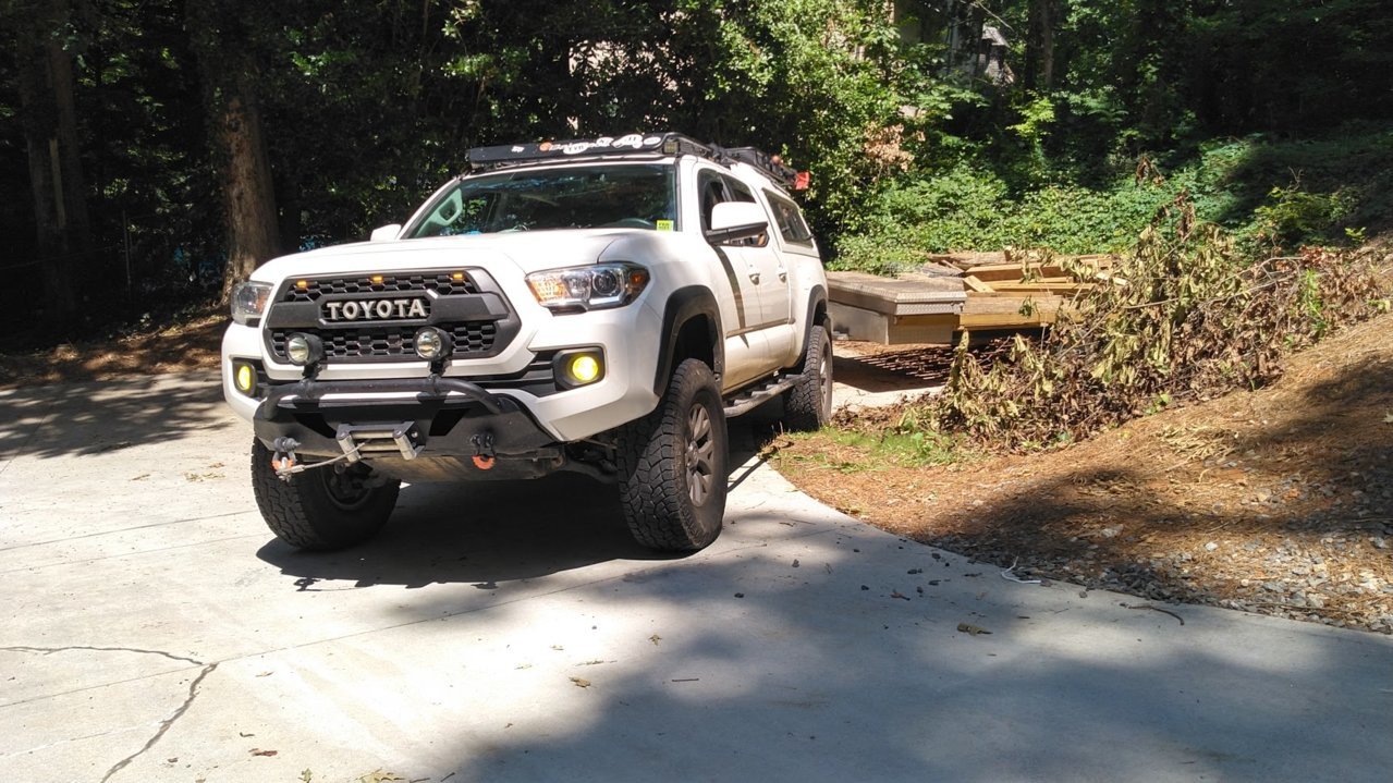

    It's big, white, and a bit ugly - just like the shark of the same name. It's built to tow / haul, hit mild trails, and be the family base camp for adventures. It's heavy, but capable, and we wouldn't have it any other way.
    Hope you enjoy the build and adventures.

    2017 Toyota Tacoma SR5 4x4, purchased new Tuesday, March 21 2017.
    Currently 62k miles (May 2021).
    The truck currently tips the scales at around 6k lbs loaded, so it's over GVWR. She's a big girl.

    I was tired of not having a roof rack over the camper. I use the one on the camper all the time for lumber, furniture, or anything else. I need it for an upcoming camping trip to tote a canoe too.
    The rack is a Bajarack Megamule - https://bajarack.com/products/the-megamule - The problem is, with the fairing and side rails, it sits about an inch too tall for my truck to fit in the garage. I decided I'd flip it to be upside down, that way the side rails are below the rack. To do so, I needed to remove the front fairing, so I took an angle grinder to it, chopping off the front fairing. I then mounted the rack back on the truck upside down. It works great and looks way lower profile now.
    I also needed to replace the two rear LED pods, the Nilight ones failed after 2 years of use. They were used literally daily (at least during the week) at the old house when I'd drop the eldest barbarian off at the bus stop on the way to work. Nilight has warranty'd them and is sending replacements, but I ordered new ones anyways that had a spot beam - these specifically. https://www.amazon.com/gp/product/B07KB56QG7
    Finally, I remounted the awning and moved the shovel back to the passenger side. The awning cover has been leaking, and the awning is a bit gross. I need to redo the cover over the awning and clean up the awning. It got dark, so no pictures yet.

    October 29 2020 - Tropical Storm Aftermath
    We got ran over by the aftermath of Hurricane Zeta. Starting at around 0400 on the 29th, gusts up to 70mph were hitting our area.
    The result was tons of downed trees, no power, and blocked roads all over Atlanta.
    We were very fortunate - no trees fell on anything we cared about in our yard, and only small branches fell on our roof, doing no harm. There was so much debris you couldn't even see the driveway:
    After spending 4 hours clearing debris from the roof and driveway, I packed up the Taco to go help out the city by clearing roads. I started with this 4-tree pile up that was a few doors down.
    It took 4 hours, there's a lot of shit in that pile. It was two oaks that fell together, and whacked off half a poplar. An innocent peach tree was caught in it all and was reduced to a nub. As of the time of posting - 2 Nov - half the road is still blocked and the city's still not cleared the rest. They're totally overwhelmed with bigger and worse messes. Here's an after shot from the other direction.
    It was a pain in the ass to finish because my winch engage lever got stuck. I tried spooling in, out, and trying to set the winch back to engage again - no luck. At this point, the line was fully spooled out.
    I decided to use the winch line anyways and dragged tree branches. This worked literally once until the winch line popped off the spool.
    In the end I used a snatch strap secured to a shackle on the front of my SOS streamline bumper and just dragged branches with the truck since they were too large for me to carry by hand. I had the truck in 4x4 on pavement to put down the power and traction needed to drag the bigger trunks - the largest pieces were around 2' in diameter and 30' long.
    When I got back, I fixed the winch line and was able to resecure it to the spool. I still couldn't get the winch to engage though, so I asked for some advise in the GA Taco owners BS thread: https://www.tacomaworld.com/threads/ga-tacoma-owners-bs-thread.17642/page-1260 and got some great advice from MAG GRY TACO15:
    He was 100% right, it had a bind that just needed freed. I was able to gently whack the lever with a hammer and it went into engage and spooled in the line just fine. I plan on just leaving the winch on engage and manually spooling out when needed instead of free spooling.
