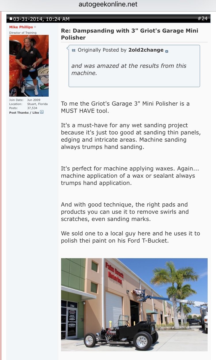

    As I suggested in another thread— if you are ONLY going to be laying down wax/sealant (or doing isolated corection work), the GG3 is a great tool. For polishing entire vehicles, using all-in-ones, cleaner waxes, etc. (or if you plan to do so in the future), then yeah the 6” is a better choice. Griots makes a great 3” backing plate specifically engineered for the GG6.
    I have both tools. They’re both great and have their pros and cons. I got the GG6 initially, but actually picked up the GG3 later per Mike’s recommendation solely for application of sealants. Paired with the Rupes 4” white pads, it’s a dream. Line up three cars in the driveway and I make very quick work of them.
    Regarding the GG3:
    “It’s perfect for machine applying waxes. Again, machine application of a wax or sealant always trumps hand application.”
