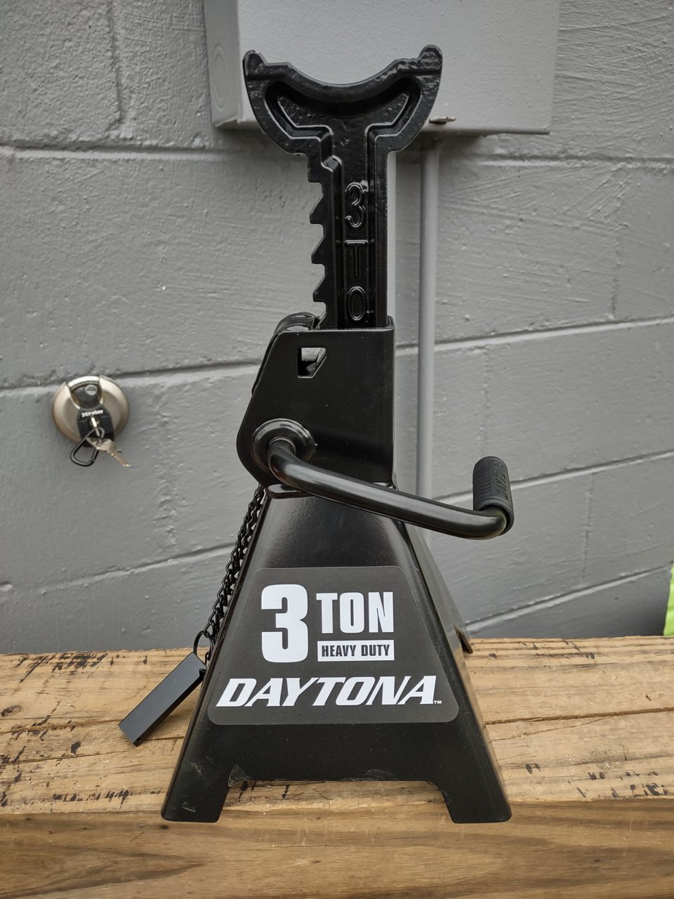

    Well, I decided to use the scrap 6"x 6" post I had...I'm gonna use them as safety chicks....And by the way, Harbor Frt has Black Friday on right now and they carry Daytona brand jack stands...Today for the insiders club , a set of 3 ton stands cost me 29 bucks and they are a better stand than the pair of Black Max I bought 2 days ago and am now returning....Hey MGM...I decided on spending 3 hours jacking and measuring to make these safety chocks and I figured, what the hell....Now between the stands, floor jack and 4 big hunks of lumber at the frame, I won't have to worry...And I was just about to cut them when I realized that the shudder while braking is most likely in the rear...Bearings are difficult to pinpoint in the same way...It was the ambient noise that threw me...Looked at the front yesterday and the discs and rotors are perfect...My calipers are shot tho....So today I checked the rear..First thing I did was check the tire play and both sides are rocking backwards and forward ( in a clock fashion ...About 11 to 2 ....Im pretty sure my idiot friend put my drive shaft in and although he marked it, he was f***** up as hell that night....Gonna try that first....80 bucks.
    It could be a much worse problem,I know...But the calipers are pushed back a few days...When you have never had this kind of problem, the possibilities are endless...I'll keep y'all up

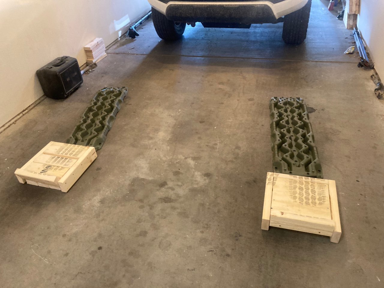

    ImprovisedRamp.jpg Extra4Inches.jpg If portability is less an issue and weight is not an issue ... buy a bunch of 2x4s, screw them together. If the weight of a Tacoma crushes a mostly-uninterrupted block of pine, things have changed drastically.
    My solution adding 4 inches to the 9.5 ...
