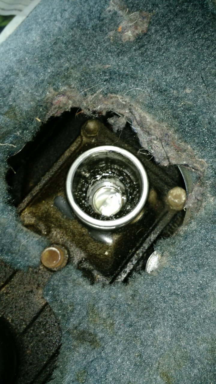

    Shifter seat is probably deteriorated like so:
    Head to your local dealer and grab a new one. $15 or so.
    ELMO67 and Superdave1.0 like this.

    And I also looked inside the shifter seat and to my surprize it was close to perfect and after market I’m sure
