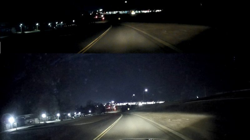

    worth noting that viofo has released a new g1w dubbed the G1W-S using a sony CMOS sensor that has significantly better night vision. I review it here:
    I compare my G1W-CB to the G1W-S, and its pretty much the same price on Amazon: https://www.amazon.com/VIOFO-G1W-S-Recording-Recorder-Capabilities/dp/B01MUSMZHQ
    You can see my comparison of the G1W-CB on top, G1W-S on bottom:
    IronPeak and shakerhood like this.
