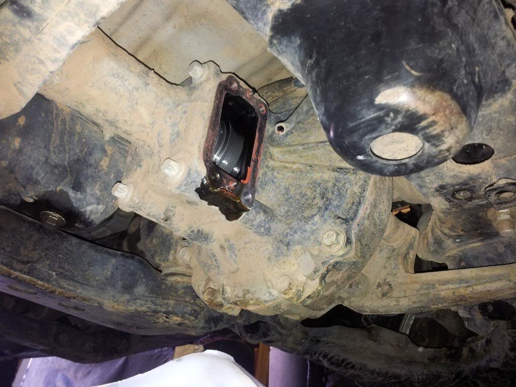

    I 100% percent absolutely garentee you it does not have a vacuum add in it. I'll put my truck title on it.
    Now there is a breather hose that comes off of it so maybe he mistook that for a vacuum hose
    I have rebuilt 3 2nd gen add actuators now by tearing them apart and resold ring the motor wires
    allenfab[OP] likes this.

    Spencer and I hooked up the breather hose. I have a crappy memory so my recall is suspect, but I'm pretty sure Spencer's truck had and electrical and a vacuum connection on the ADD actuator because I remember being surprised that it had something as old skool as a vacuum line connected to it.

    Pretty certain it utilizes both electric and vacuum components. I know it wasn't the breather that I was messing with.

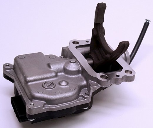

    I rebuilt the unit on my 06, my 09, and now my 12. I am very well versed in what is there and how they operate. I can tell you what pin does what on the electrical connector.
    There is only one part number for add actuator for all 2nd gens. So unless he somehow custom retrofitted a vacuum system then his was electric

    Is this vacuum or just a vent hose?

    That's a breather hose in all of the pictures posted
  9. Apr 29, 2017 at 6:44 AM
    #209
    gainman
    gainman Semper Fi
    Oct 23, 2008
    #10185
    3,541
    SW Florida
    2012 TRD Sport Supercharged Manual
    Stuff
    That breather hose goes to a clamp on top of the Diff, then up into engine bay from there. There is also a breather hose from the Diff itself. They run up together

    I'll concede that it could very well be a breather. It doesn't look like it goes to anything like an actuator now that I've gotten a better view of it, so that's pretty good evidence that it's a breather. :thumbsup:
    And many thanks to you for providing some great photo documentation to help us resolve this disagreement, haha. :D

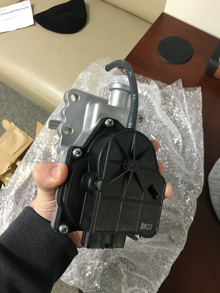

    Yea this front add this is a stupid little bastard part...
    even after getting a new one, modding it to fix the issues like the points and gasket and tabs, I already have gotten the random blinky light a couple times.

    End of the year I'm doing FJ case swap and front tube and I'm yanking the 4wd computer right out. Worst thing they could have put in this truck
    Edit: the reason I have so much experience with the 4wd system is mine is constantly breaking wtf
