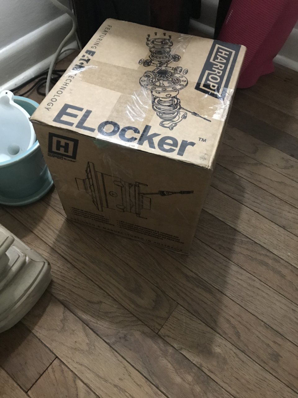

    IMG_1572.jpg Came back from florida last night and this was waiting for me:

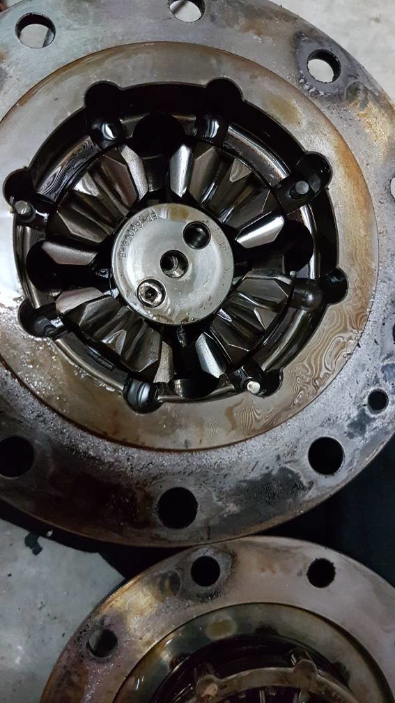

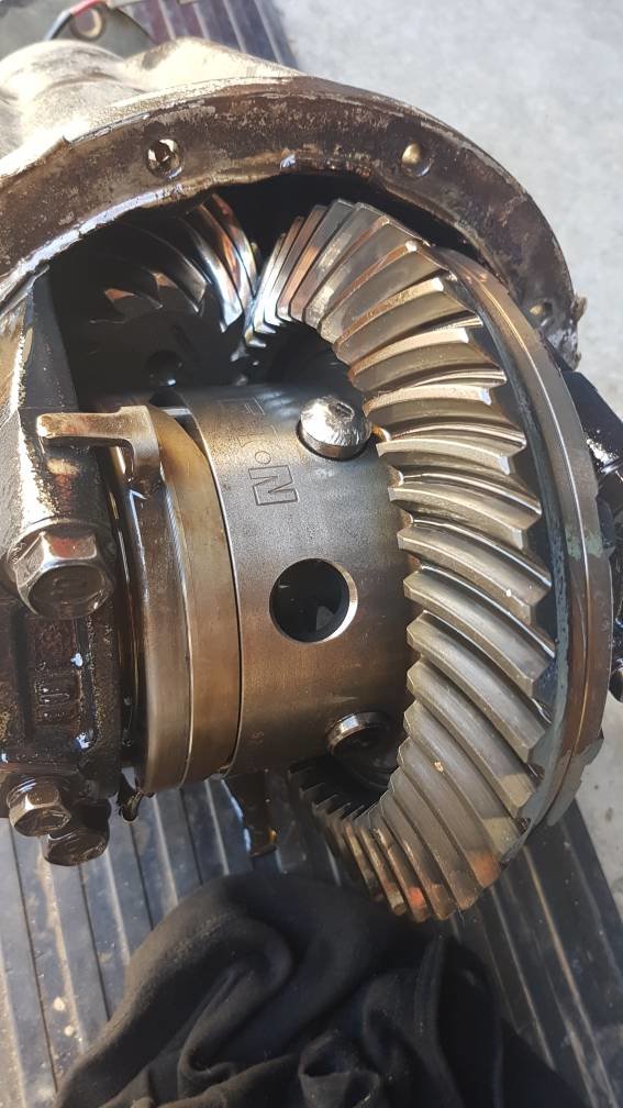

    Thanks for sharing. Can you take it apart and post pics? Is it material or design that is failing?

    It's uncertain what the cause is but the retaining screws on the pinion shafts come loose. It may be that the axles rub on the retaining screws as no thread locking compound seems to solve this problem.

    Would be interesting to get my hands on one. It does look like rubbing when you zoom in. Is it possible the axles have slight movement in and out and rub up against it at critical moments. As for the retaining screws, maybe a reverse thread to prevent from walking out and trim the ends of the axle shafts and/or reduce the thickness of the plate it is rubbing on to include a different shoulder height on the screw?? Or am I completely off the mark?
