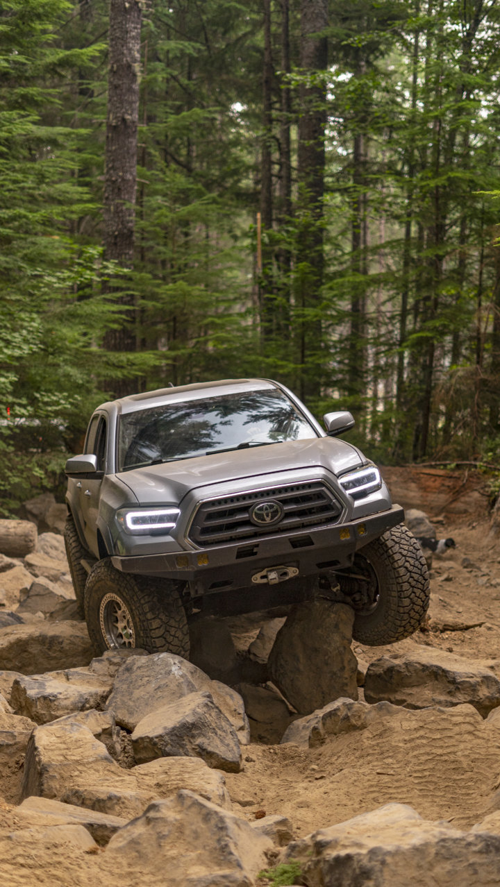

    Update.
    Did some snow wheeling at 10,000ft.
    Broke fresh tracks, at night.
    Lockers were the bomb.
    Don’t leave home without them. Lol

    Where did you go for snow wheeling?

    Outside of Bishop.

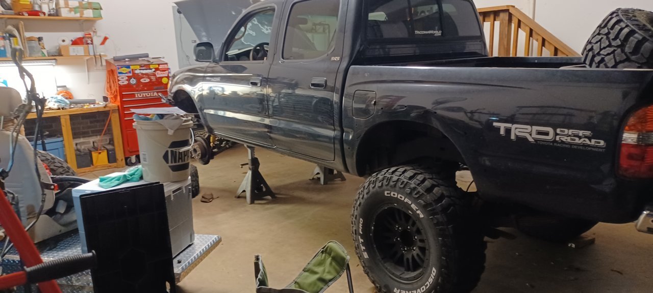

    Quick question. Had ecgs build my front diff with a harrop for my 4x4 conversion. Got it mounted yesterday and also did my harness. Everything went smooth. No axles in it yet. When I went to test the switch, power on, light on, I hear nothing from the locker to indicate it's locked/unlocked.
    I mean dead silence, no clicks, no whispers, nothing. Did I make a mistake somewhere?

    Probably not. Mine is also dead silent, I have videos of it in action. You can hear me hitting the rocker switch in the cab and then you can literally see the locker working on an obstacle. You can also test on a gravel surface while turning

    I don't have any axles in it, no trans/t-case, no spindles. Just checking the locker.

    Well throw some axles in it & test it! Mine is very quiet so that’s not abnormal.

    Good to know. Can't get any axles in it atm. Still have my 2wd spindles on. Its my winter project.

    You won't here anything like that. How it works: https://www.tacomaworld.com/threads/harrop-e-locker.649606/page-2#post-24455068

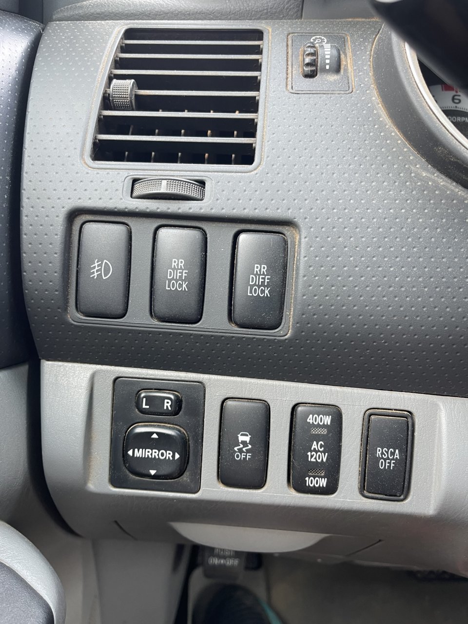

    Are able to use the factory wiring harness and dash locker button after swapping lockers? Does anyone make a wiring harness adapter?

    Possible? Yes.
    How it was done? No idea, ask Pablo. 4FF4781D-BA93-47E1-8B08-55489D044B01.jpg

    Okay, might have him wire it up.
