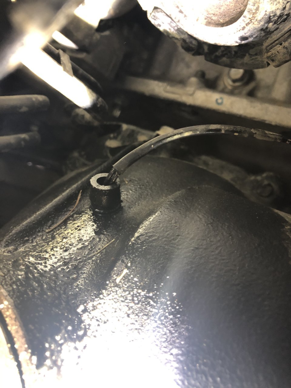

    Update on my Harrop on my 3rd gen. I Noticed The front Clam leaking oil yesterday. Did some clean up and re checking today and looks like it’s leaking from the rubber wire grommet. Looks like it wasn’t properly sealed up enough and came loose and pushed back down. Cleaned it up and siliconed it as best I could from the outside.
    Really Hoping this fixes it as I’m not looking forward to pulling it and sending it back to the shop if it doesn’t...

    So it may be a good idea to seal the outside with RTV to make sure the grommet doesn’t slip back in?

    i think so. I cleaned mine very well with purple power degreaser then 50/50 ipa alcohol/water Solution and let dry. Applied permatex and so far I’ve done one test drive on it it hasn’t leaked. I went ahead and did the rear too just for safe measure. Wouldn’t hurt if you did it before they went in.
    when I emailed Chase at ECGS he Said this is the first one he’s seen leak. He made it seem like it’s kinda a crappy design. I’d have to agree somewhat, but It seems like more rtv upon initial install of the plug inside AND out of the grommet would be the ultimate proper solution.

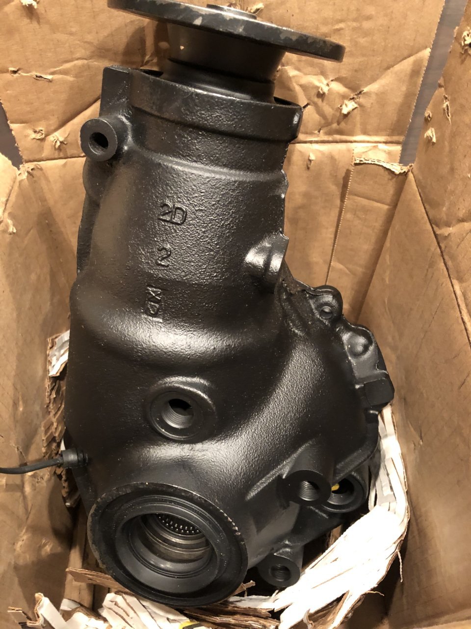

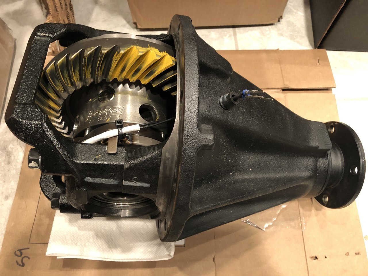

    The 9th can’t get here soon enough. 4.56 gears with Harrops :bananadance:
    30F1FE36-0B60-4470-BA50-8524740A9BC9.jpg 60589C7E-8FF6-49C5-A81C-CB3BF658C368.jpg
    Naveronski, DJB1 and hoarder23 like this.
