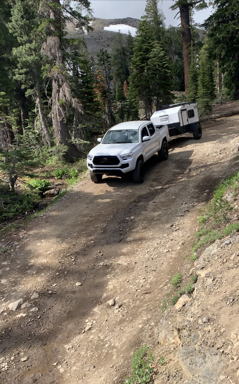

    Finally tested the Eaton/Harrop locker up in the Sierras. Paired with 4.88s it was unstoppable, even while dragging a trailer. The engagement is far better over my 2007’s Toyota locker.

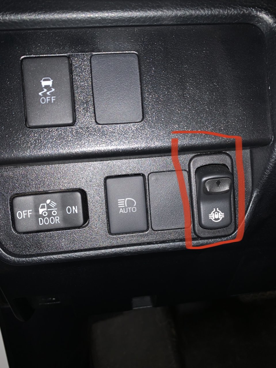

    Can anybody give me some guidance on installing the locker switches?
    That's not my forte and I can't seem to find anything informative enough.
    Thanks!
  14. Aug 1, 2021 at 8:34 PM
    #174
    FloTaco
    FloTaco Well-Known Member
    Oct 31, 2013
    #115610
    591
    Bay Area, CA
    2021 SR DC 4X4
    The supplied wire harness is fairly straight forward, the fuse box is under the driver side dash, a good grounding location for the switch is the brake pedal bracket to the steel firewall. One of the long dummy switches will pop out of the dash on the left and the opening will require a small amount of careful dremelling to fit the Eaton/Harrop switch. The wires to the rear axle should be mounted straight down the driver fender, along the top of the frame rail, and across to the rear cross member just forward of the spare tire. Run this down to the axle, leaving about 8” of extra service loop for articulation and rear suspension travel to avoid ripping the wires out of the rear diff. The engine bay has two holes on the driver side fender perfect for a small piece of 90 degree aluminum bracket (home depot). Drill holes in the aluminum angle to to mount the relay and manual breaker reset. Red wire to battery positive, black to fender ground. E locker switch wires routed through the rubber firewall grommet. The fuse tap that says IGN doesn’t actually have to go into the ignition fuse position, it can go in the unfilled slot marked USB. The fuse box cover will not fit back on once the fuse tap is in place, toss it in your center console.
    THE HARD PART: the two wires coming out of your rear diff need to be gently pulled through the connector with needle nose pliers, then silicone the bottom of the connector where the two wires enter and DON’T touch it again until the silicone dries, do not try to connect the main harness until the silicone dries over night. The two wire blades seem to back out when you connect the main harness which keeps the locker from engaging; the silicone keeps them from backing out.

  15. Aug 1, 2021 at 8:45 PM
    #175
    MSN88longbed
    MSN88longbed Sporty Shorty
    Nov 22, 2016
    #203106
    692
    John
    Goleta, CA
    2014 Single Cab 4x4, Auto, Blinding White
    Kings all around, Method 306, Cooper STT Pro 265 75/R16, JBL amp, Morel Speakers, Undercover tonneau, Alcan leafs, SOS sliders, RCI skids, SSO Slimline, Engo winch.
    Thank you for the info.
    The main harness was installed and tested when we did the third members. I just need to do switches and wiring into the engine compartment.
    Are you talking about the upper set of switch blanks or the lower?
    I have 2 to install and I already used that grommet for my power amp. I'm considering moving it to the passenger side.
  16. Aug 1, 2021 at 8:48 PM
    #176
    FloTaco
    Oct 31, 2013
    #115610
    591
    Bay Area, CA
    2021 SR DC 4X4
    I just read your profile and realized which truck you have. I have a 2021 SR (picture below) but my old 2nd gen also had upper and lower blanks. Either will work.
    MSN88longbed likes this.
