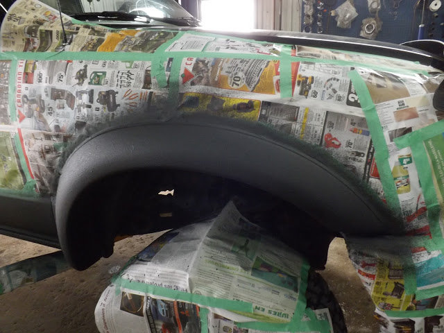

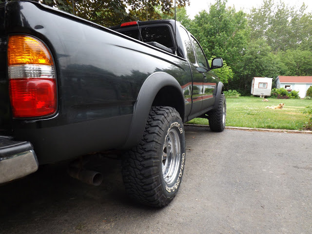

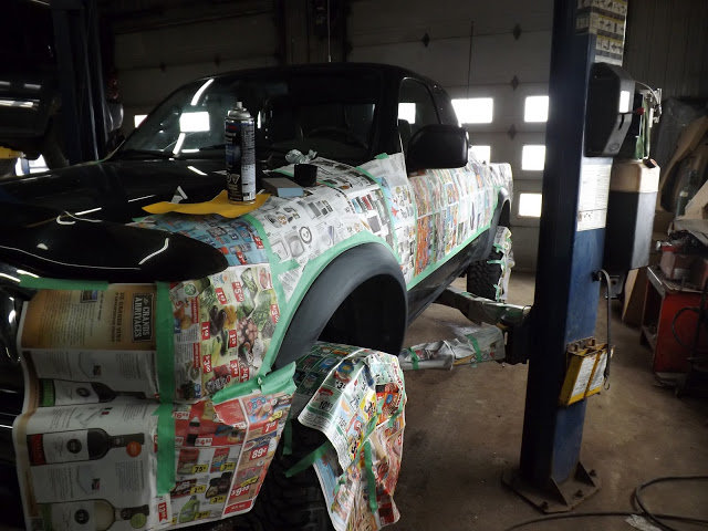

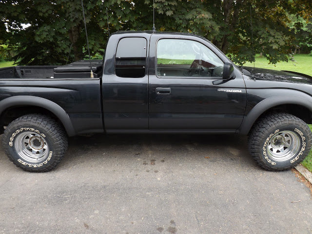

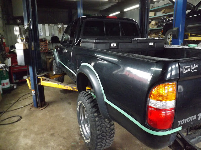

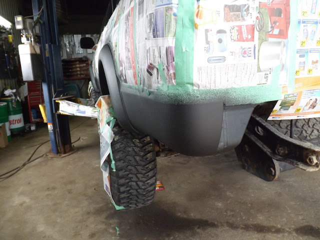

    did mine today:cool:

    What kind of spray did you use ^

    i used proguard gravlguard, i used 2 cans@ 12$ a can, so thats pretty cheap imo

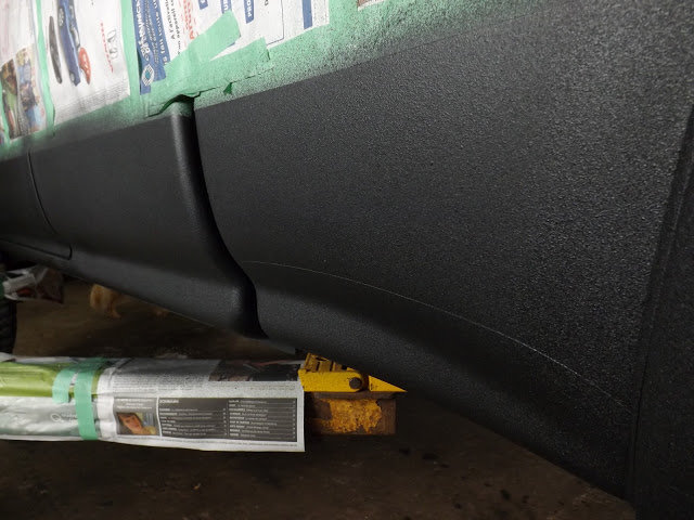

    I ordered it online from a company in state and had it nxt day, it comes with the spray gun so all you need is an air compressor, & if you get the tintable kind like i did youll have to mix paint into it but it doesnt take much and took all of 10 minutes to spray one side. So far its holding up fine, still only about a week old but i really like the texture and finish..and the texture is adjustable as well.

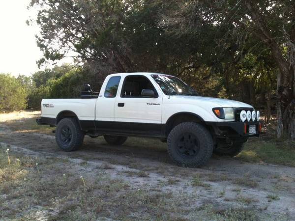

    I'm really liking the look of this particular product and how it turned out, from the pictures, can anyone tell me what product this is? Looks like there is a can of it sittin on top of the hood...

    yes ive seen it on an other member truck, cant think of who it was,and its badass! but i cant convince myself to do it :p
    the rookie mistake i did was to not put a clearcoat over it or paint cause the dirt just stays there no matter how i wash it...

    I did using rustoleum bedliner, took about a day to do.
    Prep-
    Washed the truck
    Used a degreaseer (alcohol)
    Two different grit sand papers on the paint
    Primered it with rustoleum proffesional primer grey
    Scratched the primer with sandpaper
    Bedlinered three coats of rustoleum as its not as gritty as some bedliners. Turned out incredable and im extremely happy with it. One of the best things ive done to it!
    Used the lines on the truck that stop door dings to make the straight line. Like to see some other people on here that have done the same!
