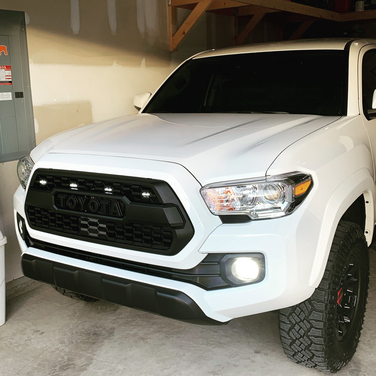

    I got the Auxbeam F16 H11s. They fit into the low, hi, and fog assemblies.
