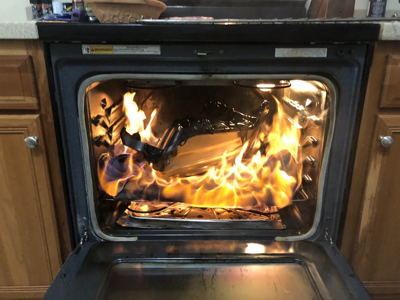

    I do appliance repair, i know a thing or two about ovens.
    1 setting the oven to 300, or any temp for that matter, does not make the oven go to 300 and stay. They typically go at least 50 degrees above the set point on preheat. It takes 15 min for them to settle down.
    After the preheat, they still do not maintain a temp. They average it. It will cycle up and down above and below the set point.
    All ovens vary. Some go plus and minus 50 degrees, some 25 degrees. Gas is faster than electric ,both up and down. Gas is more direct heat to part than electric.
    If you lay a towel on the rack, and it covers the whole rack, you insulate the lower section which will not be good. Don't do that. (See fire pictures above)
    As previously posted, heat it up, turn it off, then put them in. Do not bake them with the oven on.
