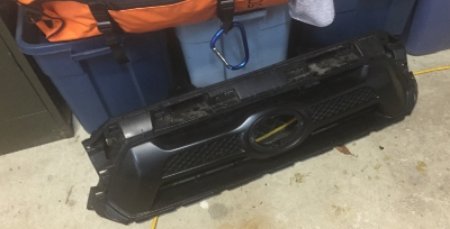

    they are held together with about 15-20 plastic clip tabs that lock into place on each other and about 8-10 torx screws. there is a video, i think homer tacos 2012+ ghost grill install, has a clear view of how the two separate. Separating them apart takes care and fiddling. putting them back together is a snap
    one more thing. there is a rubber seal thats on top of the grill insert that seals the hood to the grill surround. this strip needs to be removed and transferred to the inner grill.

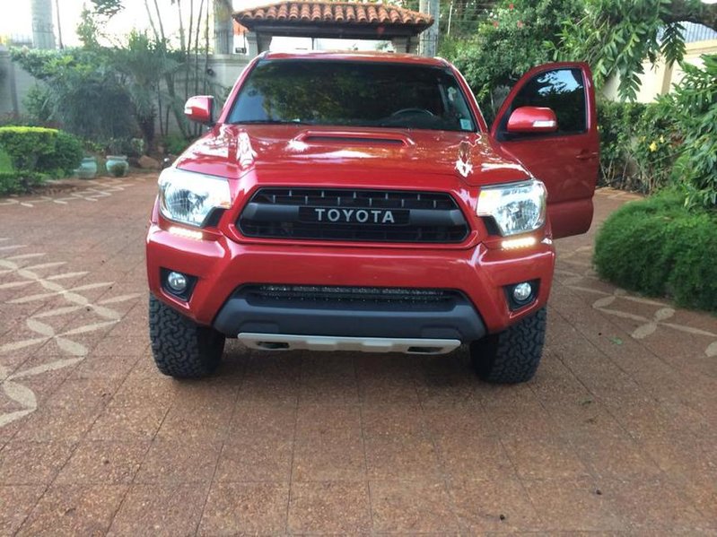

    MY TACOMA 2013 DOUBLE CAB WITH TRD PRO GRILL AND DRL LED :rolleyes:

    Looking good!! I like the 4runner Pro wheels too! If I had a Sport I'd go the same way.

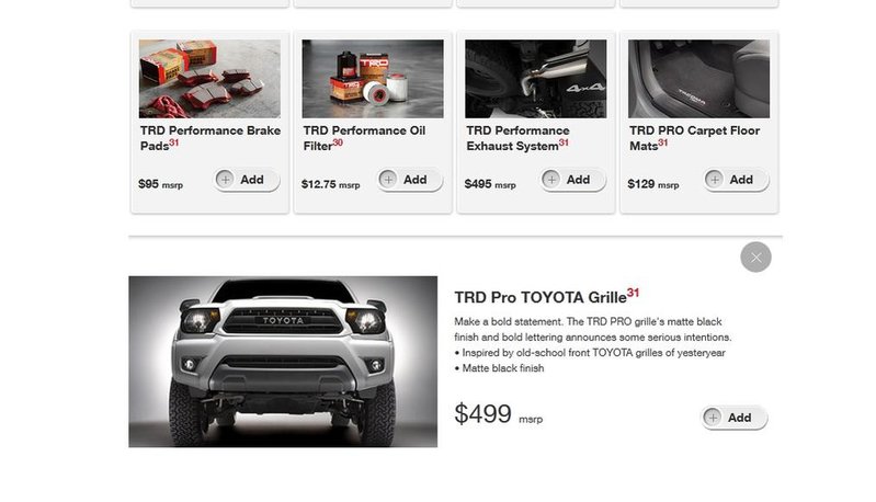

    $500 is crazy. According to the parts department at my local dealership, list price on that part is ~$250. So if you have a wholesale account with the parts department at your dealership and they aren't a bunch of assholes, that makes the grille obtainable at about $200 after the 20% wholesale discount. I'm going to try and order mine tomorrow if my work schedule permits. I'll validate whether or not what the parts department told me is true once I have the grille in hand.

    I don't why the MSRP is 300ish for the tundra Pro grill but 499 for the taco...
    Haven't really seen a new tundras grill up close, are they smaller/less complicated?
