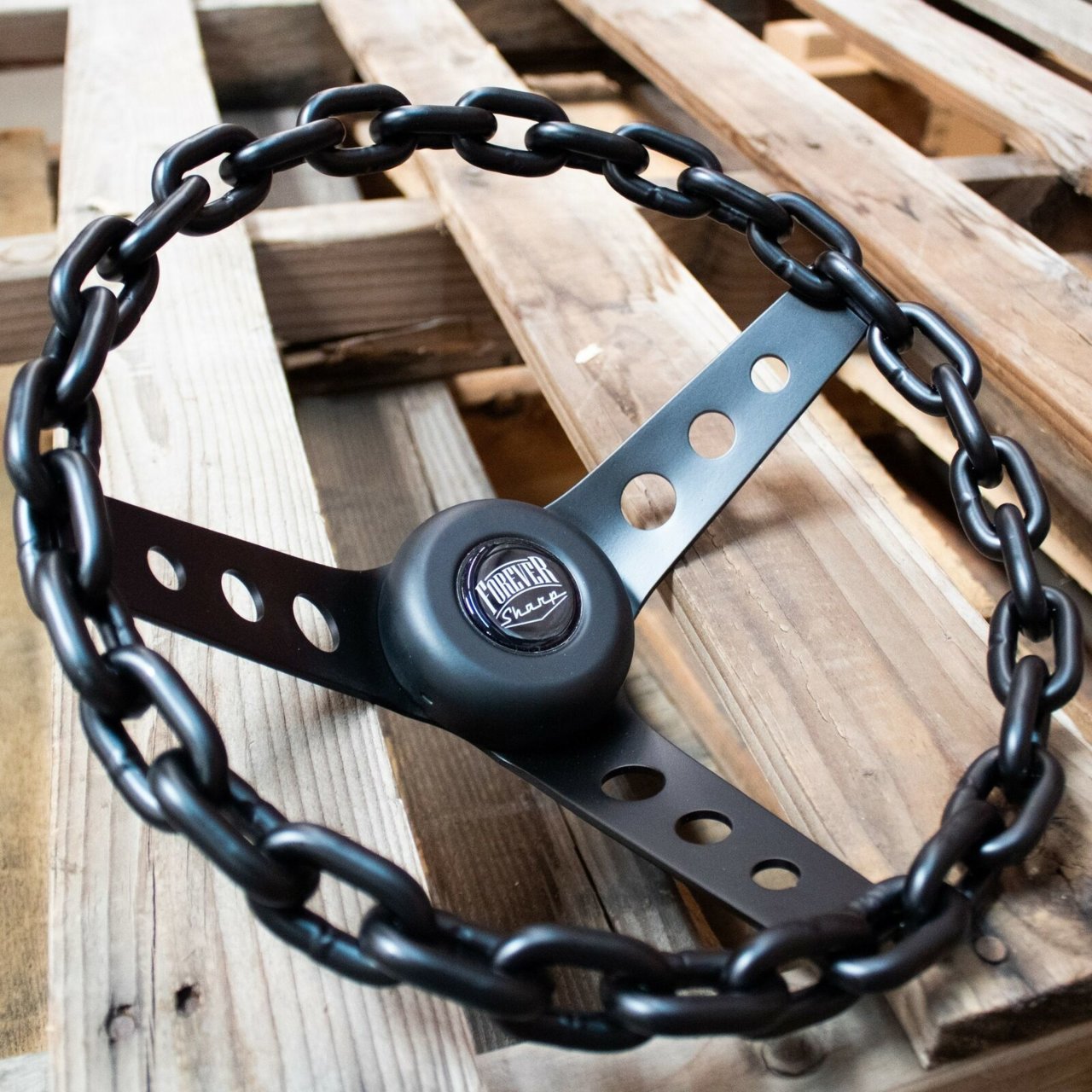

    Easiest way to solve the entire problem. My life insurance is pretty decent so...

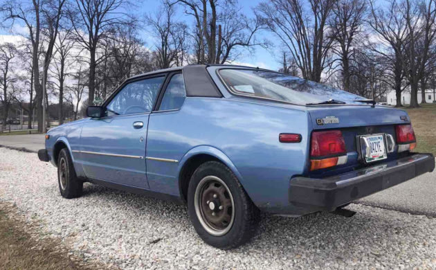

    Yep. I had a 1979 Datsun (remember those?) 310, front wheel drive, manual transmission. Bought it new. I thought I would get used to 1st gear being forward position on the shift lever, and pulling the lever back to shift into 2nd. Nope.. Never did happen. In 1982 I bought a brand new Mazda RX7, and was never so happy to get rid of my 3 year old Datsun 310. :kona:
    This is a 1981, but same color and looks almost like mine did...

    Sweet Datsun. Man what I’d give to have a ‘72 Datsun 510 coupe. Had a chance back before they became super popular to get one for $3500. Clean and straight with original interior. Wife shut me down.
